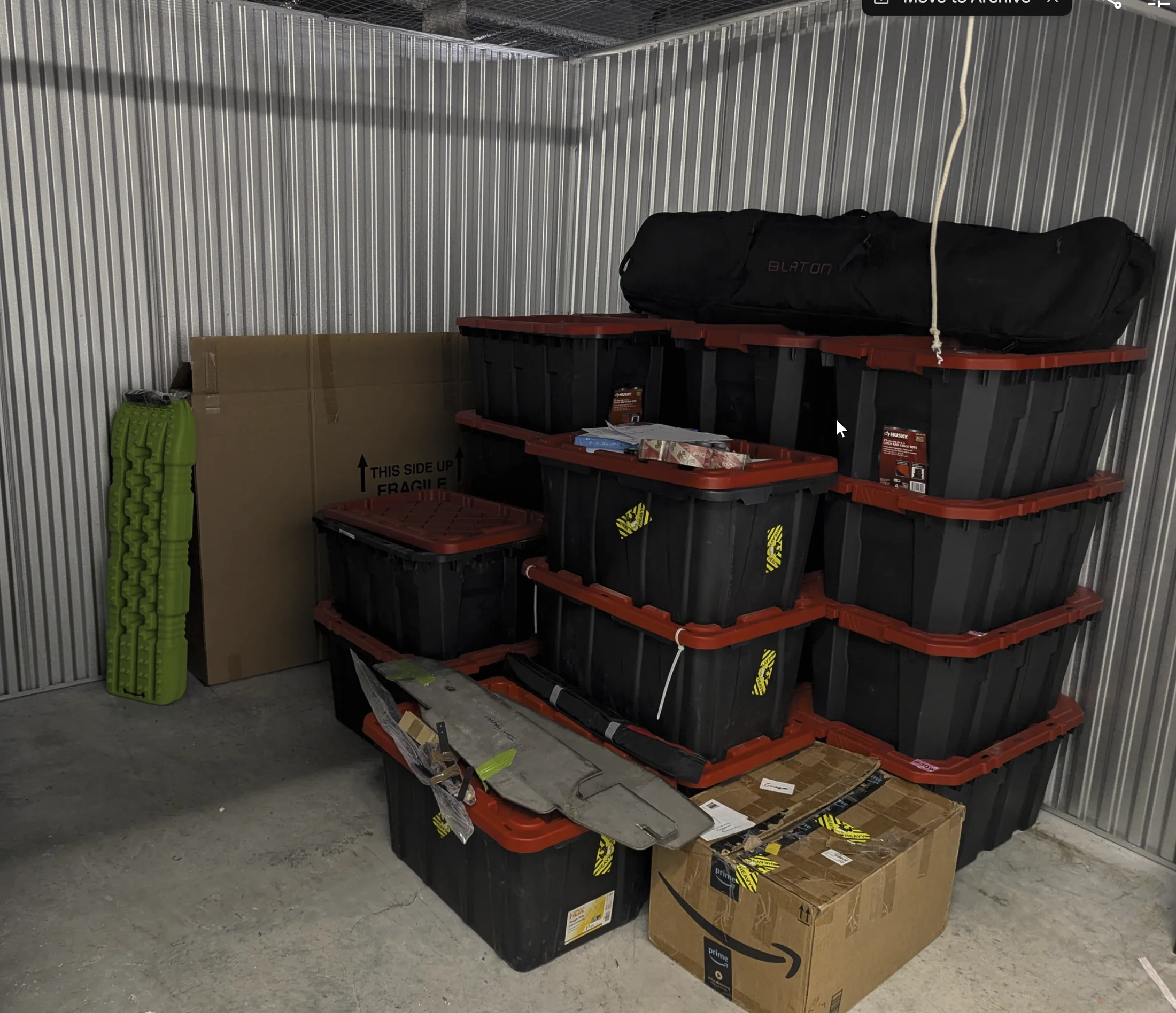

I spent some time this morning organizing my storage unit and taking inventory of the size and weight of the stuff in it. All of the stuff weighed in at a little over 900 lbs. I'm guessing that the stuff pictured, plus the stuff in my condo, should easily fit in a 7x14 trailer. Correct, the Bud Built cat guards don't do much good when sitting in storage.
