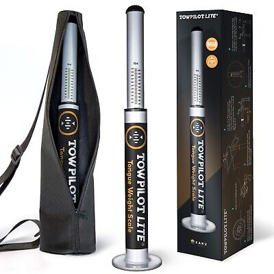

This is pretty accurate as police can use this to find vehicles over GVM (with tongue weight being a factor). I've never heard of it in the US, but they could if they wanted to.
Wow, that TowPilot scale breaks all the laws of RVing! Simple, packable and cheap? That’s blasphemy! It would pay for itself in no time if you were a “weigh your rig” kind of guy. The convenience of not going to commercial scales and trying to calculate tongue weight, hitching and unhitching with the same stuff in the truck breaks all the rules of RVing.
Although I do disagree with freedom guy about the towing details I am glad that I read the post and I applaud him for actually answering the OP.
