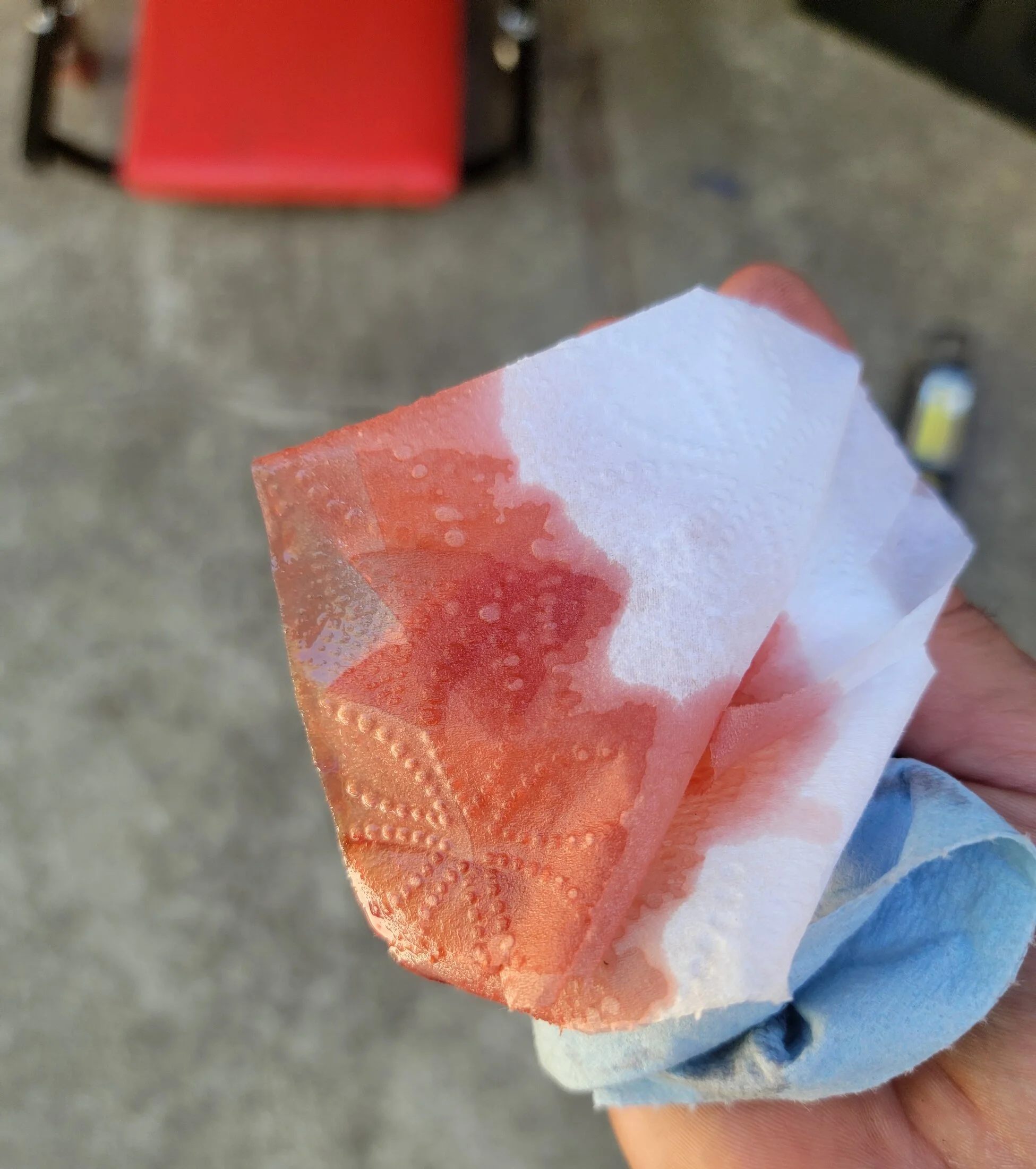

Also we are all curious what newer/low mileage fluid looks like at this <30k interval. I dont think anyone here has notated this on their 200 with anything remotely close to your mileage.
My experience is that after doing the full exchange the subsequent drain and fills look just about as good as new at 30k. Here is mine.

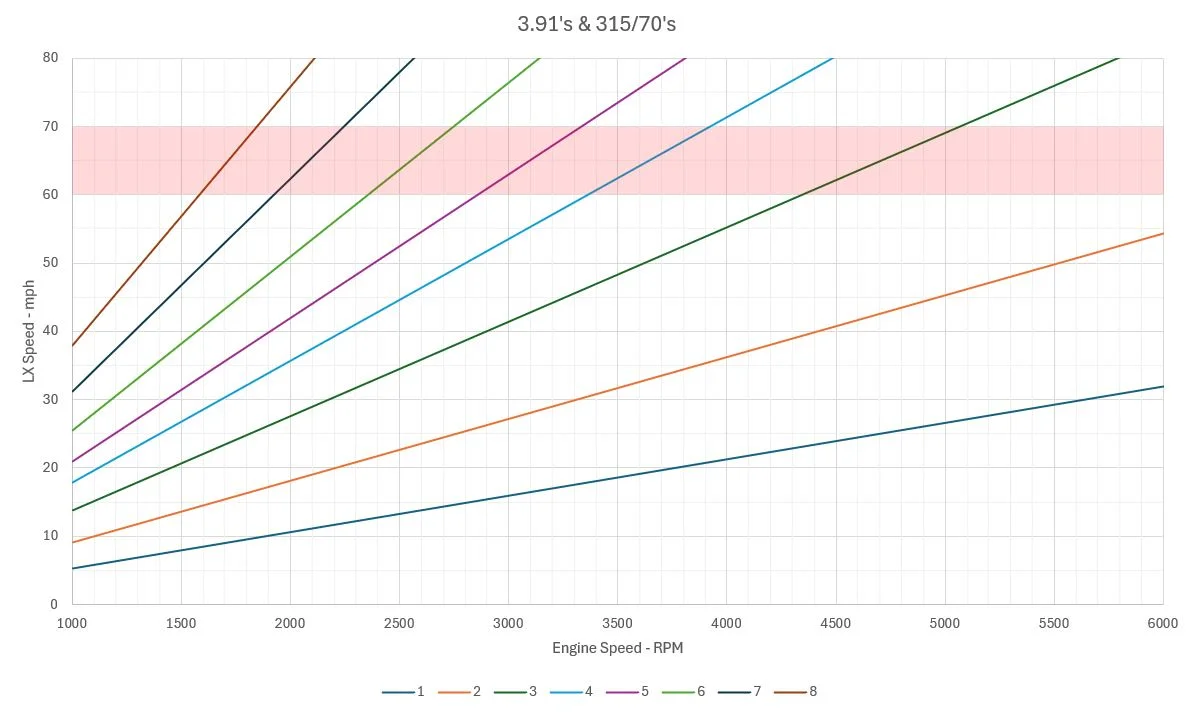

I am looking closer at regearing and trying to decide if I wanna go 3.91's or 4.10's. I know 3.91's are even a bit short for 35's to keep the stockish gearing, but honestly the difference between the two is pretty close. Going from the stock 3.31's to 3.91's is an 18% numerical increase in gearing, but then its only 24% with 4.10's.
My LX is not a daily driver. It only really gets used for towing, offroading, or if I have to go to the airport for work trips, otherwise it kinda just sits. When I tow, I tend to be moving around 70mph on main freeways and most two lane roads are 65mph, so I highlighted the speed range I spend most of my time probably 95% of my time. I see very little high speed freeway without a trailer(typically 65-70mph on I80 heading to Salt Lake City.). On top of that, my living room is at 6500' so my engine is producing 20% less power/torque than sea level as I drive out of my driveway. Because of all of these things, I am kinda leaning toward 4.10's.

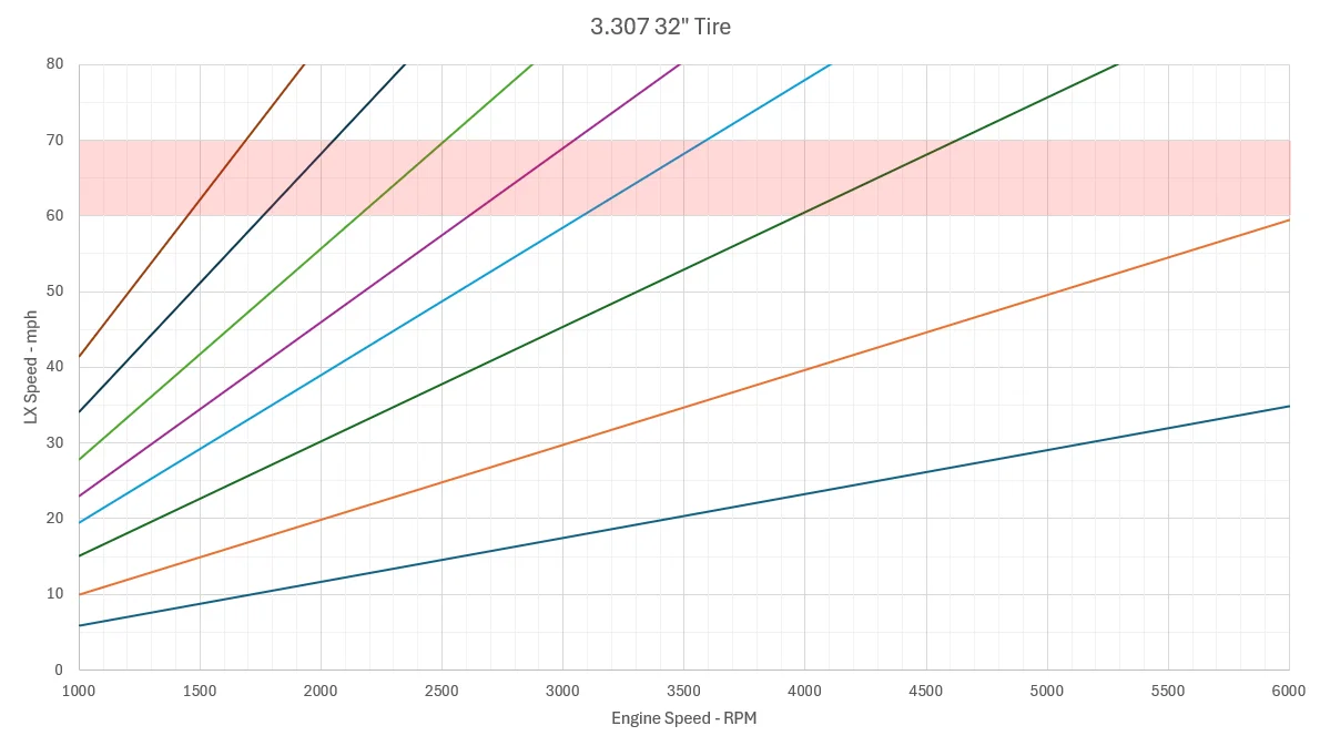

For reference, this is what the gearing looks like on a completely stock LX(3.307 axles and 32" tires):
They are not great for towing TBH, trying to match them isnt actually a great idea. If you look, 3rd gear is significantly less useful here than with either the 3.91's or 4.10's. If I dropped to 3rd at 60mph I would only be turning around 4000 rpm whereas either the 3.91's or 4.10's would give me 4400-4500 rpm, or an extra 10%-12.5% hp than even a stock truck. An keep in mind, this is against 32" tires! With my 35's this is even worse.
My only worry is, will the transmission allow a downshift to 3rd at 70mph with the 4.10s and jump to 5300 rpm? Or will it lock me out of 3rd?
If you're looking for another opinion, IMO its still ill advised to go to 4.1s on the 8-speed. Even with the justifications. It's not only about cruise. The transmission is there to support the whole spectrum of driving conditions. Too much gearing can create an annoyance every time the vehicle accelerates, and has to move through a useless cog before the engine gets purchase into its powerband.
