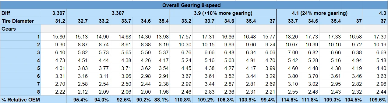

I don't know what final tire size you're shooting for. Just my opinion since that's what your post asked for - on the 8-speed for 35s or less, 3.9s is the ticket. It'll still have plenty of gearing advantage over stock for the things you're looking to improve. Without going too far that it trades any goodness.
Would your tune change if 37’s were a possibility since that would effectively put me back to stock gearing on 3.91’s, which seems to have its deficiencies?
I wish Toyota made a 3.73 gear set because that would make the decision a bit easier. My hang up is that the 3.91’s and 4.10’s are so close, a lot of the things you were talking about I think would be issues with either gear set.
And to be honest, the truck does great with the factory gear set when I’m not towing. The tire and wheel set up I’m running is no wider than the stock tires and is 6 pounds lighter per corner so other than the seven or 8% effective gearing it really hasn’t had much of an impact, I’m still averaging 18 mpg on 35’s

I know that hole well. It's an issue created when modifying with larger tires and lost gearing. But it was really only an issue with 33s on my 6-speed when combined with heavy loads, elevation, and grade.
Now that I'm regeared and practically back to stock gearing with the 35s, it's solid. Above ~8k ft, there a lot of HP lost to your point, and it's useful to anticipate gear selection to maximize access to what power is available. I find stock gearing does give me good access to the upper revs without getting stuck in the hole. The 8-speed should even be better in the that regard, with lower gearing and tighter spacing.
Yes, I think 37s is the breakpoint where 4.1s might be useful. Still not completely necessary if only tires and not towing. Though at that mod level, many are also reaching for lots of heavy overlanding gear and armor, including things that affect aero loads and the tallest cruise gear.
