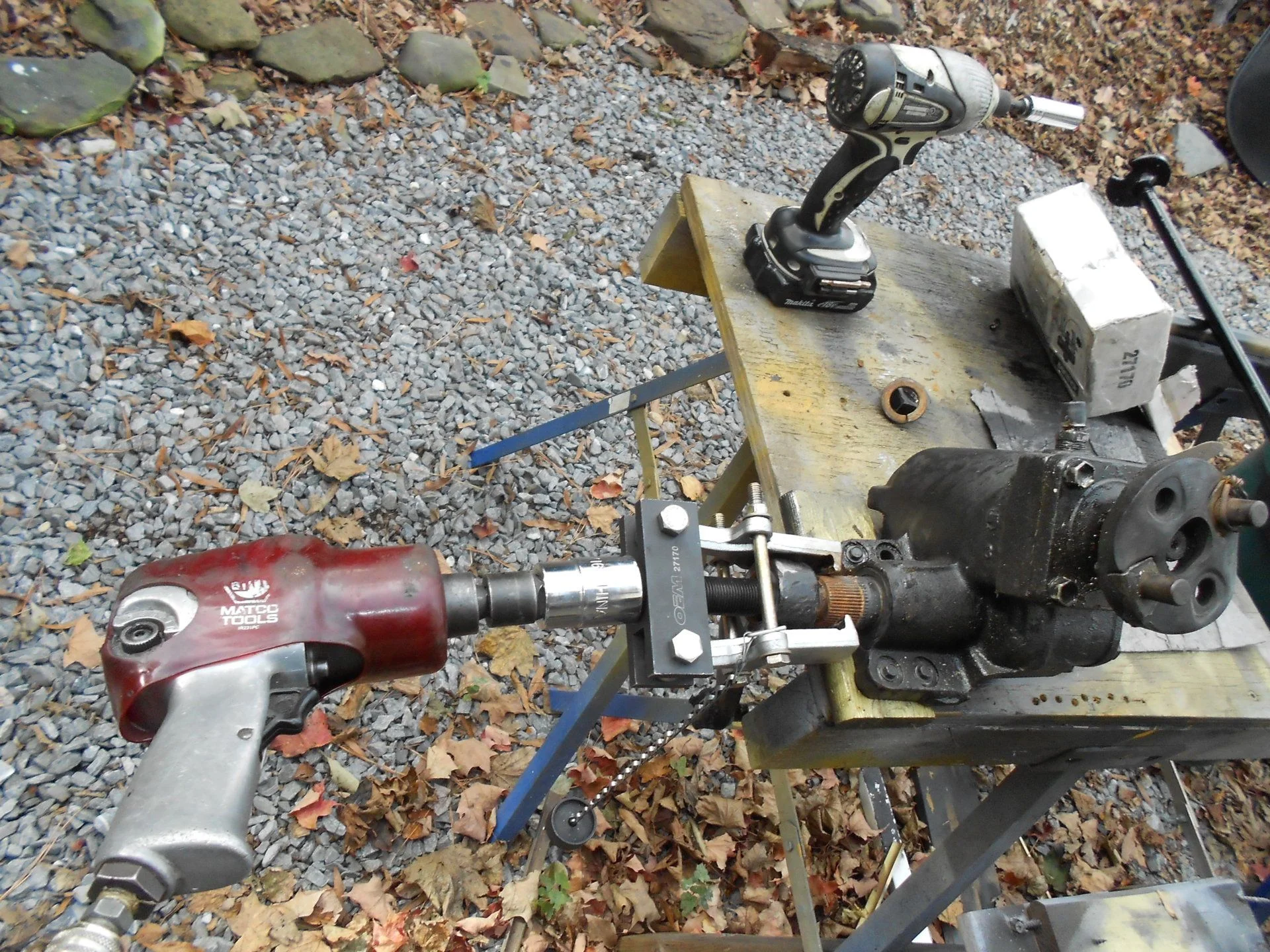

BTW I ran into a tie rod that was harder to get free than a Pitman arm! Used basically the same procedure and finally got it off. One problem I had was getting my puller to get a good bite. I wound up using a large C clamp across the puller to hold the two arms together. The puller I used was like the one in the second photo of post #6.

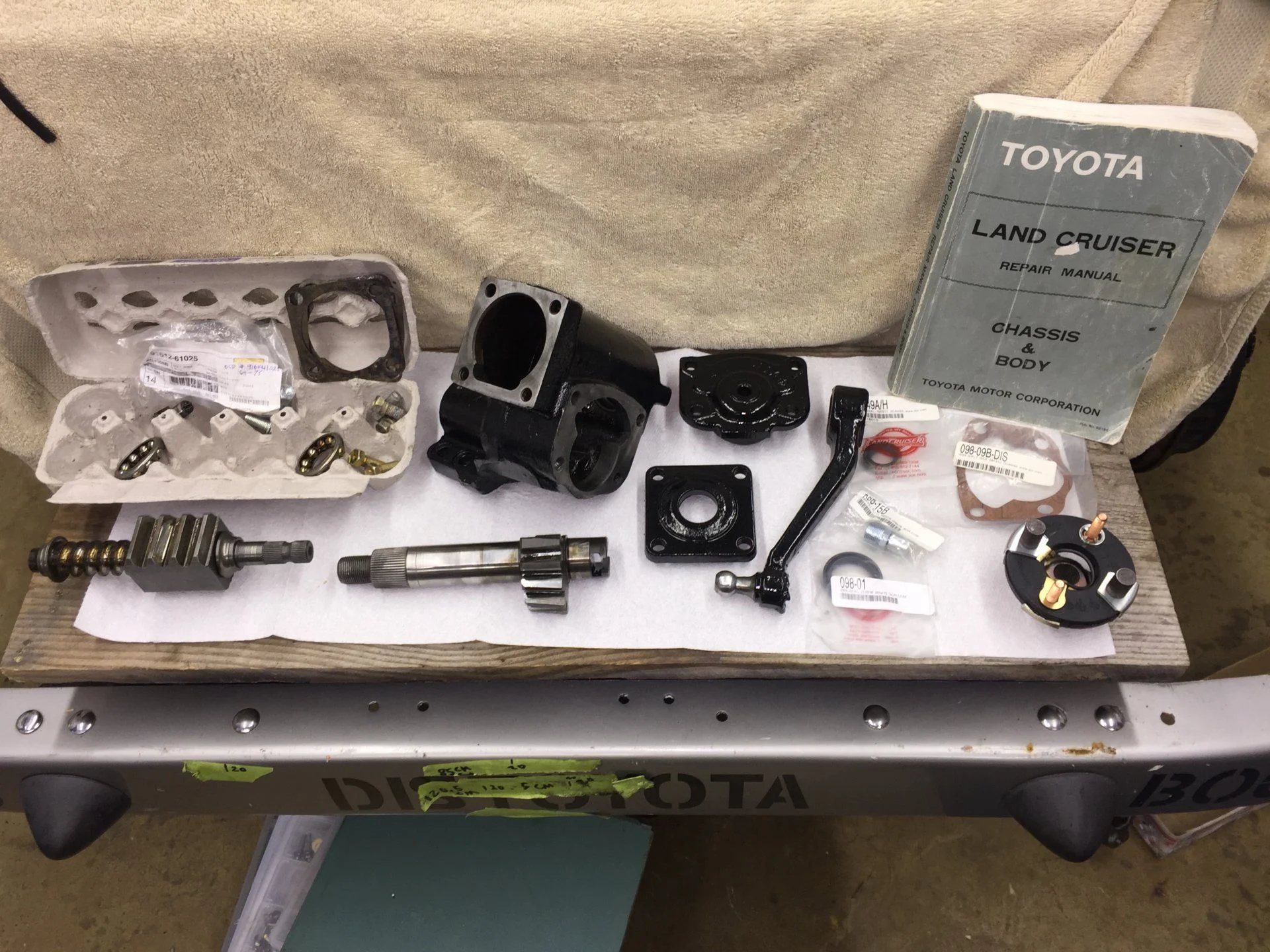

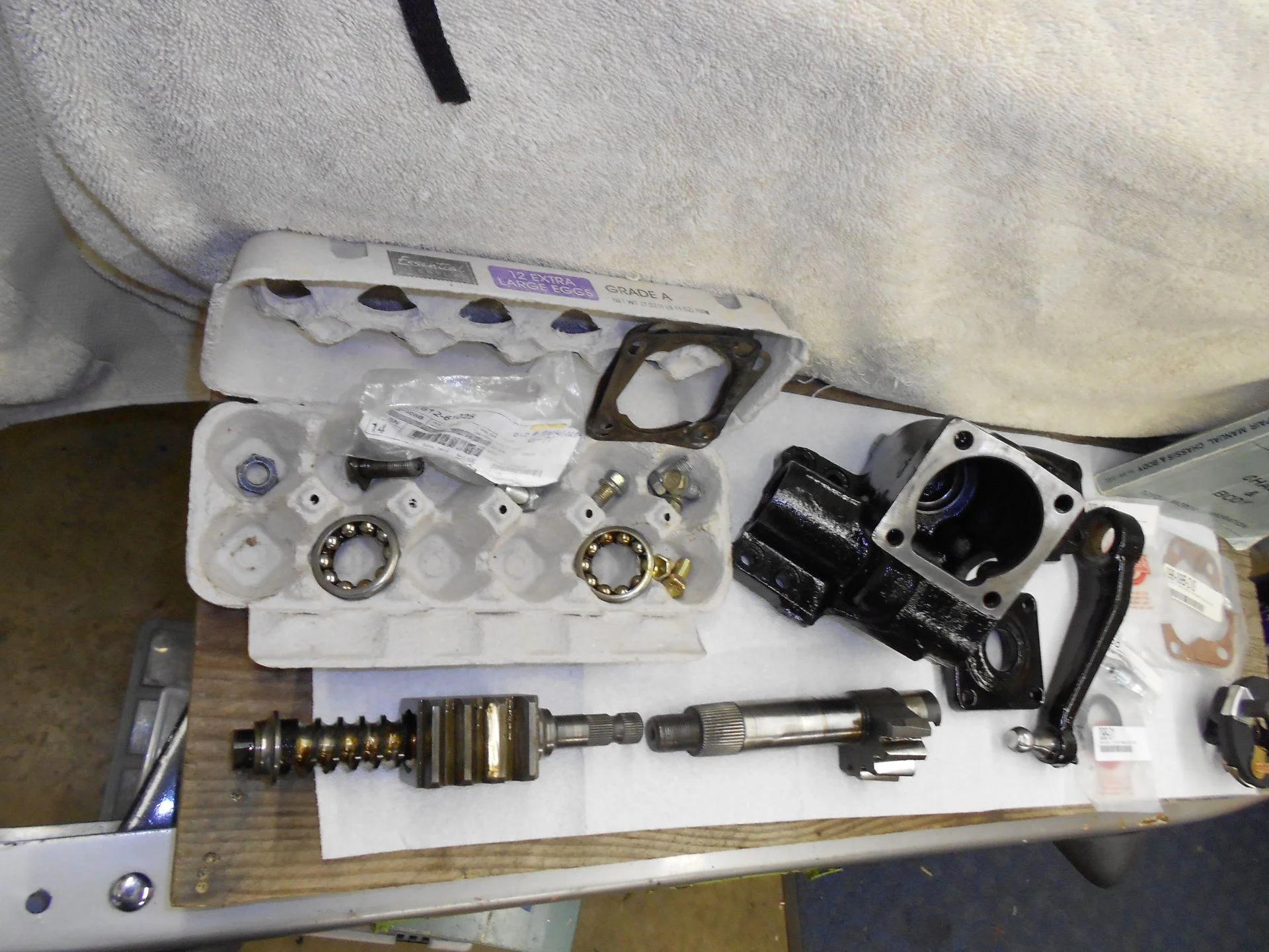

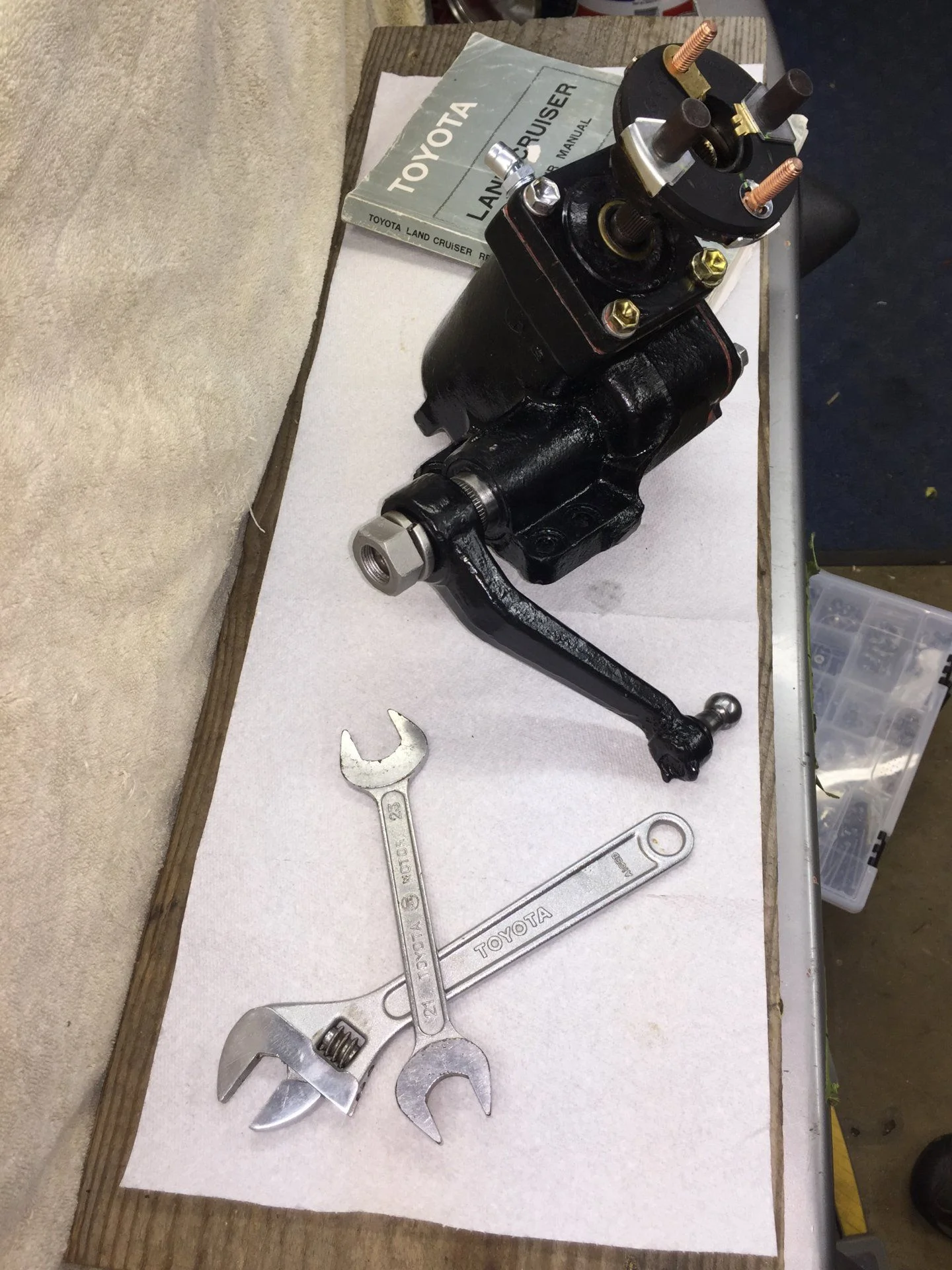

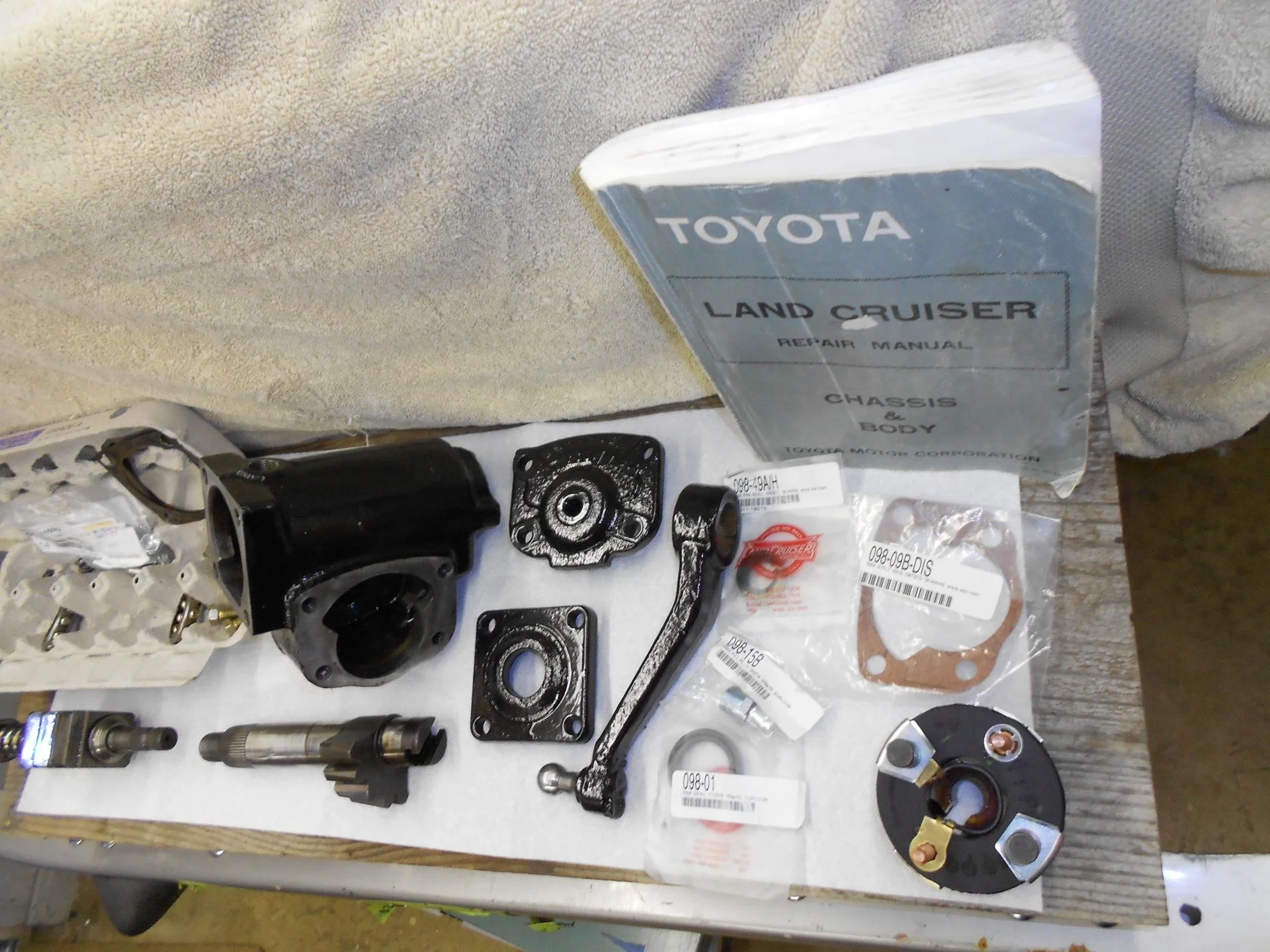

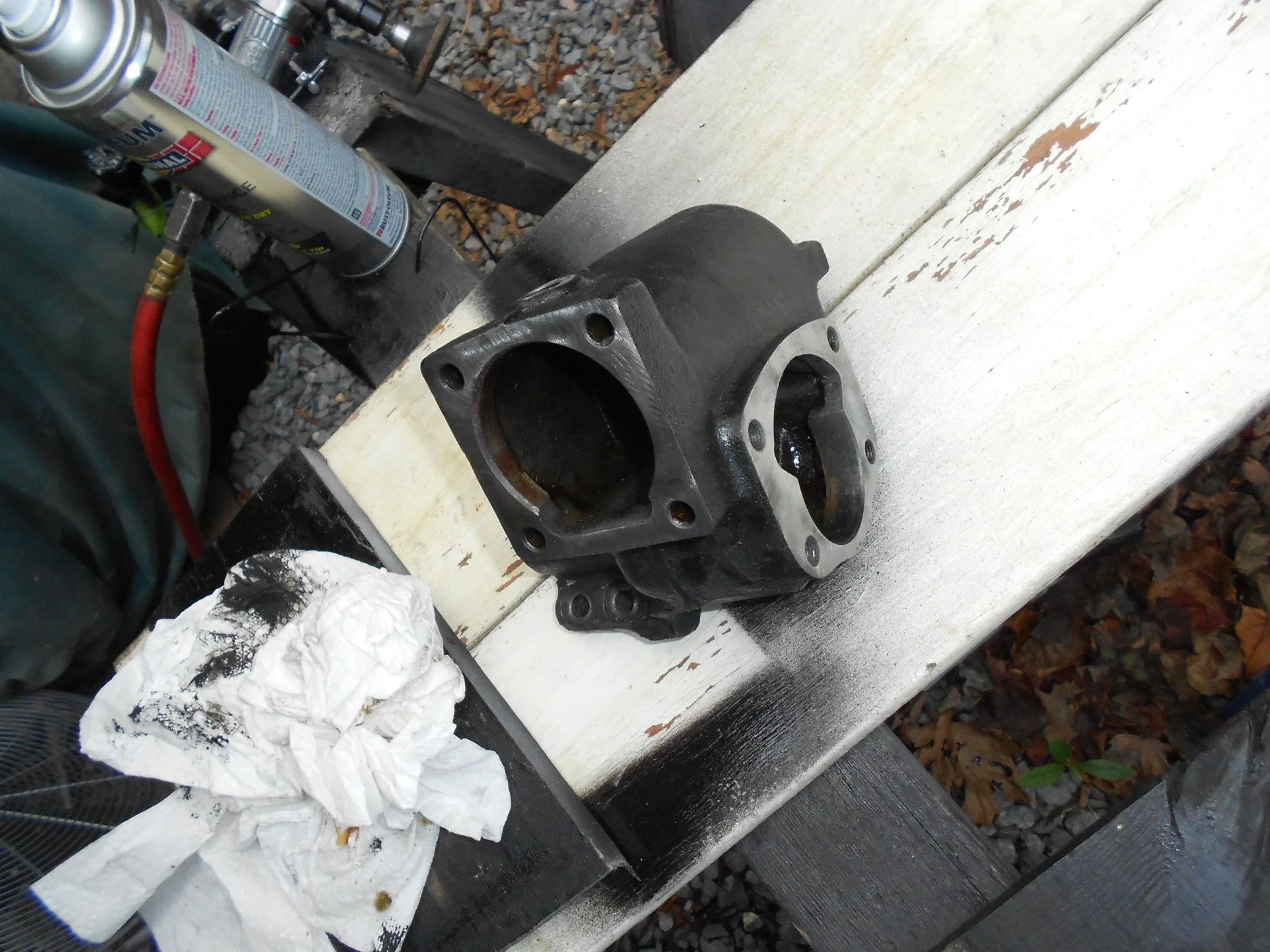

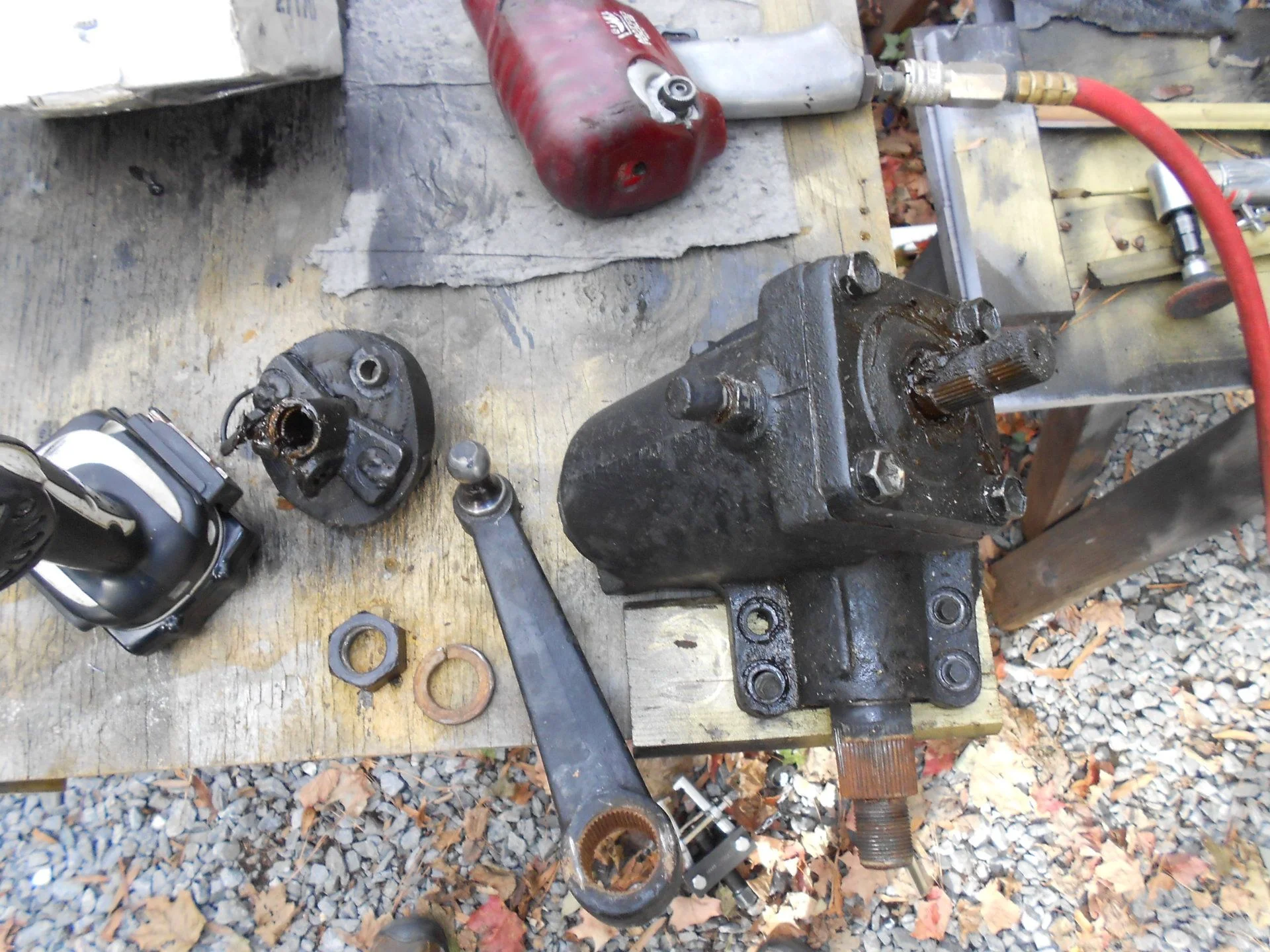

View attachment 1794287 View attachment 1794288 View attachment 1794289 View attachment 1794290 View attachment 1794291
Thanks for the advice. I see marks on the end of the Output shaft, but there aren't any on be pitman arm itself, am I correct? Should there be?
