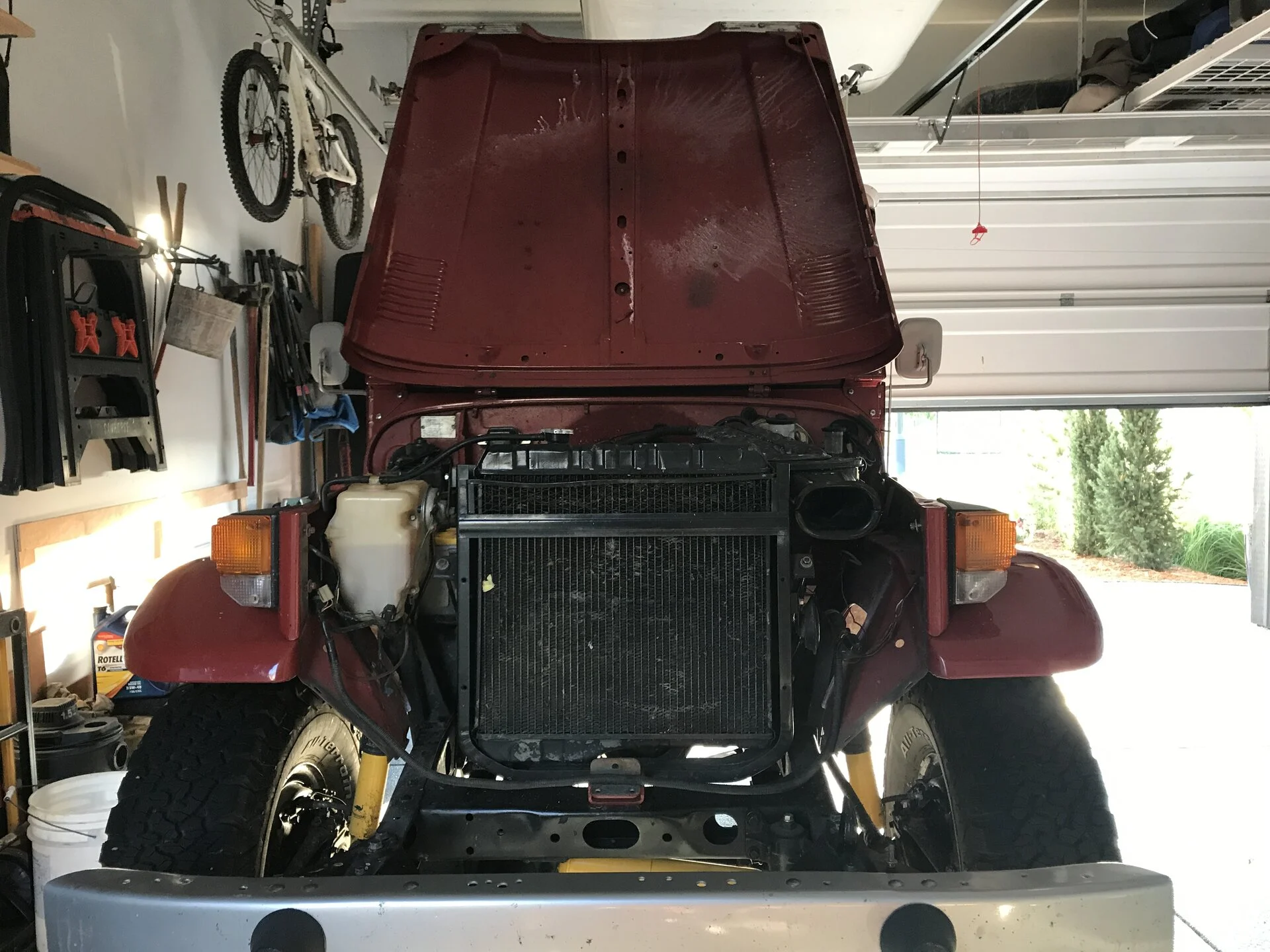

Going after the timing cover gaskets and seal and trying to scope the job. Can I do it with the radiator installed if I pull the fan and shroud? Will the balancer puller fit in the space? Any suggestions?

Whatcha working on Bob?
Regardless, how would you pull the shroud and fan without pulling the radiator?

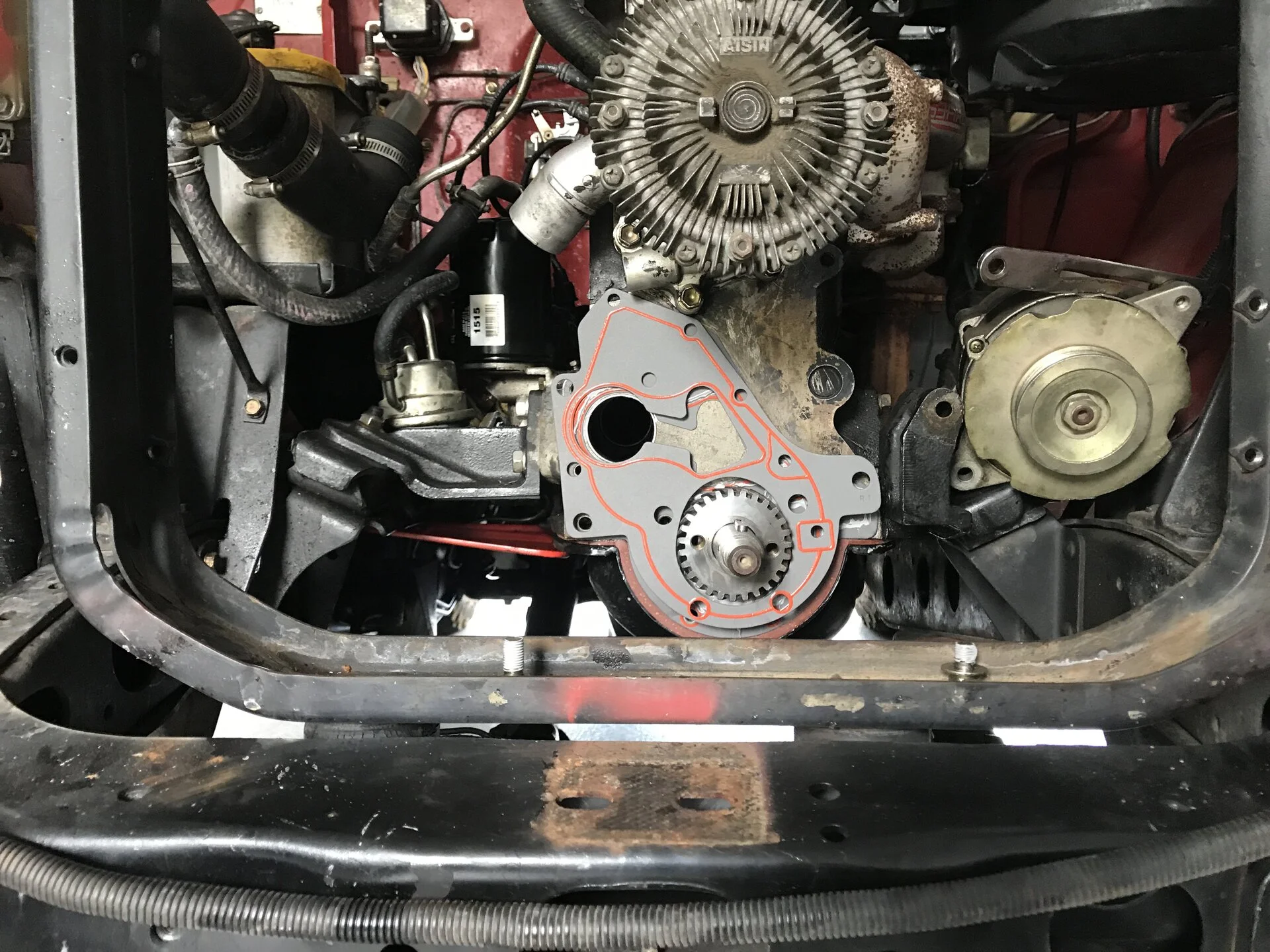

This is kinda what it looks like when going for the timing cover gasket. But I’m no expert!

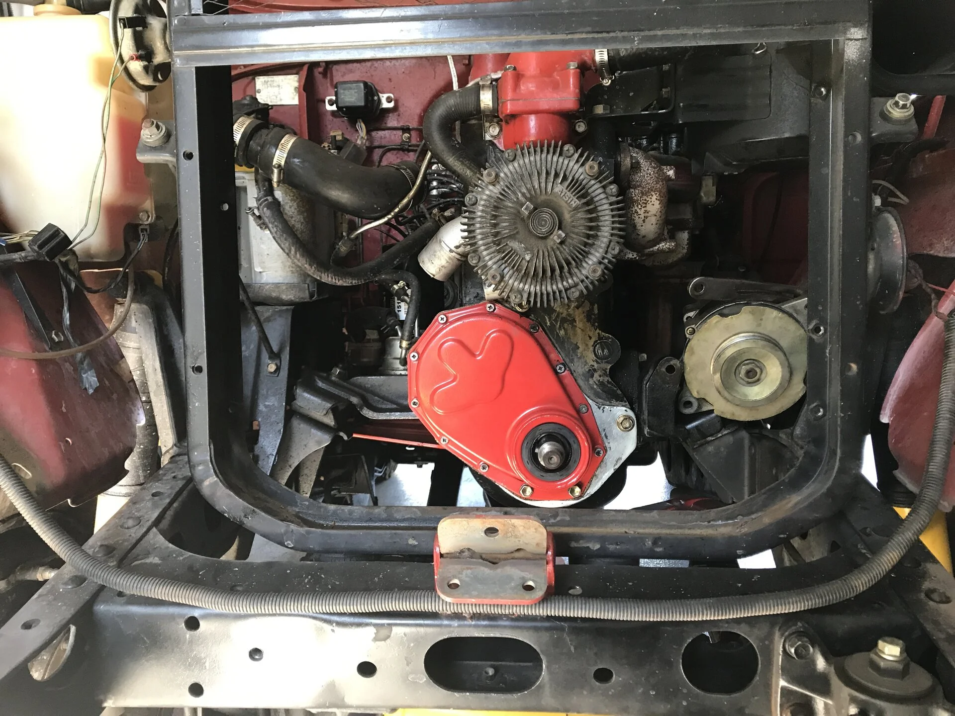

just a heads up, timing cover bolts are hole specific, caution when installing the crank seal, leave cover loose install crank pulley to center cover then tighten cover,
pulling the cam? get a side cover, valve cover and the 4 nut seal gaskets also
