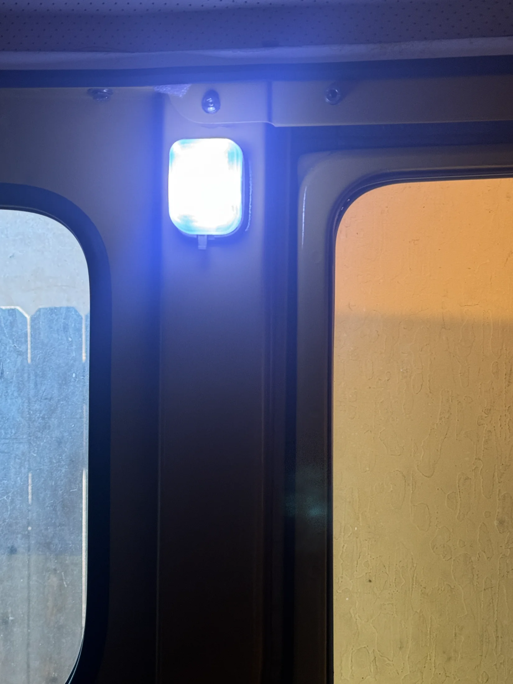

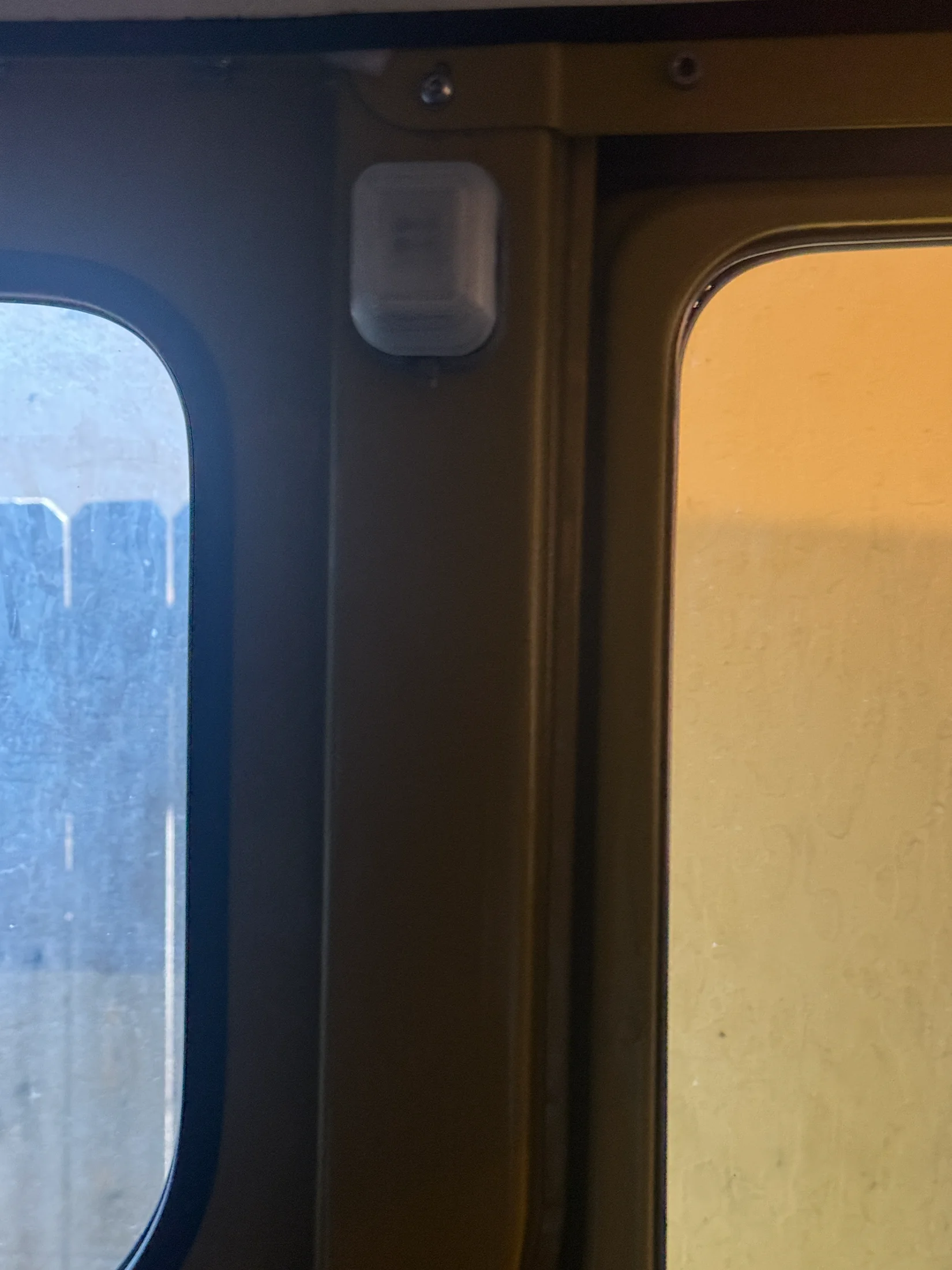

@ofer bruhis gave me one to model from.
So now replacement dome light overs are available.
If there is anything else you think I should make let me know.
Pretty sure it replaces that crustyness
Sure it fits but not corrected for most markets from 10/81 on. Those worked off the door as well as the switch. Believe the perimeter where it attaches to the base is the same but cover itself is different. Can see how the face angles in at the bottom where the script is.
Send it to me and I'll happily make one

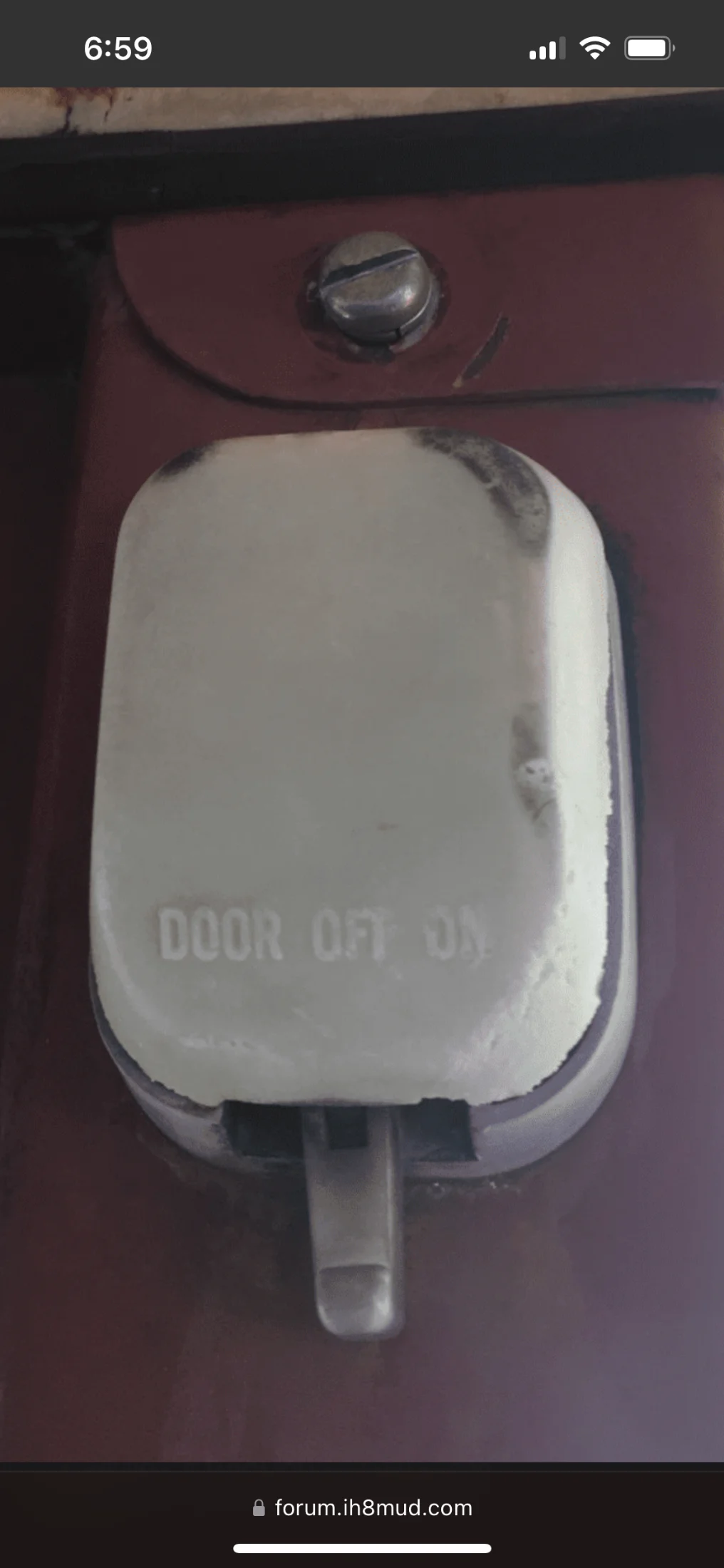

I'd be interested in this as well. I was going to take a stab at it but I don't have measurements so was going to base it off of photos for a start. Was thinking Nylon for starters.
EDIT: Does the dome light cover you're offering have the "door off on" printed on it?
Nope no text on the light

The lens (81241-90300) is NLA from Toyota. The pre-07/80 light assembly is avail from Toyota, 81240-90300. MSRP is $72.50 so a lens @ $9.00 is perfect for many needs. I need to order a few for my personal projects. Well done!
