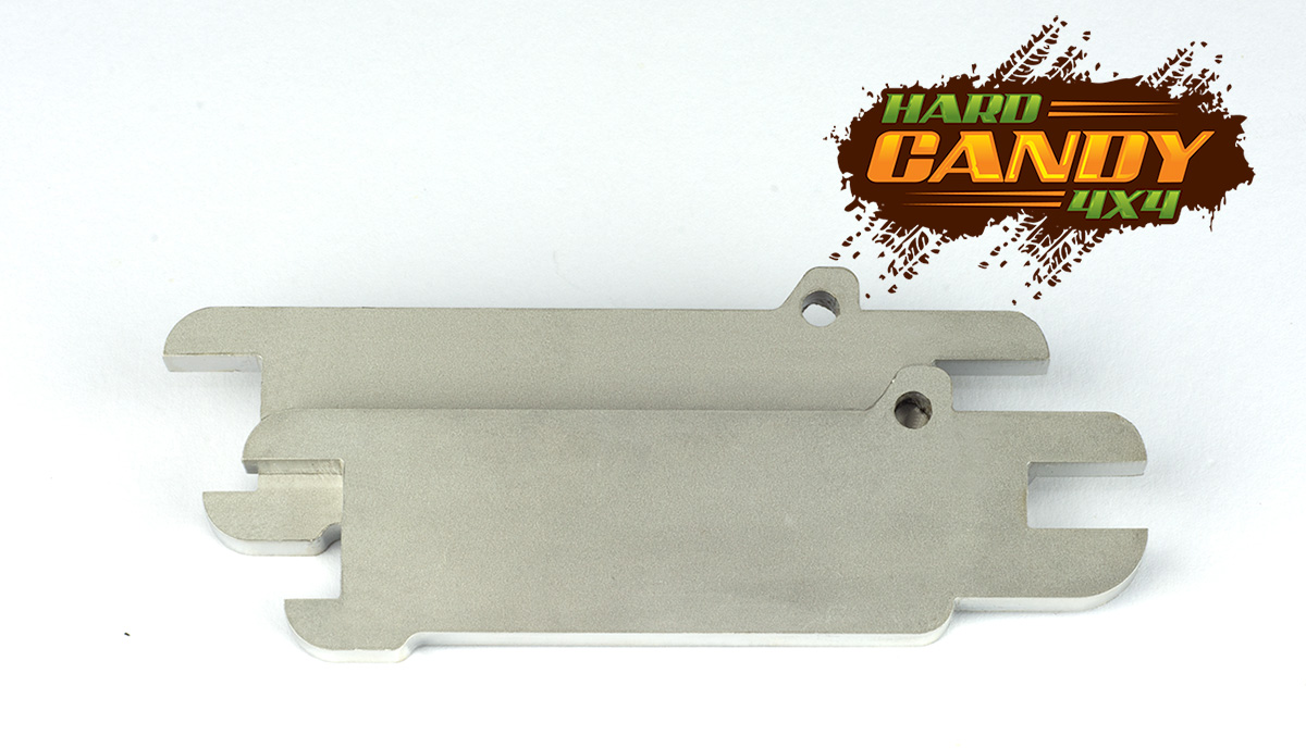

It is a known weak area on the 80 and to get mine right the year before last, I fitted new disc/drum combo and shoes and spent ages getting the balance right (ITV requires balance of all brakes to be held within 'X' kg's of each other), and it got through OK but, I have found during 'testing' on the street a good yank will lock one wheel only.
This year will see the rear brakes getting a full overall, including callipers and so forth, there have been modified 'dog bone' bars between the shoes on offer, and various other ideas to get them perfect but even when perfect, and for something that does not actually 'wear' they do not seem to stay very effective for long.

I found these a while back, have yet to try a set.
Hard Candy 4x4 Landcruiser Dog Bone Extended Spacer
^^^^^ Heck yeah, I'm ordering a set - good to see someone else has felt strongly & addressed the issue.
Thanks for the link, never knew anything existed for this!
**Edit - just tried to order, no bueno for us 'Mericans "no shipping options available".
Have to give 'em a call.
