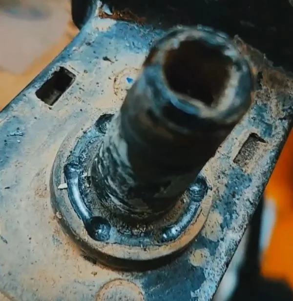

Hi All,
I am working on fixing the dreaded Floppy Mirror on my 80 Series. One of the ball bearings which sits in the bottom went missing. Anyone know what size I should use to replace it?

I think he's referring to the small individual steel balls (ie: not a complete deep groove ball bearing) located under the spring??
You could measure one of the remaining steel balls then buy that size from a number of vendors.

Haven't done this myself so just a wag, you could measure the diameter and depth of the cleaned out holes where the original balls sat to get some number close to the original ball dimensions as it appears that those holes/depressions get wallowed out a bit from use?? The diameter of the balls may be about double the depth, depends how far the balls originally stuck up above the hole. FWIW

Answering my own question here for the benefit of others. I found one of the bearings, and they are 5mm.
Good luck, chaps.
OK, to summarize for future reference, the balls (individual ball bearings) that an 80 Series side mirror assembly swivels on are 5mm in diameter and three are needed for each mirror.

I found two of mine, and I'm going to go to Ace Hardware in hopes of finding more 5mm bearings. I'm planning to just put three new ones in there with a little grease. Thanks, Kernal.
