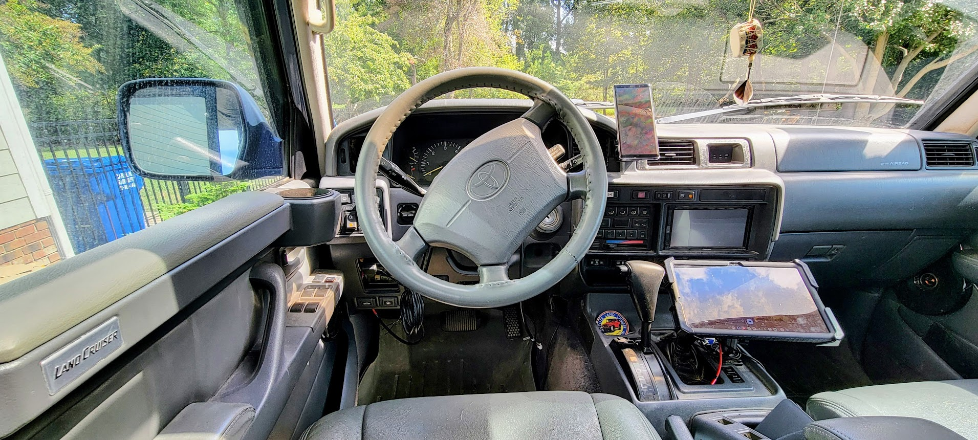

I had to go to Aliexpress to find a link to them. You want with ones with the 3 magnets. The adhesive ones will not work. The magnetic arm rests need to be modified but it is super simple.
I paid $96 for mine and love them.
I'd seen those things being flogged on ebay, and never understood how/where they fitted, because they didn't show a picture of them attached. Seeing your picture, for the first time I actually understand how they work!

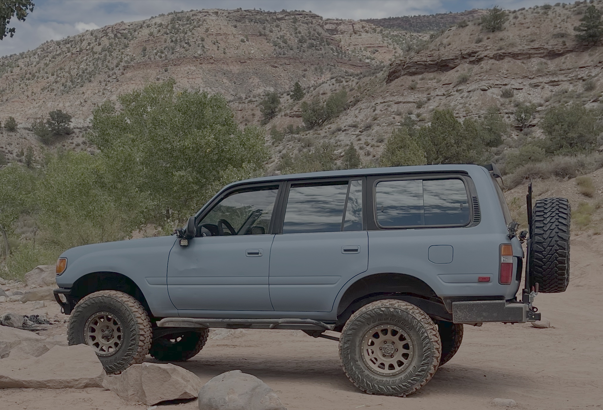

I also was expecting the worst when you said baby blue, but after seeing the picture I kinda dig it. Where in UT? I'll have to keep my eye out for you.
Congrats, and I love the 2-tone scheme. I considered a similar white/red on my old 80. The clunker is now roaming around in Wyoming and I'm still able to contact the guy I sold it to, but I don't think he's selling. I wish I had kept it and done a V8 conversion, but that's easy to say from this armchair. Like you said, life happens.
I'm in South Ogden, but I work from home and don't get out much other than getting up to Smith's Lakes or down to 5MP. Delle's our winter wheeling area. Around town, you're more likely to see me in this:
Mine are not permanently attached so I can move them around.
