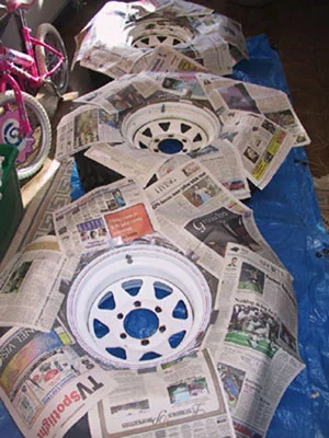

Here's how they looked in November of 2002, right before I painted them in my high tech lab. :rolleyes:

I don't recognize the front bumper. I see where the hole in the upper passenger fender came from. I also closed up the holes from those mirrors and have stock mirrors on it now.
The wheels were white??? When I wire wheeled all the gray off I found black paint - not a speck of white.

I painted the wheels much in the same way. I used note cards stuck between the rim and tire. It worked out pretty darn well. I did bust off one of the wheel weights, so, I marked with Sharpie where the outer weights went and their size so I can replace them when I'm done. I still need to shoot a little matte clear coat to help with clean-up.
