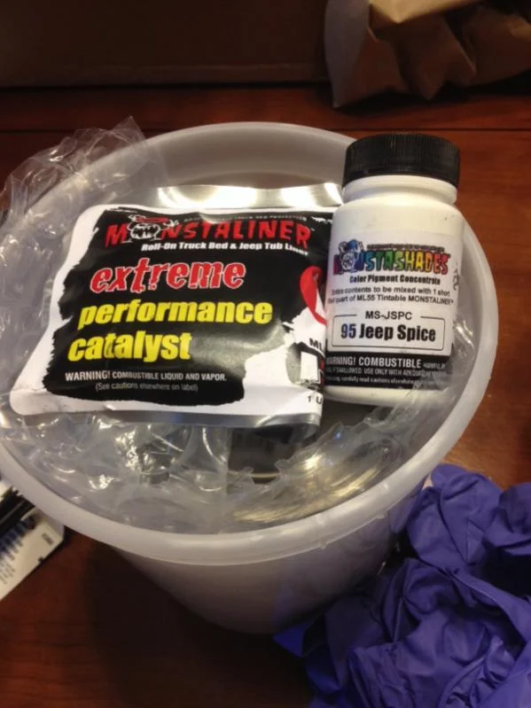

Info on the web for both Monstaliner and Al's says no color matching - are there any other products out there that have yielded decent results with color matching?
Upol raptor liner is tintable as well as could be painted after application. Caveat the colors do not show true to the paint when mixed with rubber. Msgrunt lined his with 6m1 tinted liner and it was way brighter. But his thread may have some cutting and mixing tips

Also, check out the Monstaliner thread in paint section... Color match has been done

I tinted my Al's liner with a automotive grade base coat. The color seemed to come out darker than the "sample chip" I just picked it out of a book. Was a hyndai color. Dark grey metalic. Updated liner pic with my new tubes:D
