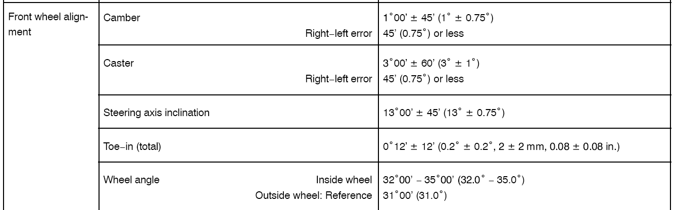

4) What is your toe-in and how was it measured?
will post a pic of my readout. The rear left 'toe' reading seemed a little odd to me.
5) What are your camber / caster numbers?

I was under the impression that caster values should be greater than that. Suppose you've ruled out a wheel issue with tire rotations?
Good catch. I didn't see the pic of his alignment initially.
Yes, caster should be higher than that at 3°. Caster is odd because he is using "stock height" springs. Something is going on there..
The alignment shop did correct the toe-out situation..

It doesn't wander too bad, but I can still feel a need for some caster correction. I have a set of Eim Keith brackets that I plan to install.
At one point I had an OME 2" lift and Iron Man drop brackets installed. Caster felt OK then, but I removed it all and went with a stock height (dobinson c59-210v, c59-221v) setup while chasing these vibration gremlins.
