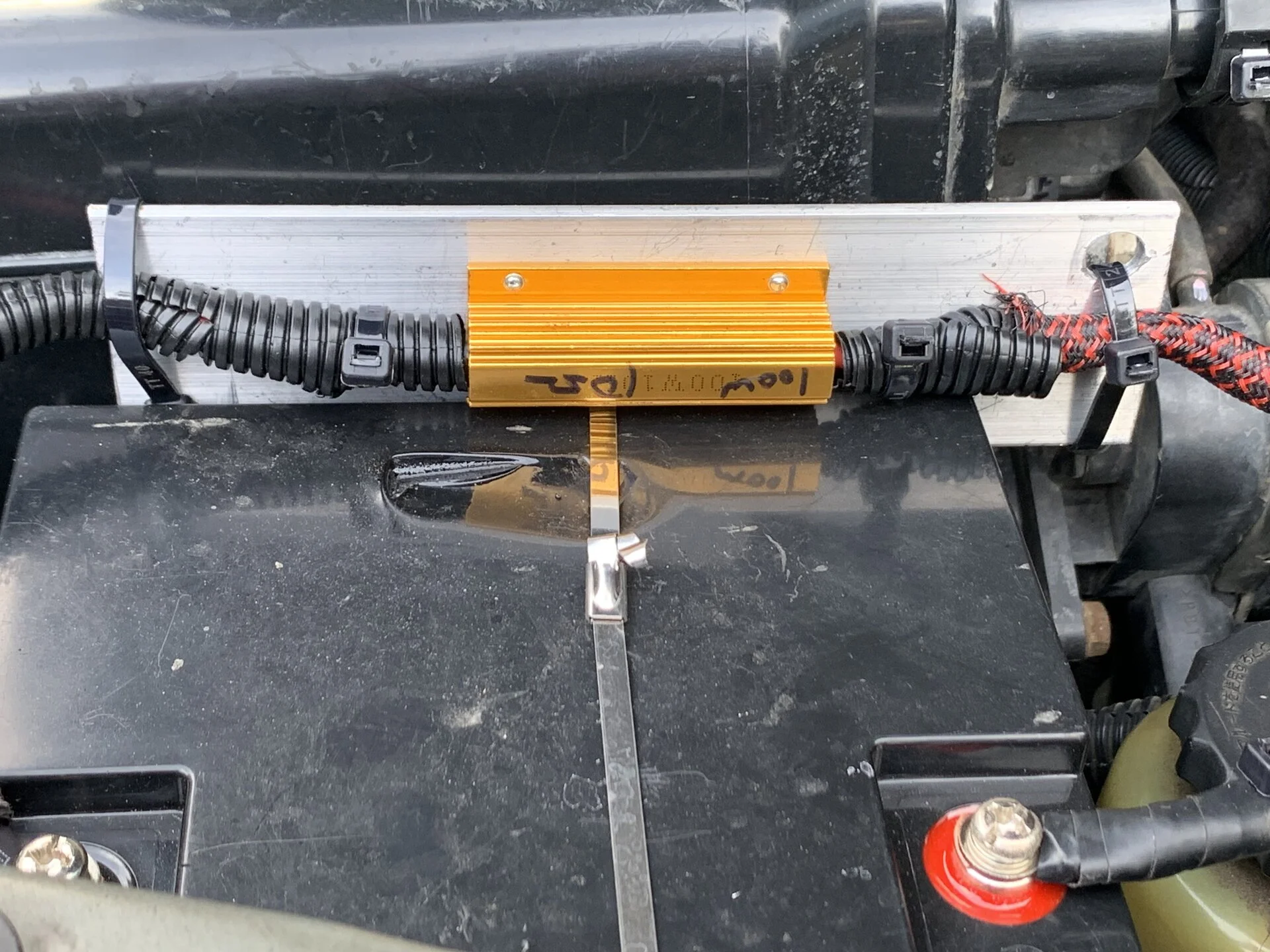

Yep. Power resistor was open circuit. Somehow it got real hot, there’s a nice melt point on the battery top. I don’t have anymore 0.1 ohm on hand, so trying the 10 ohm for now. Riveted the new one to a piece of aluminum to help with heat.
As soon as the ultracap could see the battery car started right up.

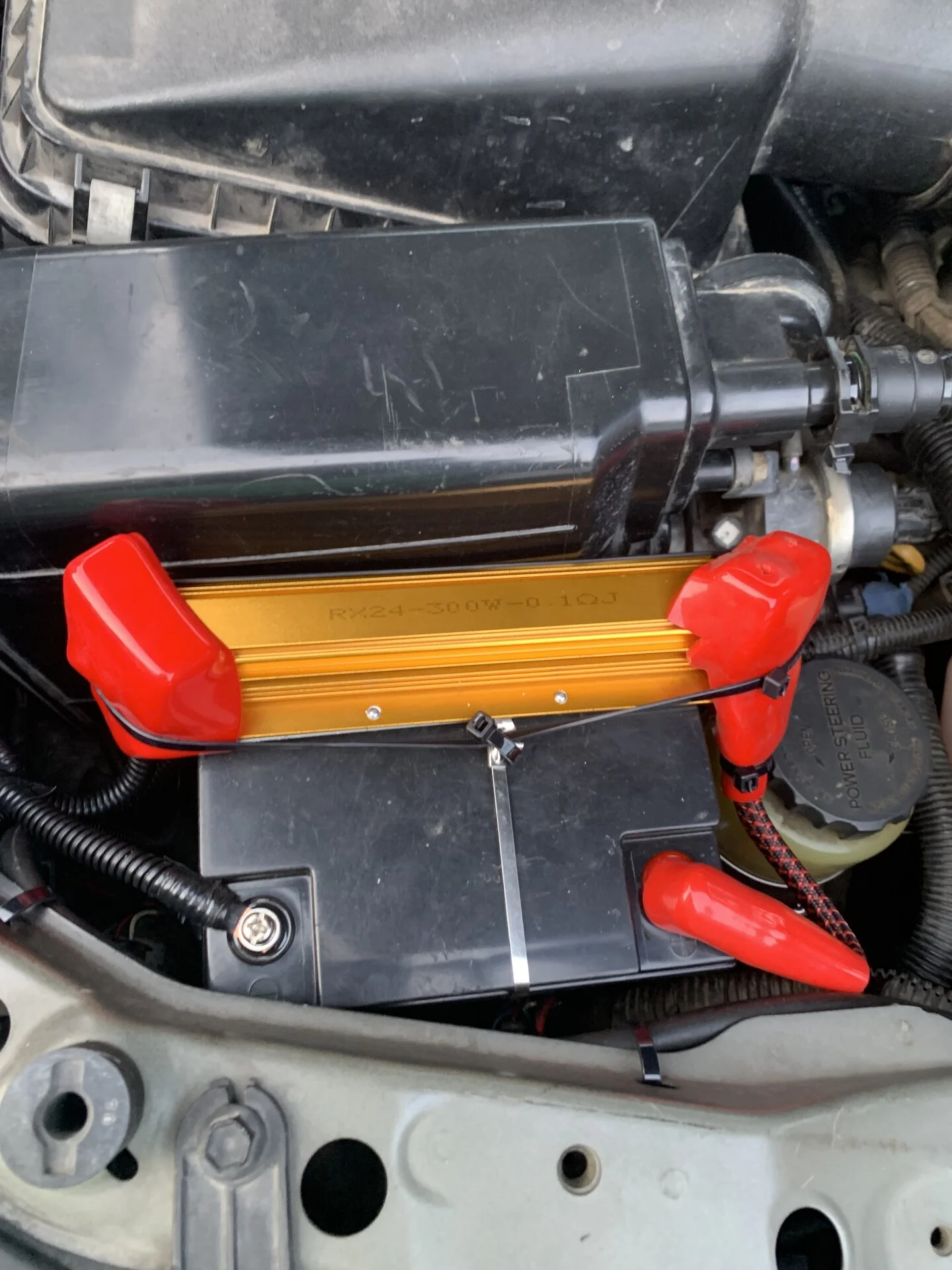

Put in the ‘official’ 300w 0.1ohm resistor.

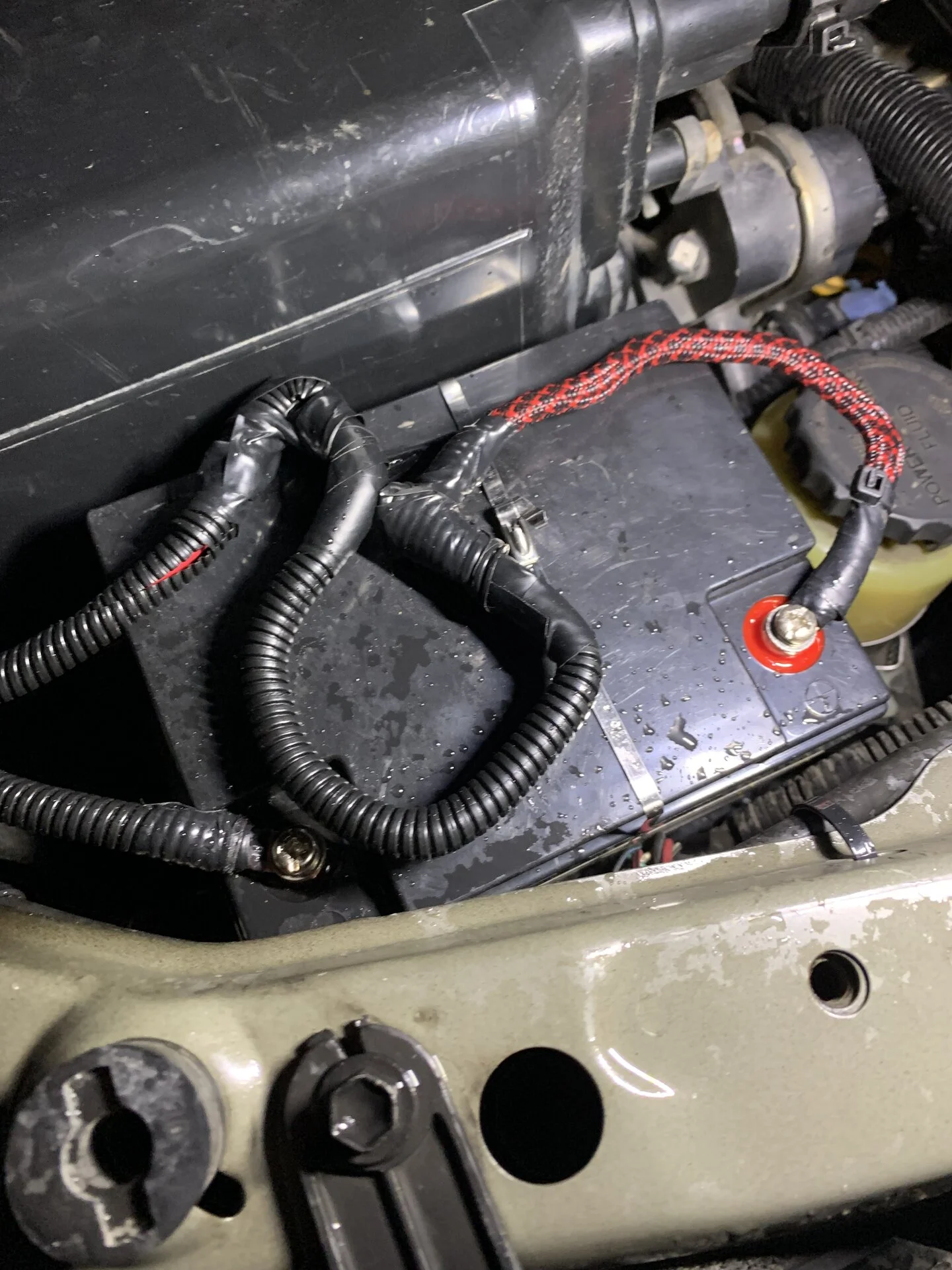

I have a loose wire on the ground somewhere at the ultracap, but I’m living with it until I get another 2 hr to fiddle with.

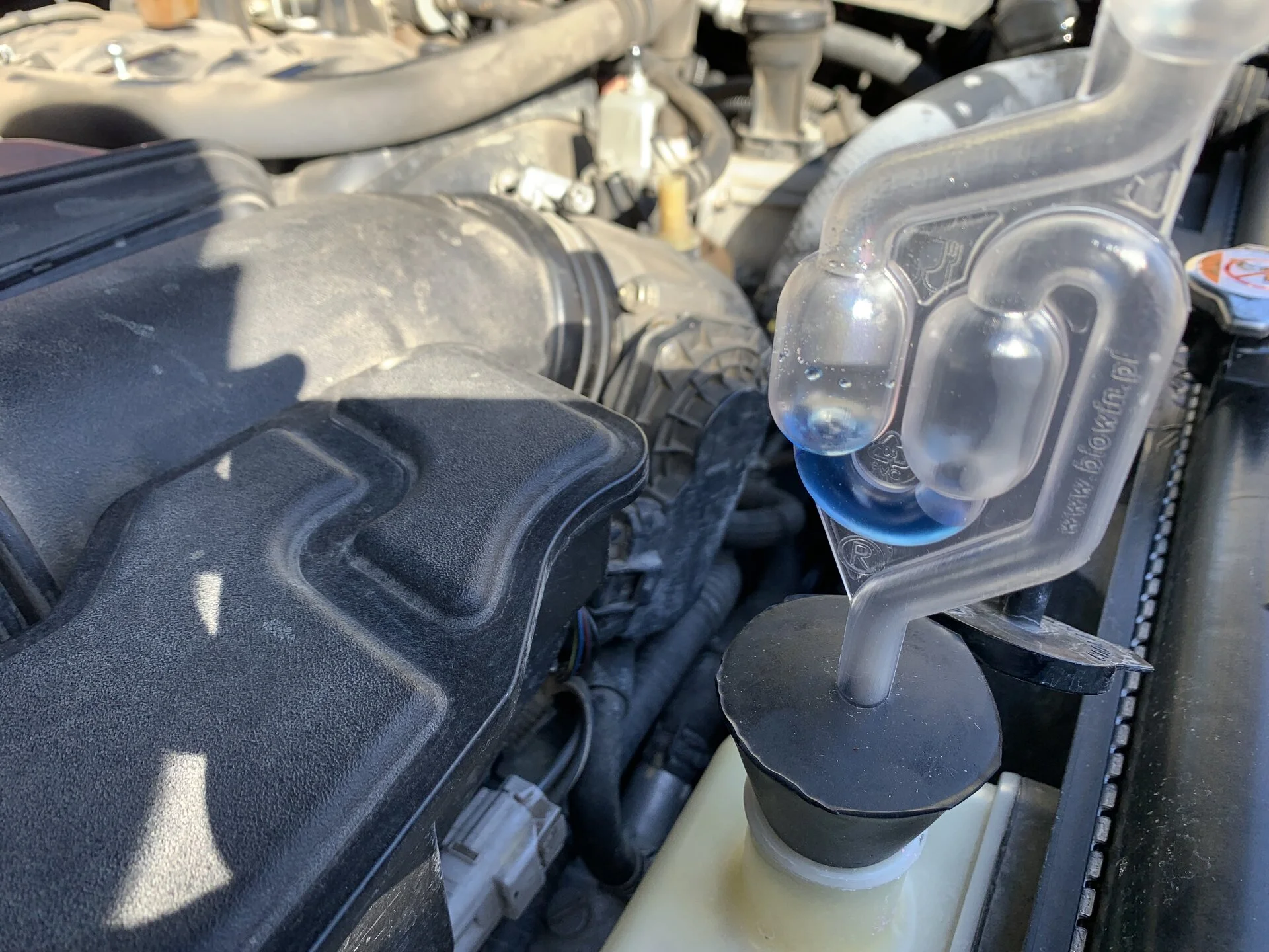

Did the head gasket test using RELD. The color did not change, so it’s probably not a head gasket leak.

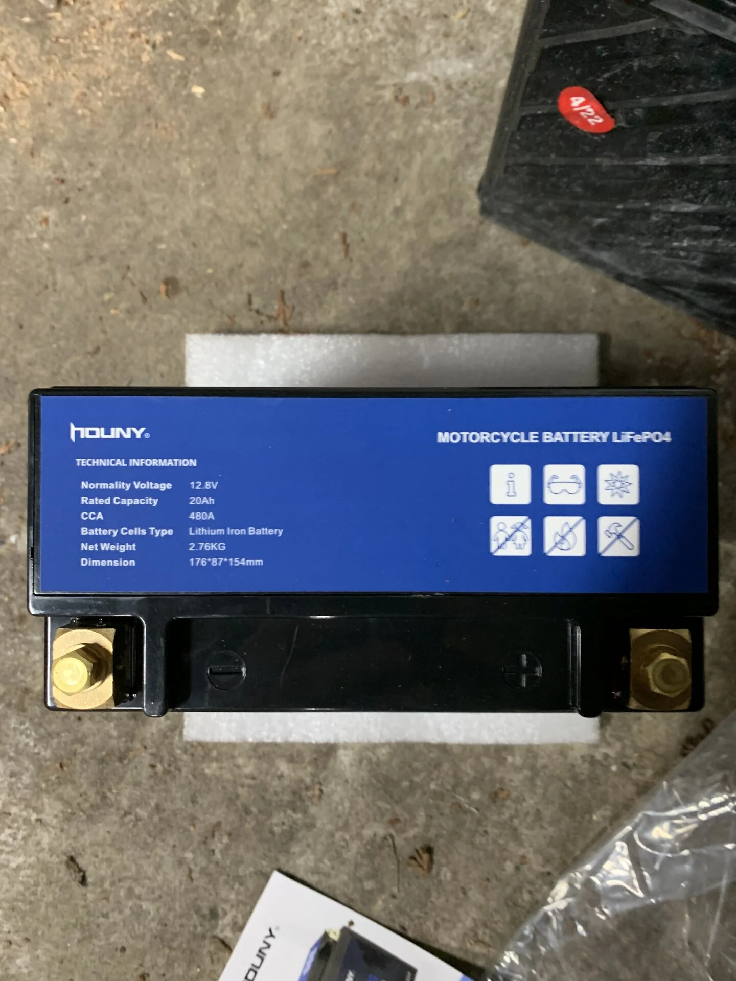

I did change the lion battery again, now running a 20ah starter version. It has no bms , only a balancer. Can do 480cca on its own (not that I need any cca as the supercap does starts). Using this lion so the bums doesn’t shut it off, and thus shut off the super cap , which requires an attached 12v.
So far so good, will be watching it and reporting back.
