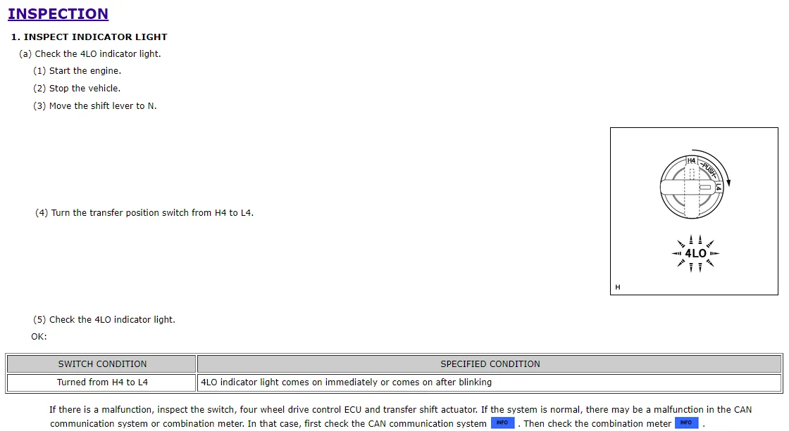

You've probably looked at the FSM but it doesn't give a lot of info as to what the various flashing scenarios mean, except "check the CAN system" and then "check the combi meter".
