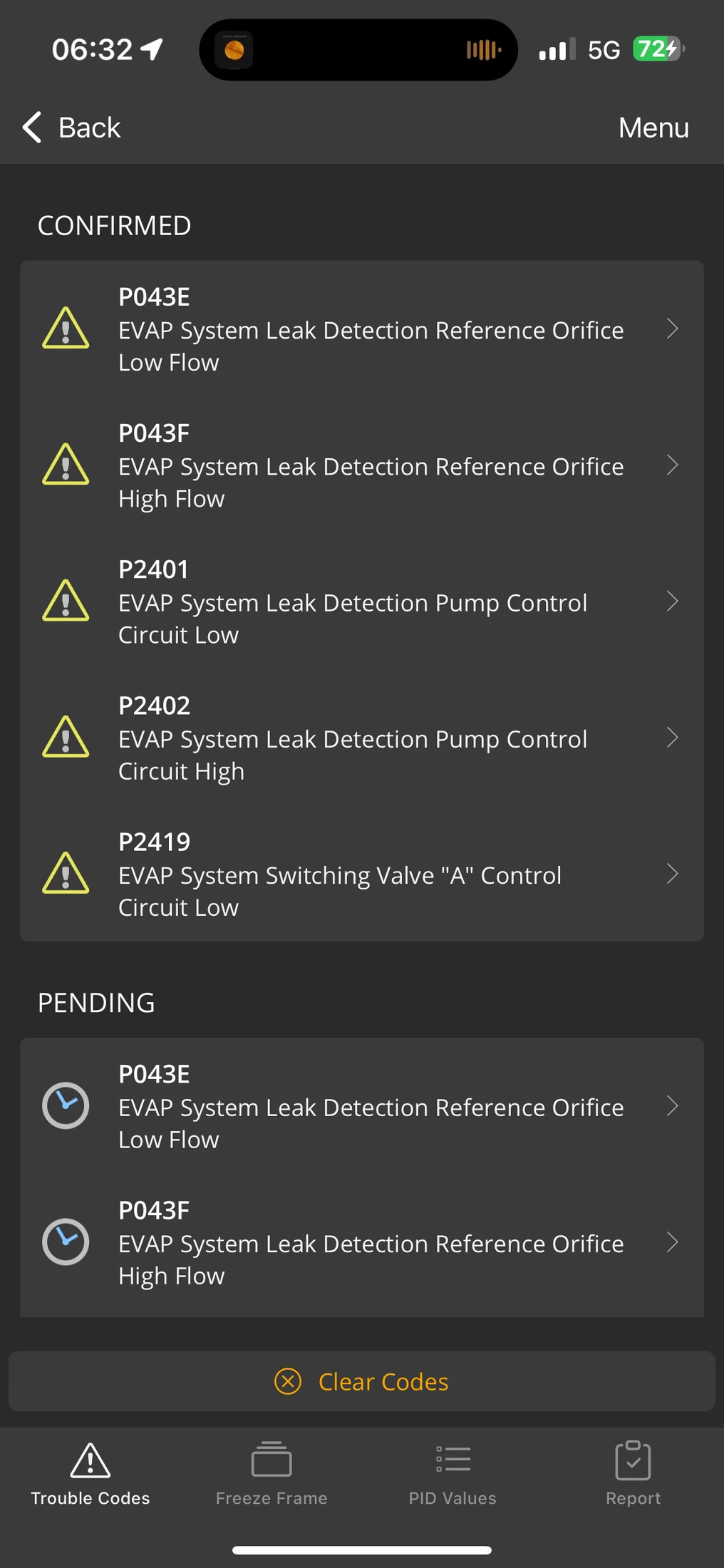

Wrapped the evap canister ‘in’ line with that self sealing rubber tape. It’s been failing every self test since I lost my green clip last summer. Fingers crossed.
Failed self test, was pretty sure it was the wiring, this seems to confirm that.
You all may recall when an LX tried the Rubicon and had to get towed out for evap issues that caused the AHC to fail?
I happened to already be in low after my typcial failed self test scenario. I was pretty shocked to see that AHc did indeed raise with no issues.
So when there is this daisy chain failure , must be a different kind of evap code than the self test failures set.
Here are the codes I get every few days that are caused likely by a broken wire in my extended evap harness

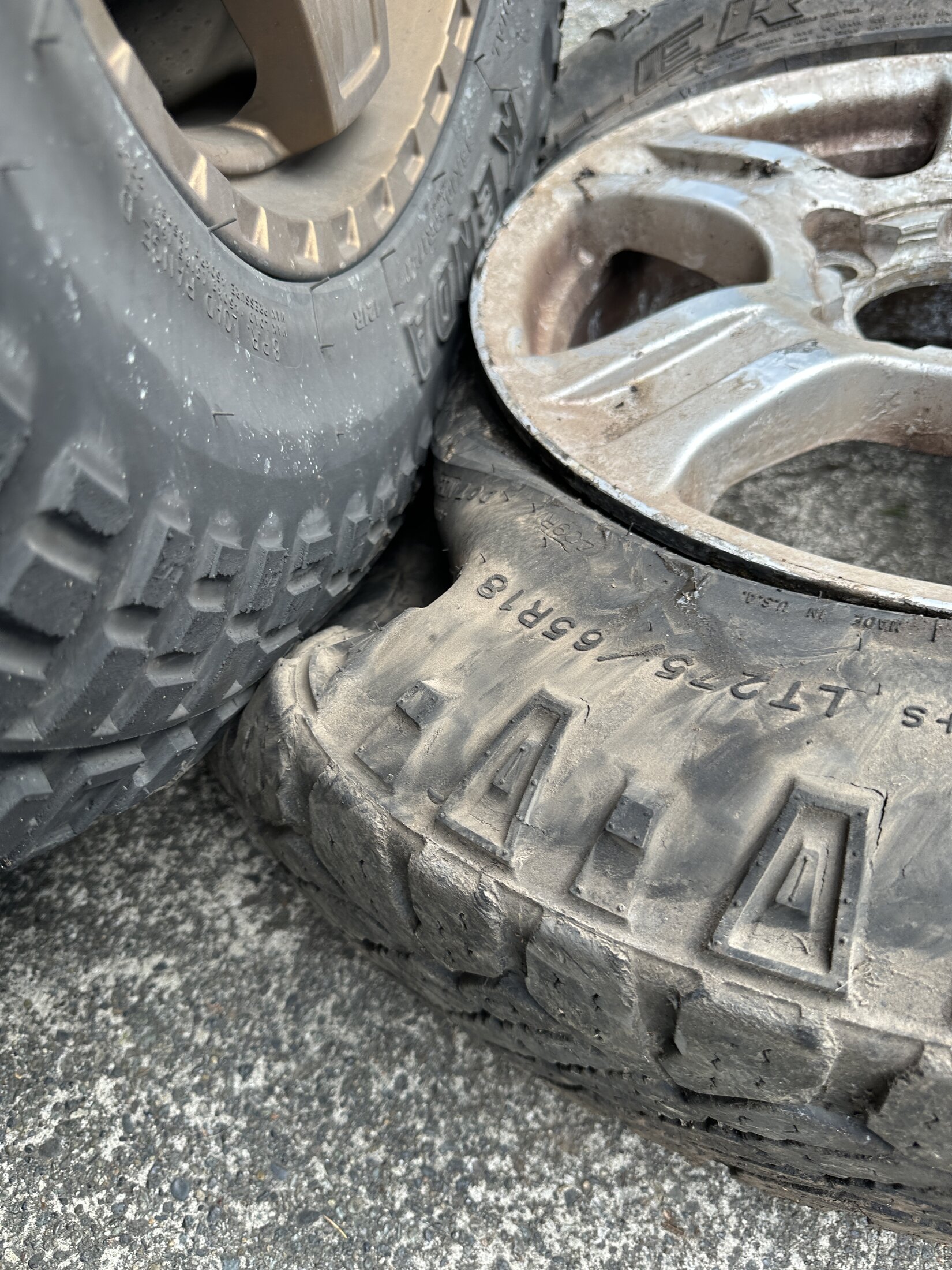

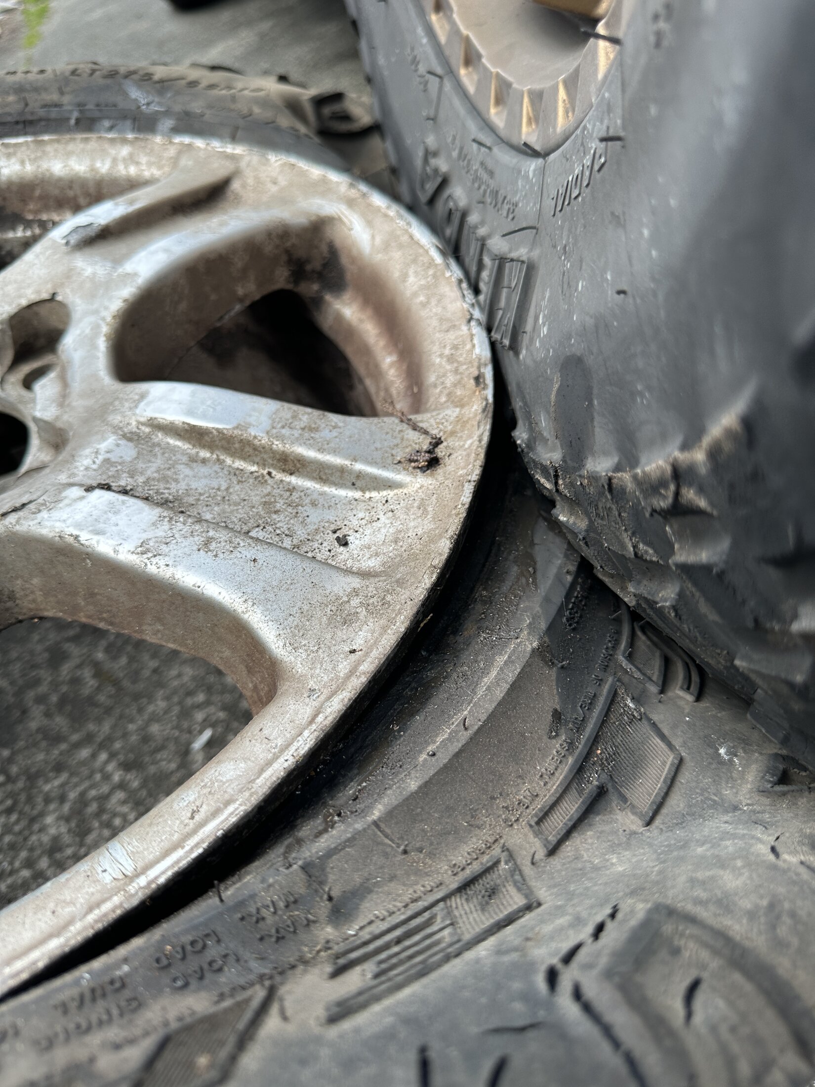

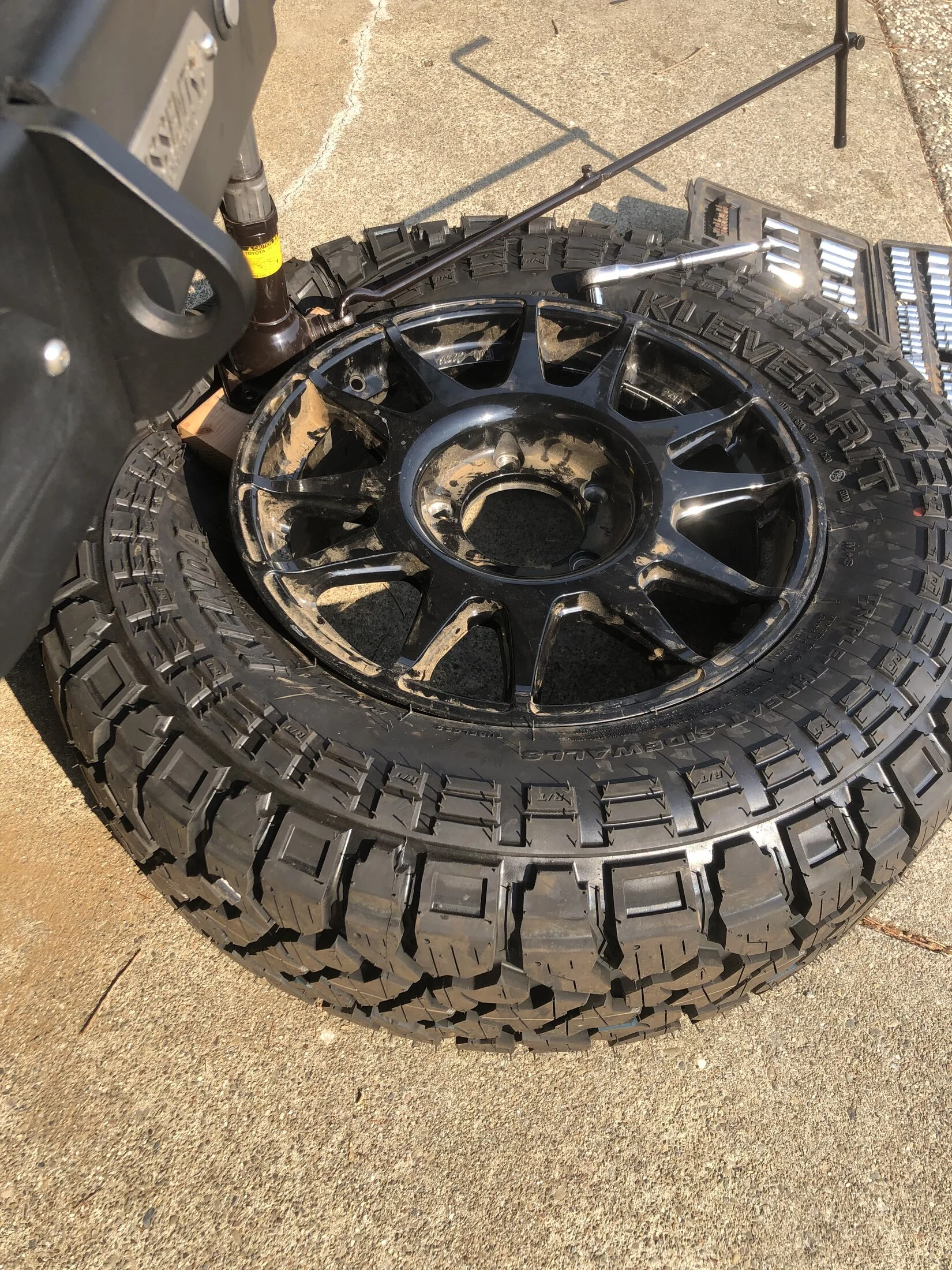

So . . . I wanted the tpms sensor out of this tire. I read you could pop the bead by just driving over the tire. I’m here to say ‘No’.
Yes , that bead has been lubricated with soapy water. I also spent some time hammering it with a bead slide hammer.
It’s on there. Added an after photo as proof.
Next to try is the jack against the rig method.

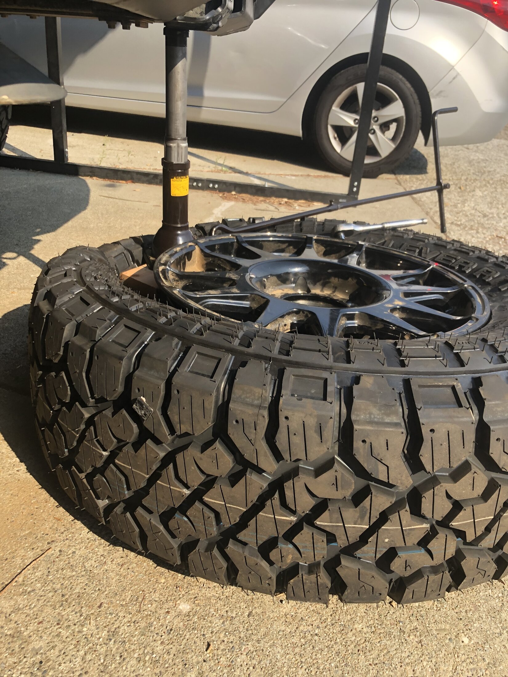

I had success with the bottle jack and put it between the rear bumper (Dissent) and the downward pressure got the bead popped pretty quickly. I used my 18v impact and jammed a socket onto the jack to rapidly extend it.

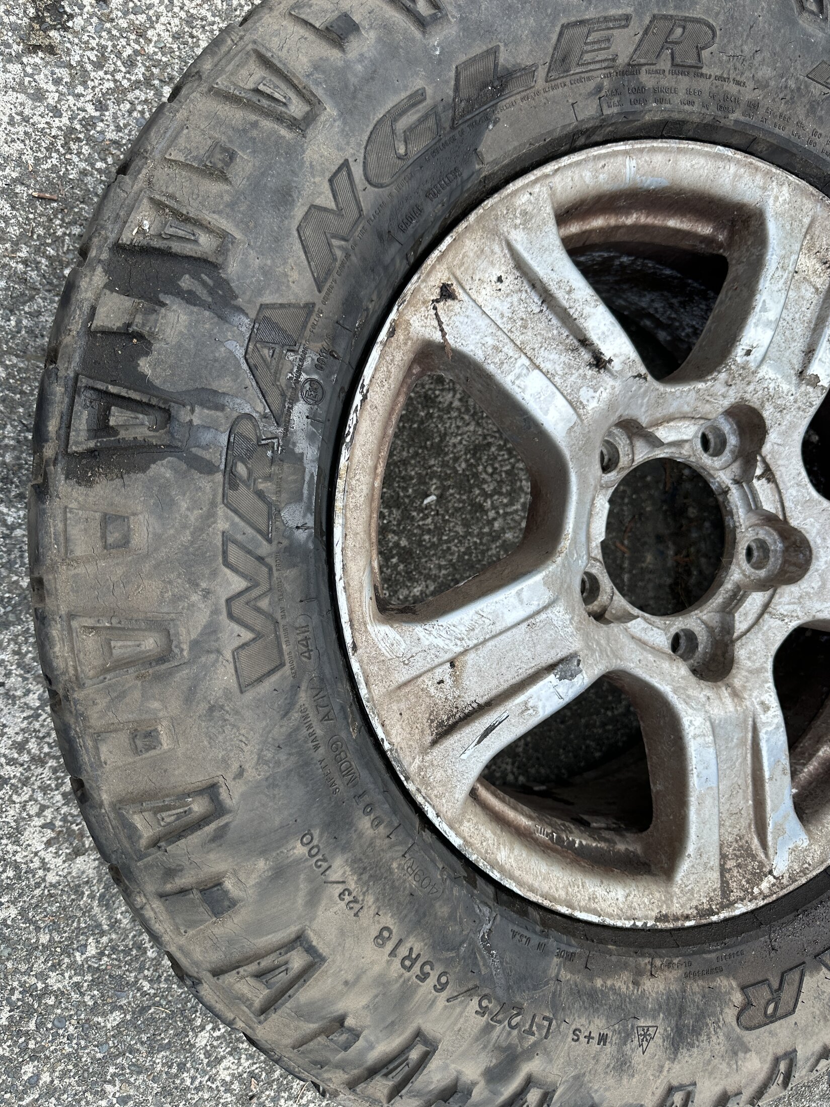

Current situation the tire is completely dry rotted and I still can’t get the bead. Will be jacking it under the rig next.

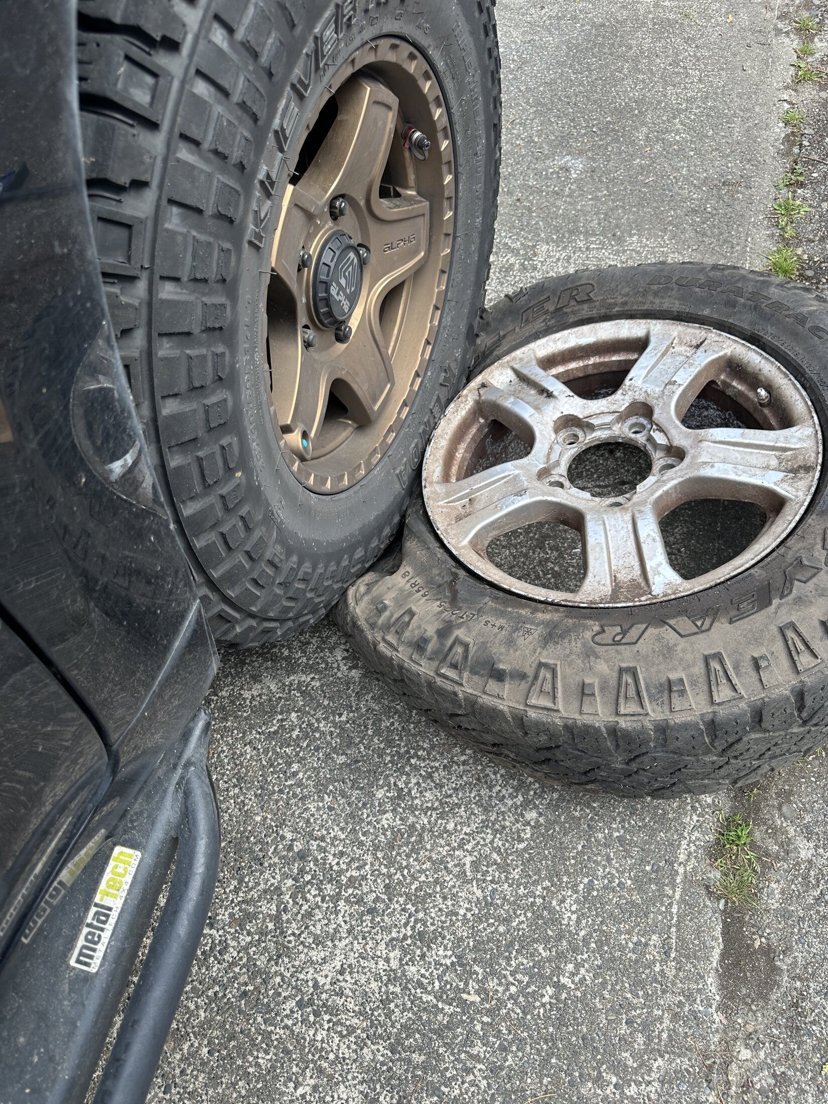

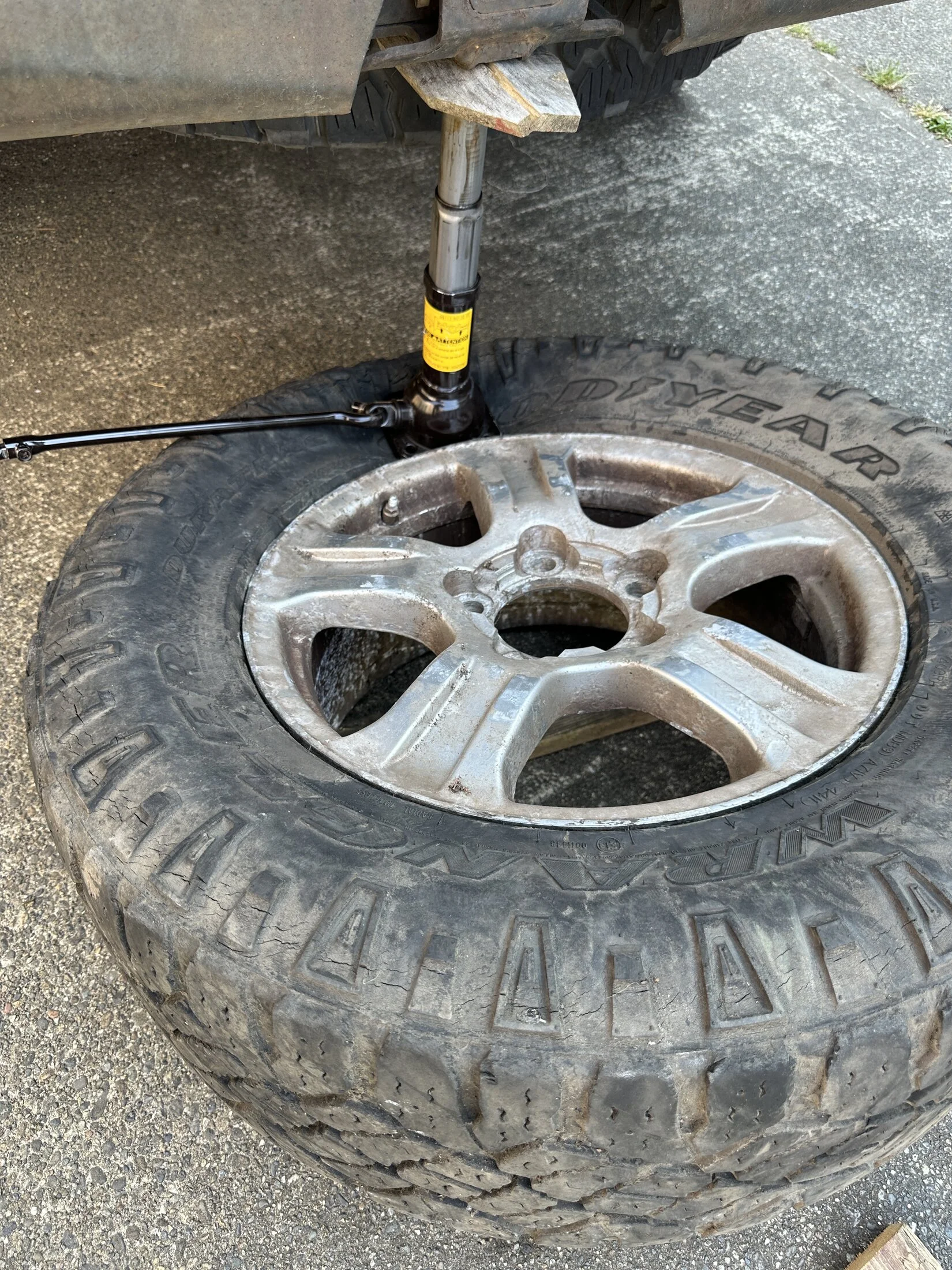

Here’s the jacking under rig bead breaking
Rim on a 2x4 under the jacking point
Jack under the tow crossmember. I used a random scrap to avoid metal on metal.
The tire tended to tip up opposite the jack.
I ran it pretty high, no dice.
Jumped on the tire and gave it 25 pumps. No change
Ran the jack up even more. It was looking pretty sketchy.
Jump / pump the tire about 20 more pumps. Bead finally gave. Pulled the tire sensor I was after.
jack was then a fiddle to extract, mostly as the hook was misaligning every rotation.
Mission successful :banana: . Sketch factor high.
I finally spent some time looking into the electrical on the charcoal canister. It was indeed a broken connection at a soldered joint. Resoldered. Have it plugged in again, will see if I continue to get the recurring self check errors.

Fix confirmed on charcoal canister wiring. No fail codes since then:
