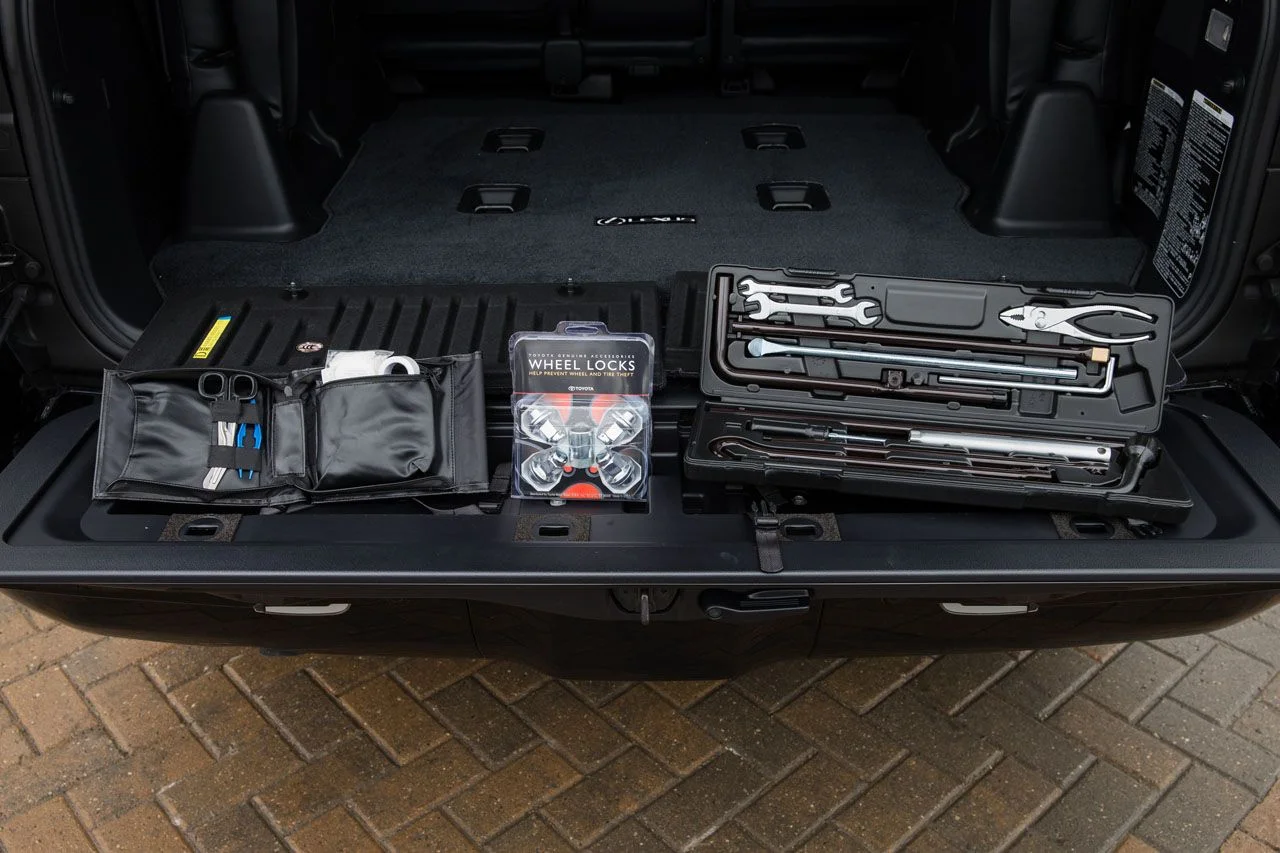

Does anyone know the part number of the toolkit that comes in the bottom half of the rear door? It's the item on the right here:
I have one. I'm looking for another to cut hollow, foam line, and put a few tools in.
I searched the FSM but didn't have the magic finder's touch.

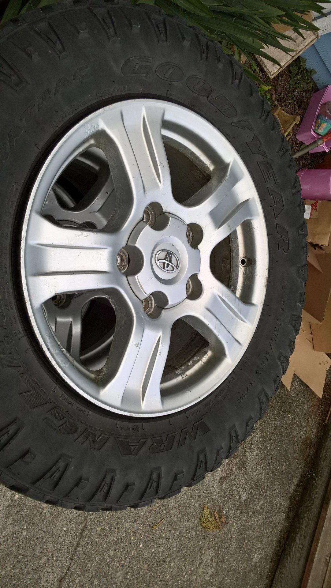

Bought another four tires and rims today, these look to still have the TPMS in them. So now I have 8 matching rims. 4 are 4/5, 1 is 3/5, and 3 are 1/5.
I got a little pancake compressor to sandblast with, but in reading discovered it was WAY to small (2.5 vs 14 cfm). Returned that.
Not sure how I'm going to get the paint off the 4 rims to refinish, I can't use strippers . . .
Spent a few hours cleaning up a 2009 netbook to host techstream, and got the dongle and techstream working. Pulled the current TPMS sensor ids from the TPMS page. Not sure yet how I'll get the sensor ids from the used tires, I may have to go pay a shop to do that. Can they be discovered by sniffer or do the tires have to be unmounted to get the codes off the TPMS units? A bother either way.
Here is the stack of M/T and the best of the four rims.
Not pictured the other four which have good tread Michelin P rated LTX on them.
I'll have to give old Les a call. There is one close to me. Thanks for the tip!
Les proved not to have in house sandblasting. They also wanted $20 a wheel to break the bead and pull the sensor IDs. So I ordered a cheap TPMS computer. Then I ordered some tire irons.
With 13 tires in house, that was a lot of $20s to save . . .
Problem 1: Tundra sensors don't work. This is known. I can resell them . . .
Problem 2: My sledge couldn't break the bead. Enter the floor jack, tie down bead breaking method pictured here
It takes about 1 min per side, and all the sweating is in flipping these dang LT tires.
Getting the rim out is another story.
