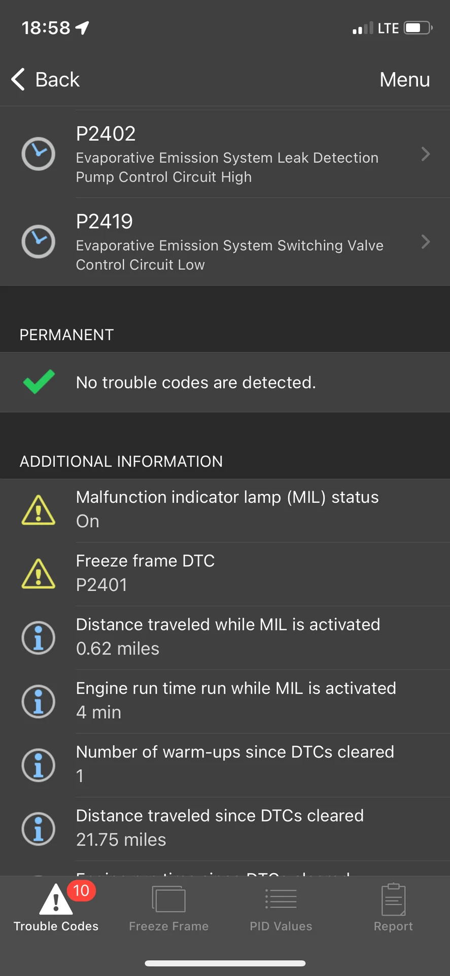

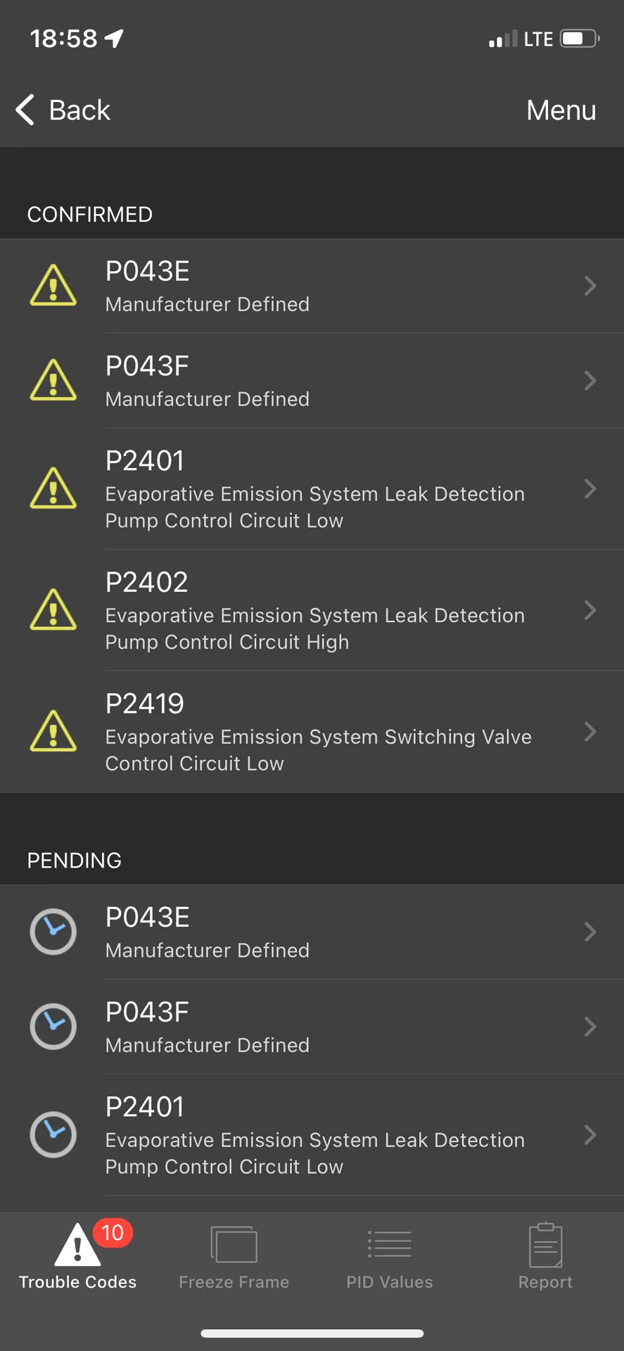

The plot thickens with the 4lo codes.
First, I am getting recurring evap codes. This means when I last moved the canister (a few weeks ago), something didn’t get put back happy. Prime candidates are the evap in pipe (broke a clip), and the plug in (moved to a new orientation).
That explains the check engine light.
On the 4lo, it is engaging, and throwing an error on disengage. That error isn’t registered as a code, but shows ABS solid, 4lo blinking, and then the triangle light.
I was smart enough to screenshot the evap codes.
Fun times!

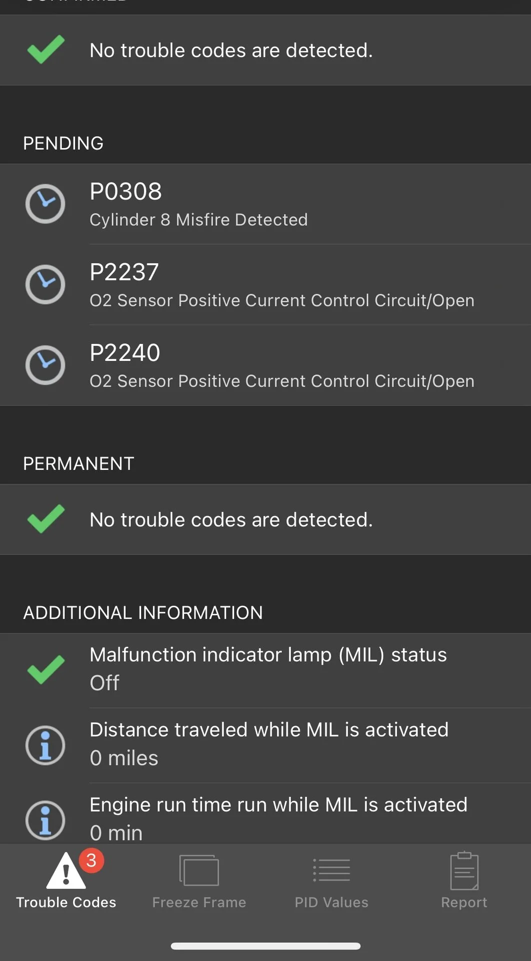

dropped a cylinder on the commute this morning. Was halfway so went ahead and got to the office.
Cylinder 8 went out after about 10 min, around 25mph, on a normal acceleration. No bangs or noise other than the rough running and lack of power post event. Was immediately noticeable and got a variety of dash orange lights. Cylinder was out the remaining 20 min drive.
Company is in a busy place at the moment so no chance to look under the hood yet.
Hoping for a chewed thru ignition wire. But it’s probably something more insidious.
The O2 sensor, coil, and plug are about 9 months old.
Restart at lunch cylinder is back.
All I did was jiggle wires to the coil. All looks intact.
Here’s the dtc I got. During the drive the order was
Misfire on 8
Then the o2 sensor
When cleared the o2 sensor came back.
Didn’t see the misfire again until I parked at work and was idling in the lot.
After clearing in the lot all three came back immediately.
Right now no codes and engines warm. Spirited throttle in park didn’t create a code.
No root cause yet.
I had this happen but was less abrupt. Had a couple intermittent but hard misses that I actually though was torque converter but it ended up being #8 coil. Never what got a code though.
Have a spare coil (kept 2 after the swap), may toss one in the box in case it happens again. #8 isn’t great to change on the go, but we’re there is a will there’s a way
Another 25 miles of mixed driving to get home. Nary a stutter light or issue.
I guess computer glitch until it happens again
