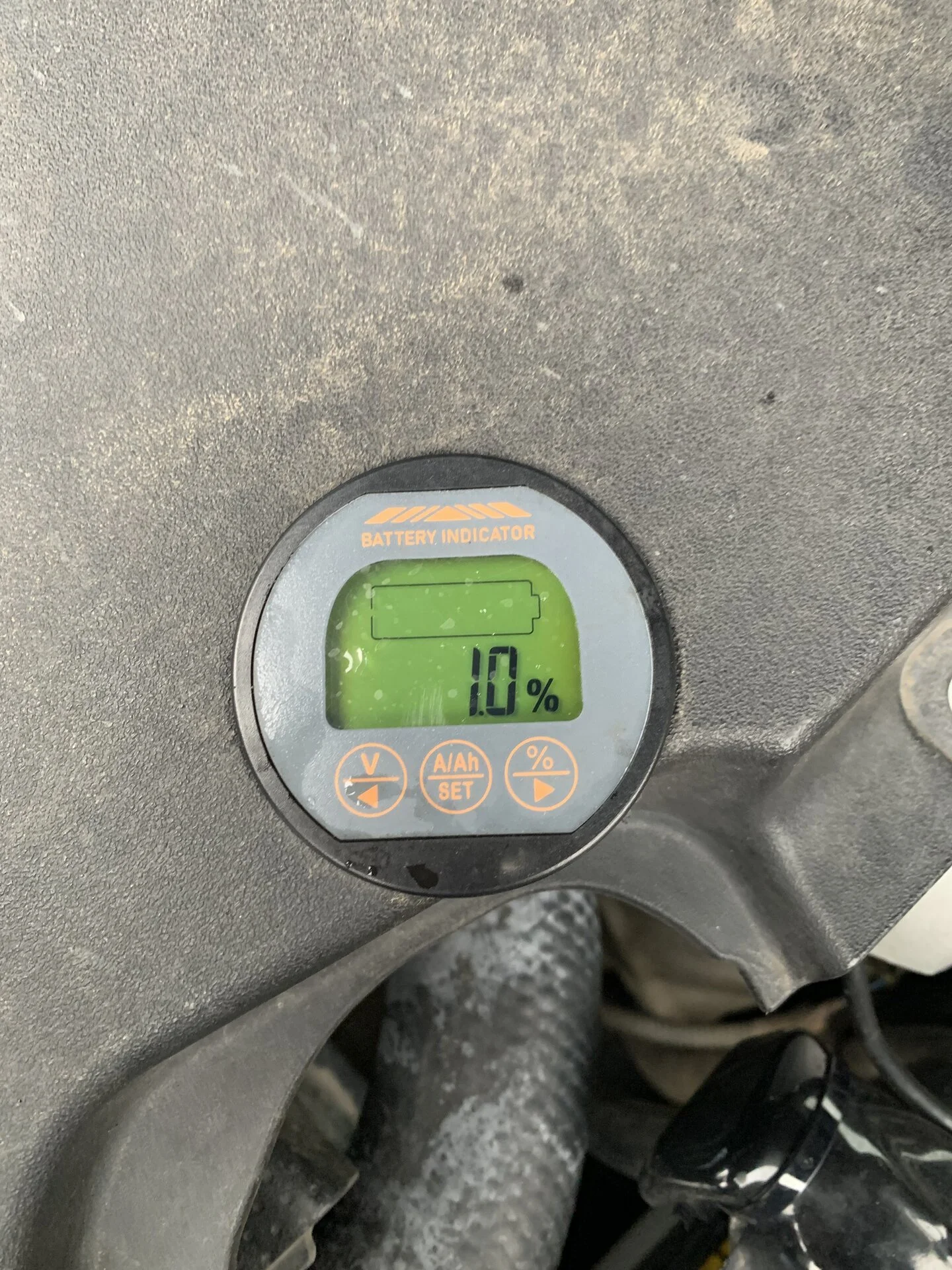

This is what has my interest. This gauge always shows a current flow into the battery when the car is running . It should also be around 100%. Today it’s showing no flow. If I put an external battery on it I get inflow.
Voltages are correct, but I’m becoming concerned for the alternator .
Another source of this being zero would be the BMS on the lion in shutdown mode.

Ok. So one end of the cables from the parallel batt at the Bart are 13.3.
The other end at the ultracap is 0ish.
So I’ve got an open at a connector/crimp or in the power resistor.
Should be simple to get that resolved
