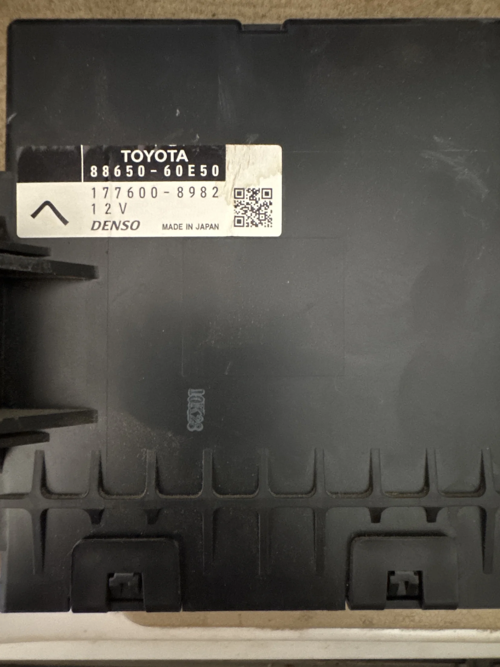

I’d say pretty low. A quick search shows it’s rare in the 200 series. If it’s easy and cheap, I suppose you could fire the parts cannon and try one. There’s probably a test procedure for the amp in the FSM?

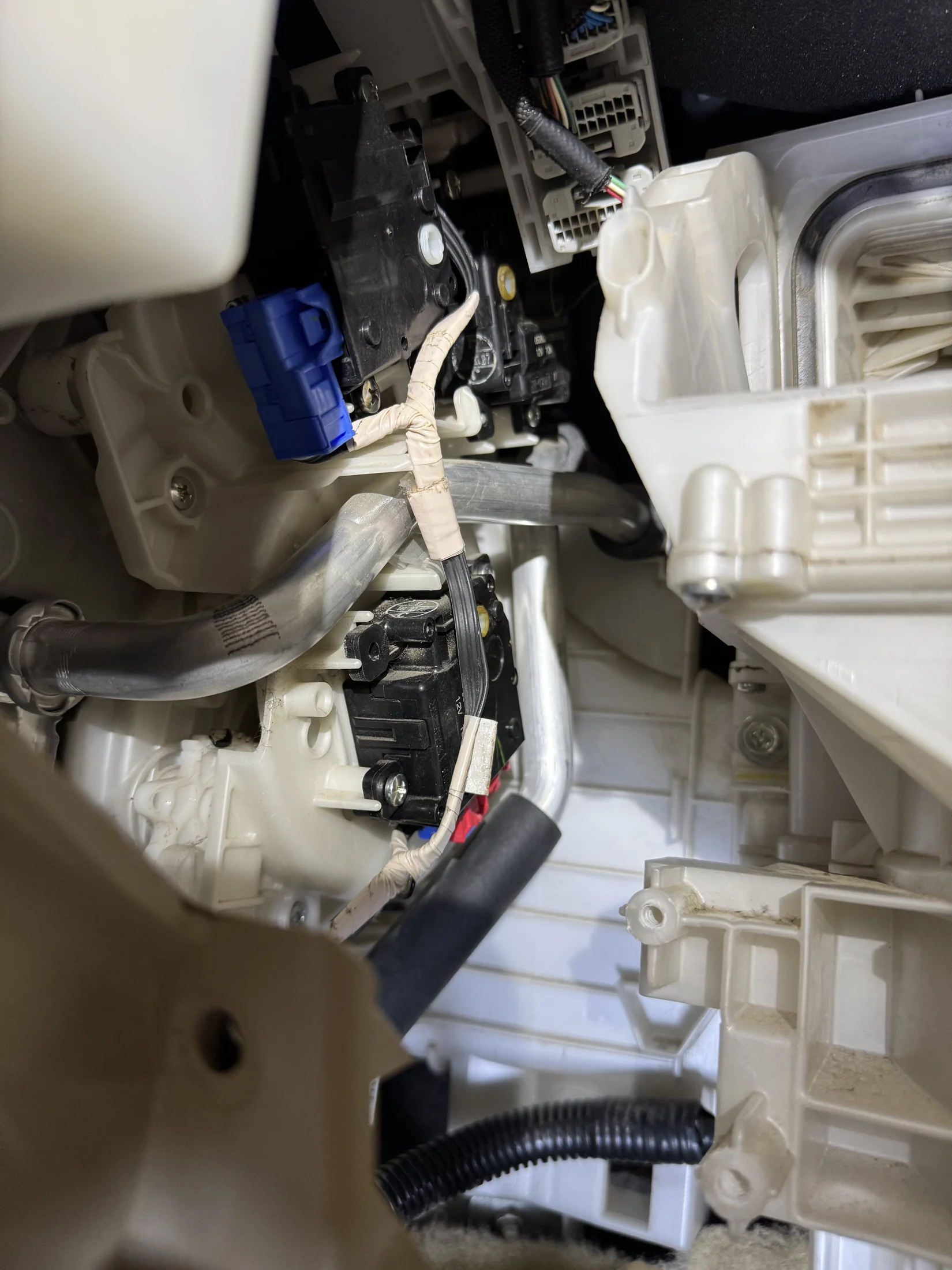

You have to remove the glove box, then remove the vent going to the foot area and the HVAC amplifier. You’ll be able to see all three at that point. Getting to them is still a pain though. They’re all three 06800-1030 on my older rig. In the link above they’ve got a different part number and it seems like Toyota recommends replacing as an assembly and not just a single.

Glad to hear it's all working now. Did you take some more pics?
Unfortunately that is the best picture I got. You can see all three servos there, and the lack of space.
I will say, if you've got B1441 replace the bottom, B1445 the on closest to the firewall, and B1448 should be the one closest to the console.
