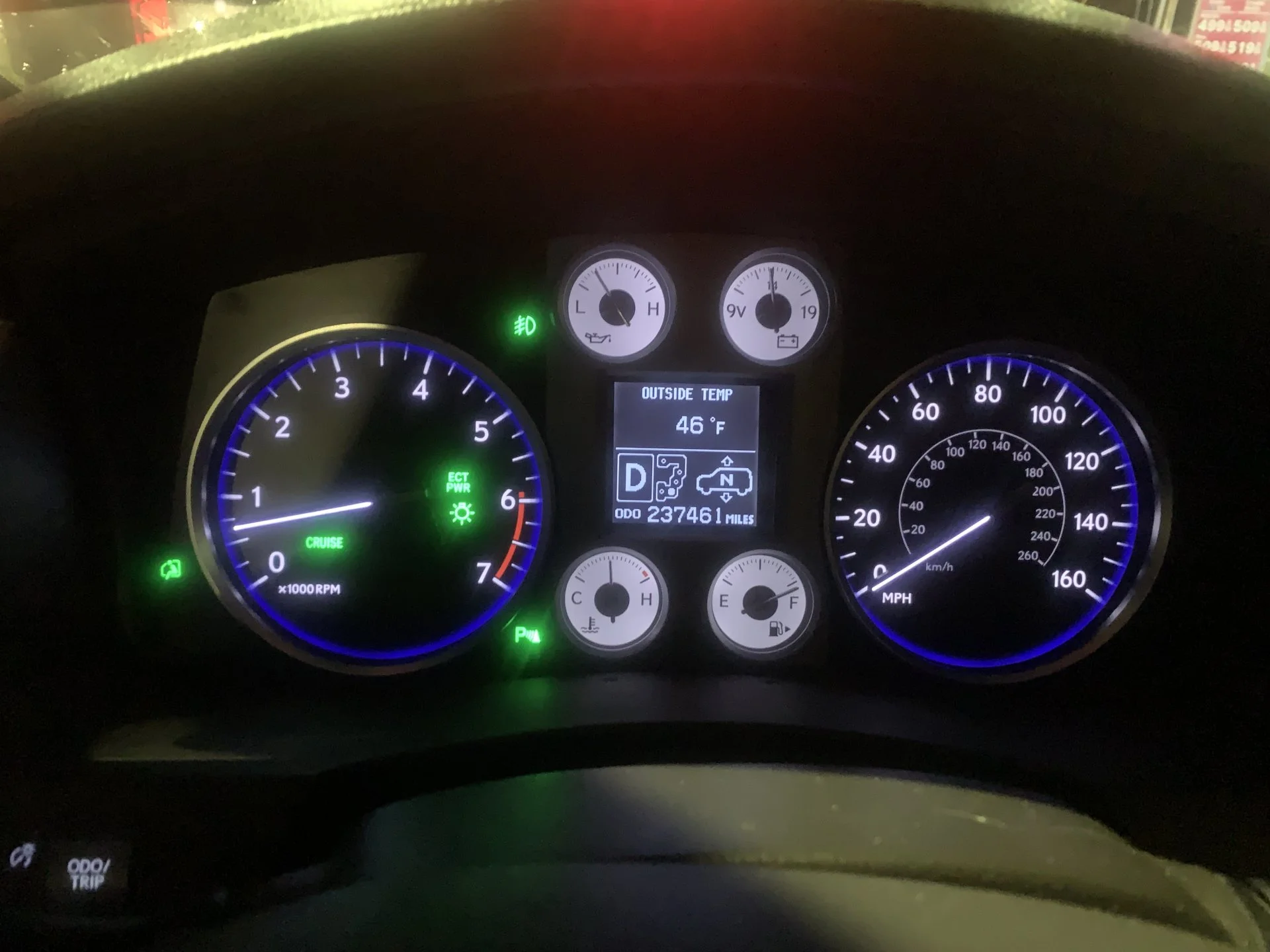

Missing eco indicator. Cmon bro. Do you even unnecessary green light?
Oh I hate them. But then decided to see how many I could turn on. I don’t think exo is a thing on the 2009. How do you achieve it?
Mine is in the meter menu in dash. “Eco indicator” on/off. Pretty sure you have it to, as I remember @bloc commenting on it.
It does nothing but i had hoped it indicated TC lock. Maybe theres a way to bypass that into the light somehow and make it useful.

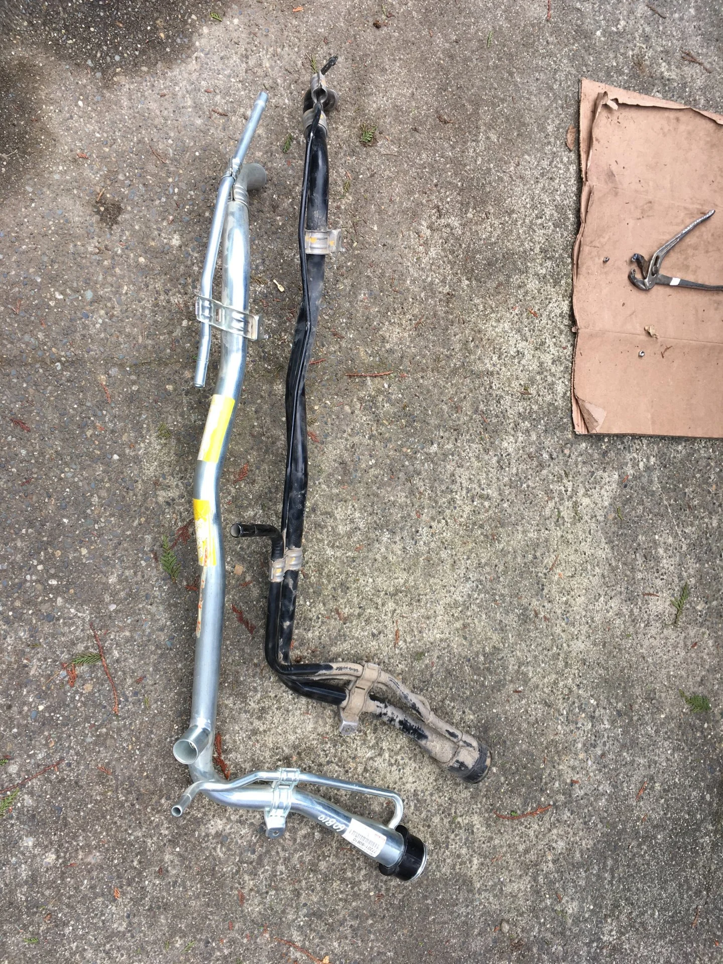

Yes, I think it's a possible to mod the OEM filler. I have one here if you want a core, you could then pass yours on as a core to others.
In the comparison photo, new is silver, OEM single tank is black.
The changes would be:
Add a sub tank fill bung
Add a sub tank vent line behind the cap (or tee into the current vent line, which would be way easier)
Cut off the upper vent line used previously by the charcoal canister (it vents to atmosphere, not behind the cap). I guess this is optional.
