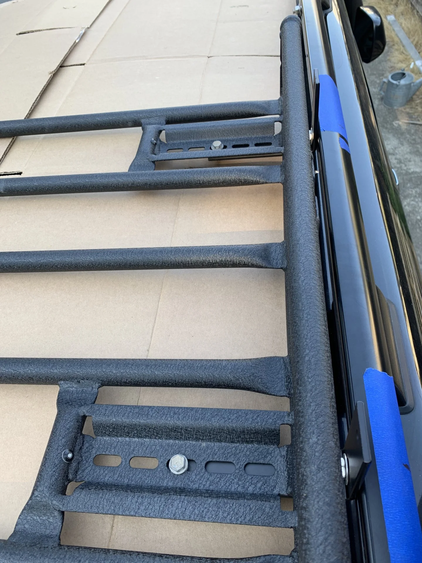

Started working on adapting a new roof basket to replace my crossbars.
Still fiddling with rail mounted brackets, but may pull the rails and build some feet instead.

Cooked up four brackets today. Works pretty well. Not even final tightened and solid as can be.
The corner brackets will be identical, but will have additional bar running out ahead, behind the rails to the rack foot location.
I do plan to lop the short side off the bracket, and prime and paint them before final fitment.
All the brackets wrapped up. Layed in a supply of 5/8” washers so I can shin them to get the rack ‘flat’ (the oem rails are arcish)
Here’s the primer coat, finish coat similar, but in black.
Only had to extend the rear mount point on the rack, the front is right at the end of the rail, like it was made for it
