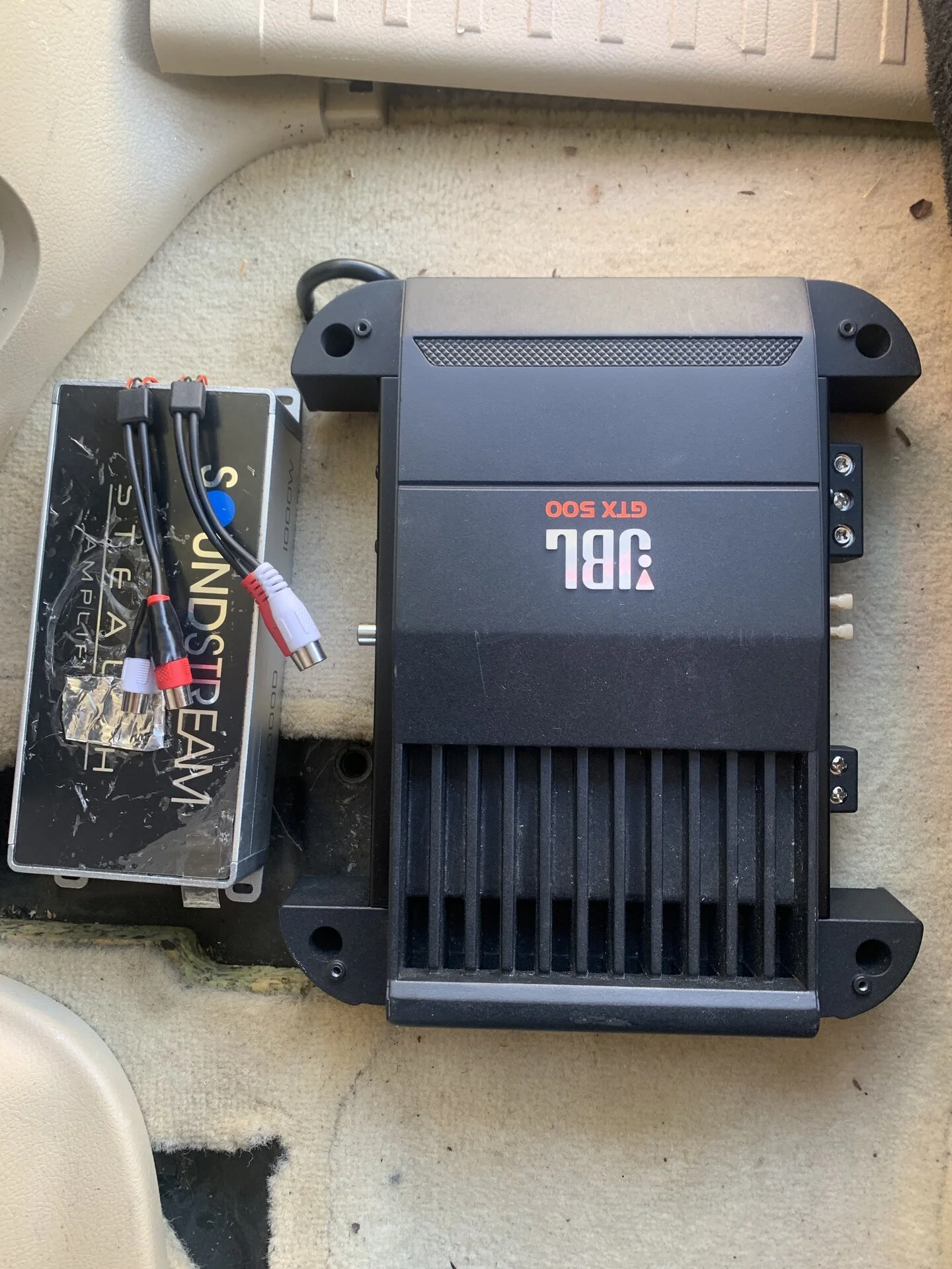

Been working on upgrading the subwoofer amp. Previous amp was a 4ch running a dvc sub with one coil per 2 ch. pretty suboptimal, set for 200w, which was sub rms. Picked up an old jbl 500 from an internet pawnshop. Even running my sub serial I’ll have around 300w rms, and more if I move to parallel. I don’t really have the cabling back there for the parallel demand anyhow.
Not much to see, used all the same wiring that was already pictured earlier in the thread.

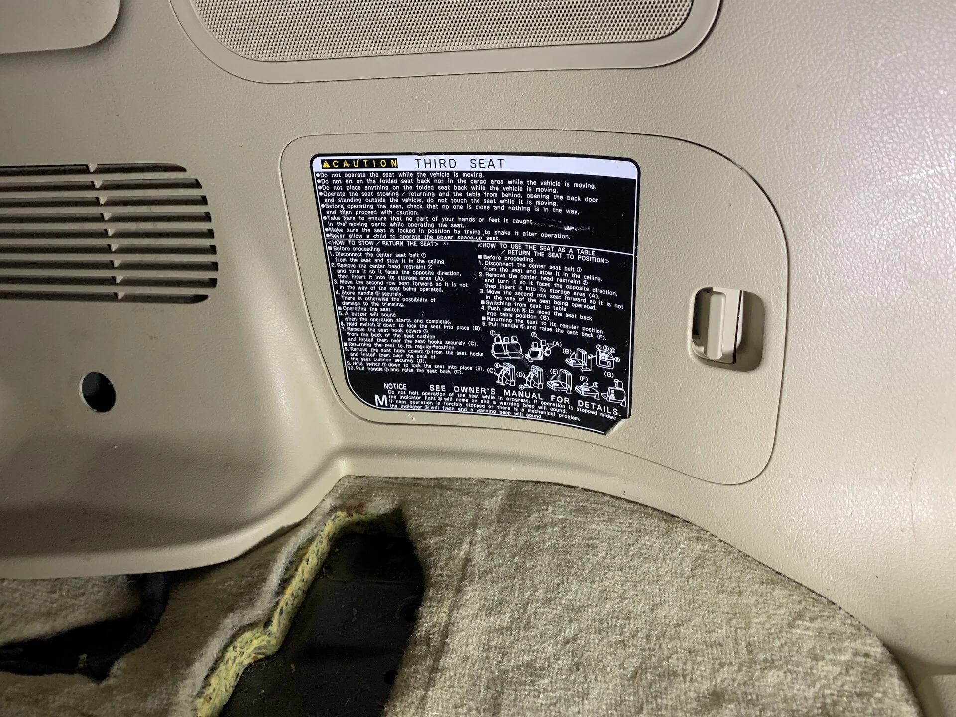

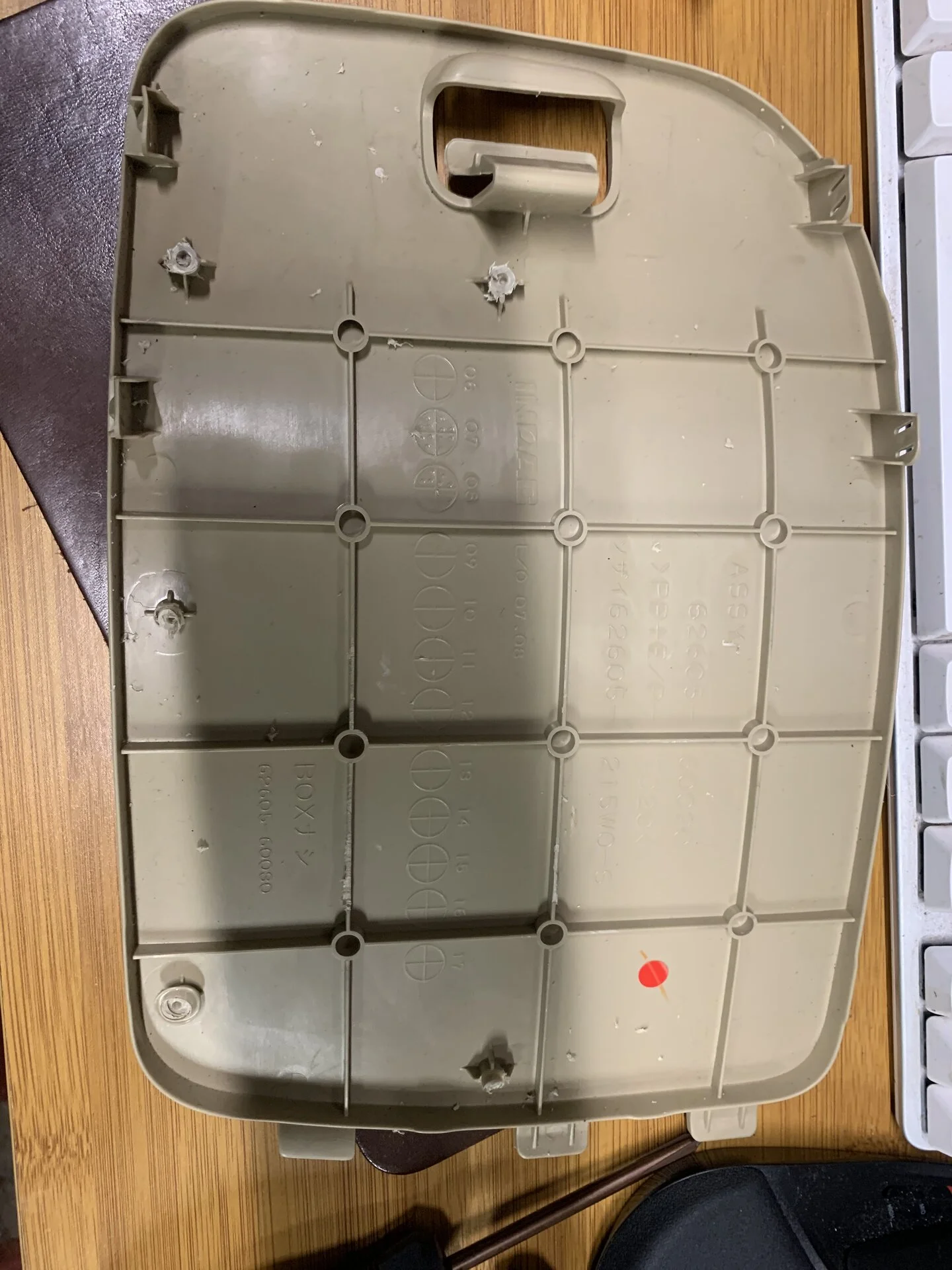

Moved the jack into the drawer as the sub amp was blocking it. Drilled out the plastic rivets on the door to pop the rear cubby off.
Gain set by oscilloscope, but I can reach it in the install so can adjust easily.

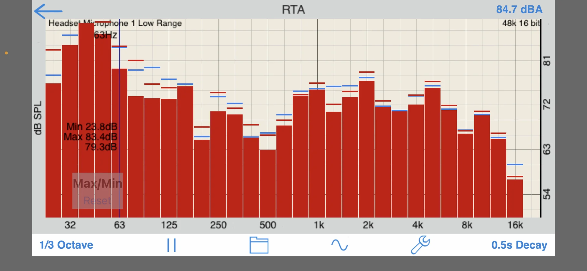

Hope to get to using my new phone based $35 RTA to set a great in car curve. Here’s where it was at before swapping the amp.

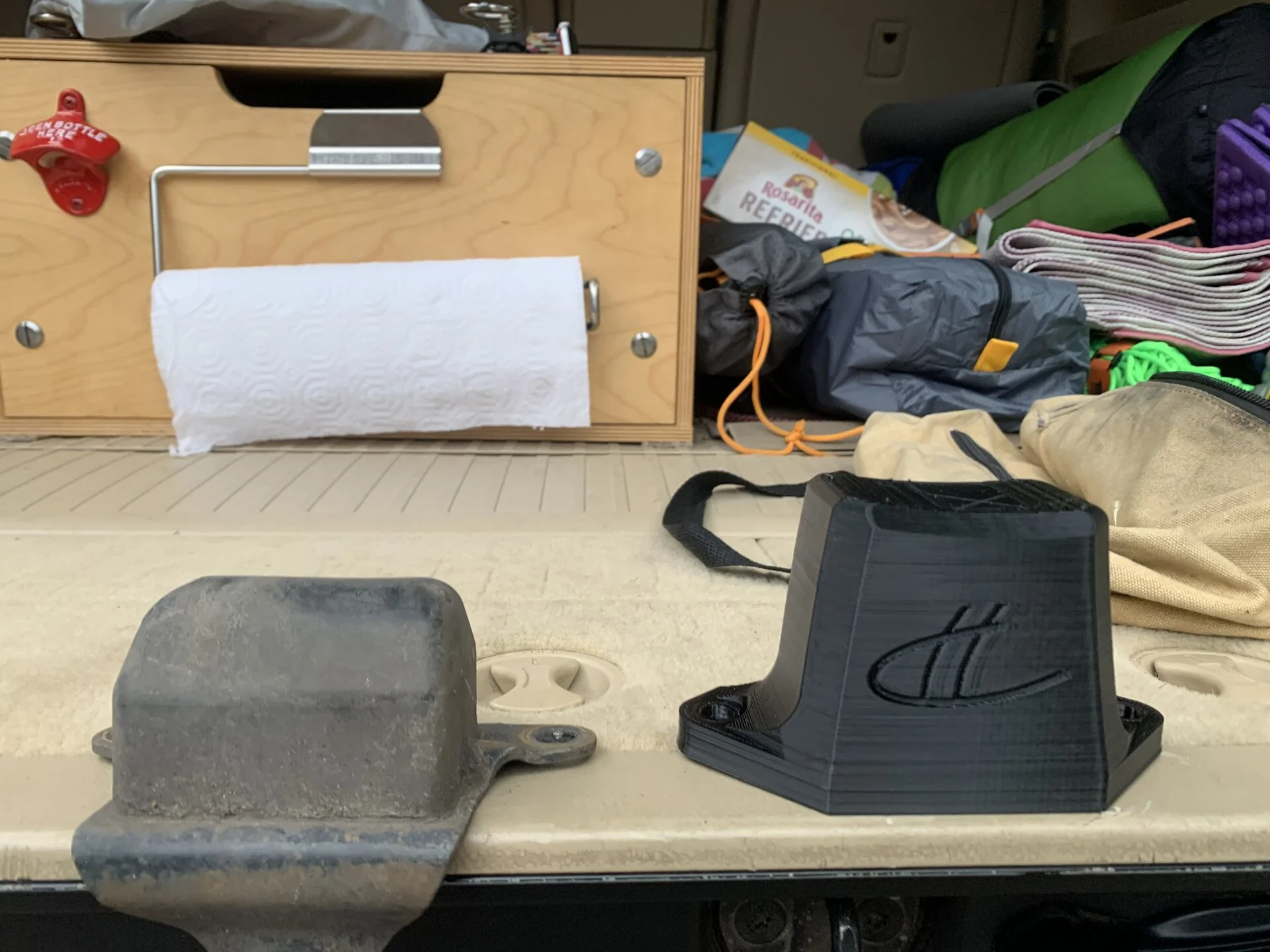

Tried the extended rear bumpstops I got on Black Friday, the holes didn’t line up, about 1/2” too short on the spacing. Have opened conversation with the vendor.

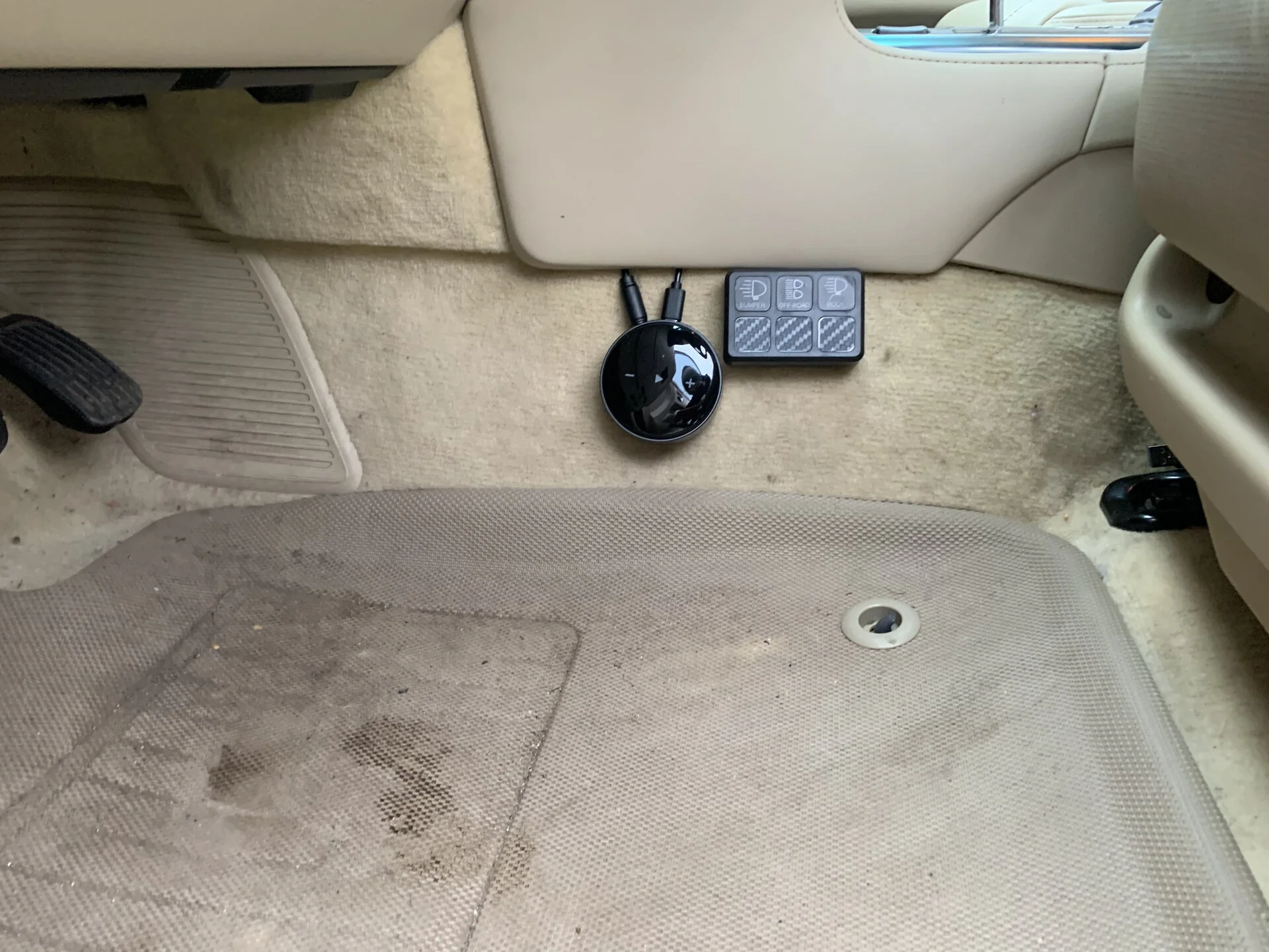

Finished the install on the Wiim. Hardwired a usb jack under the seat to power it. Using the optical out into the alpine dsp. It sounds the same as the connection flakey Alpine Bluetooth dongle to me, which is to say, very good. Ended up hanging it by the connectors with a piece of velcro hook stuck to the back to grab the carpet. Right next to my light control six gang on the transmission tunnel. It might have fit under the seat on the frame, but the thing is round and doesn’t zip tie super well. I think I have some self stick magnets around, when I find those I may stick it to the seat frame.

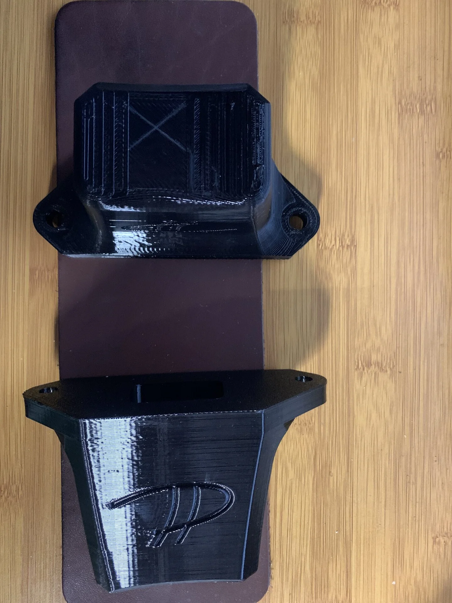

Updated 200 specific rear bumps are in the house.
Has been pleasant working with Perry Parts to get the design updated for our frame.
It’s raining though, so test fit won’t be today.
3” uncompressed.

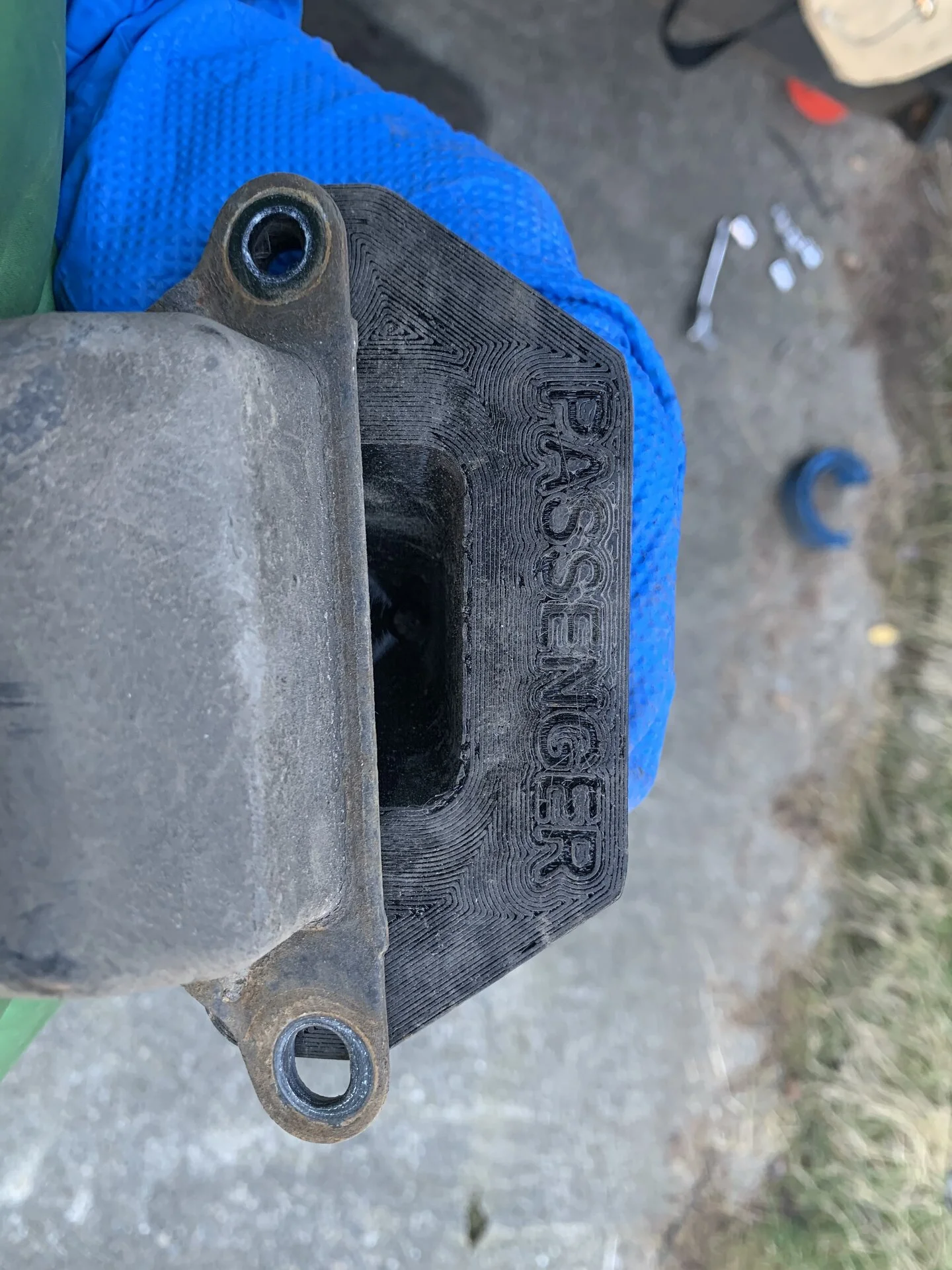

Rear bumps v2 installed. The new format Perry parts cooked up for the 200 fits good.
2 1/4” to axle from the bottom of bump. In N mode if it matters.

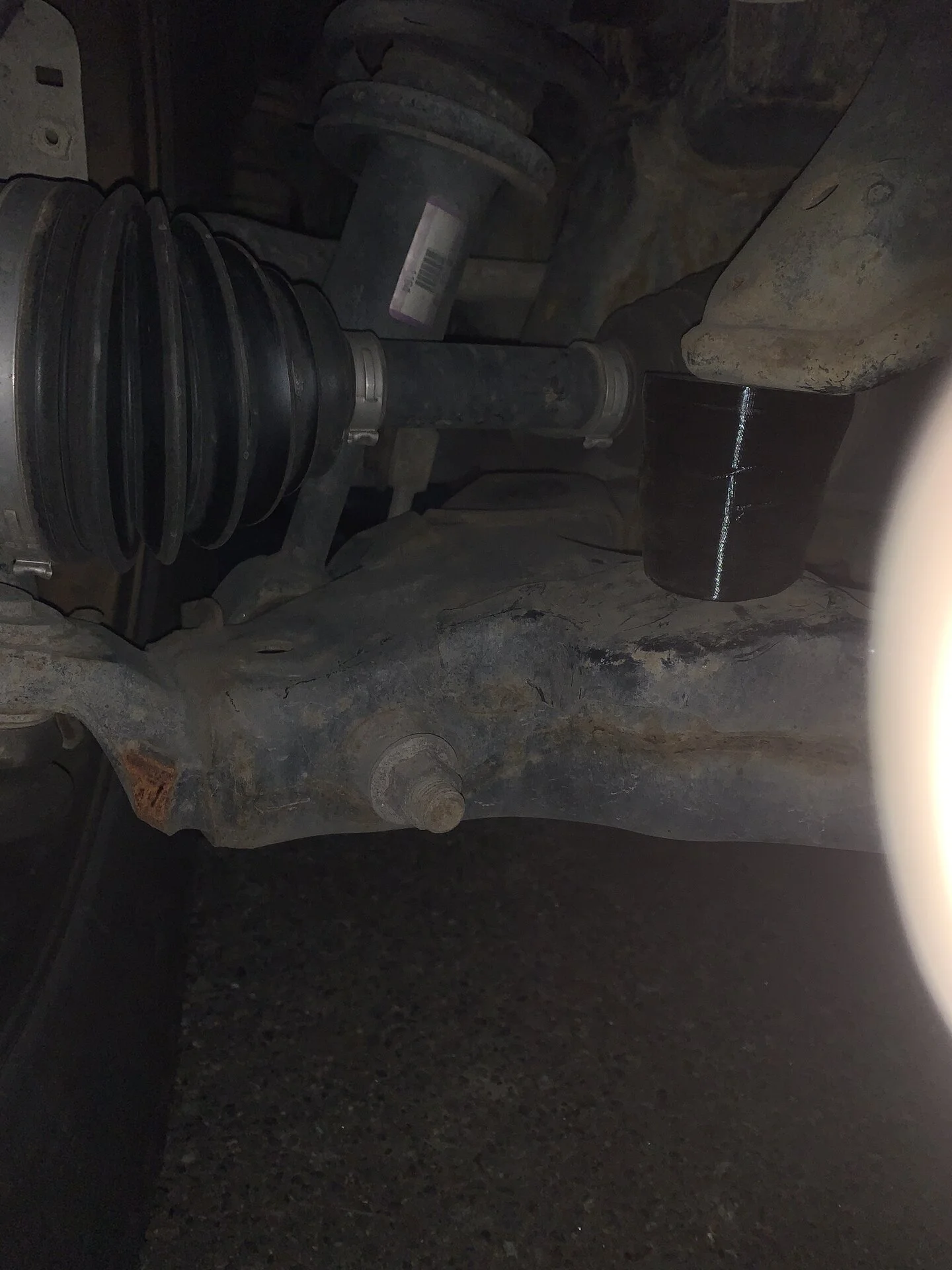

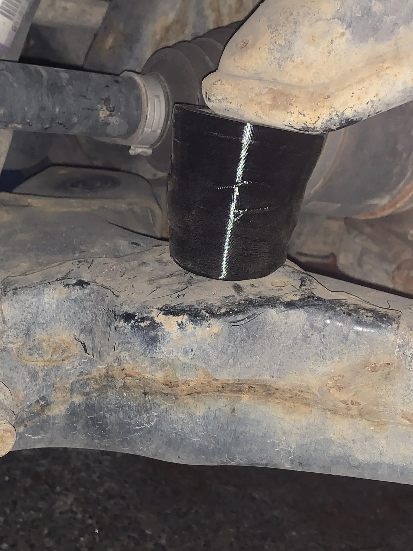

Put one front bump on. It may be a bit tall/long. Q in to the bump master to find out.

Front bump pair on.
Rear of front lca location.
Normal mode
