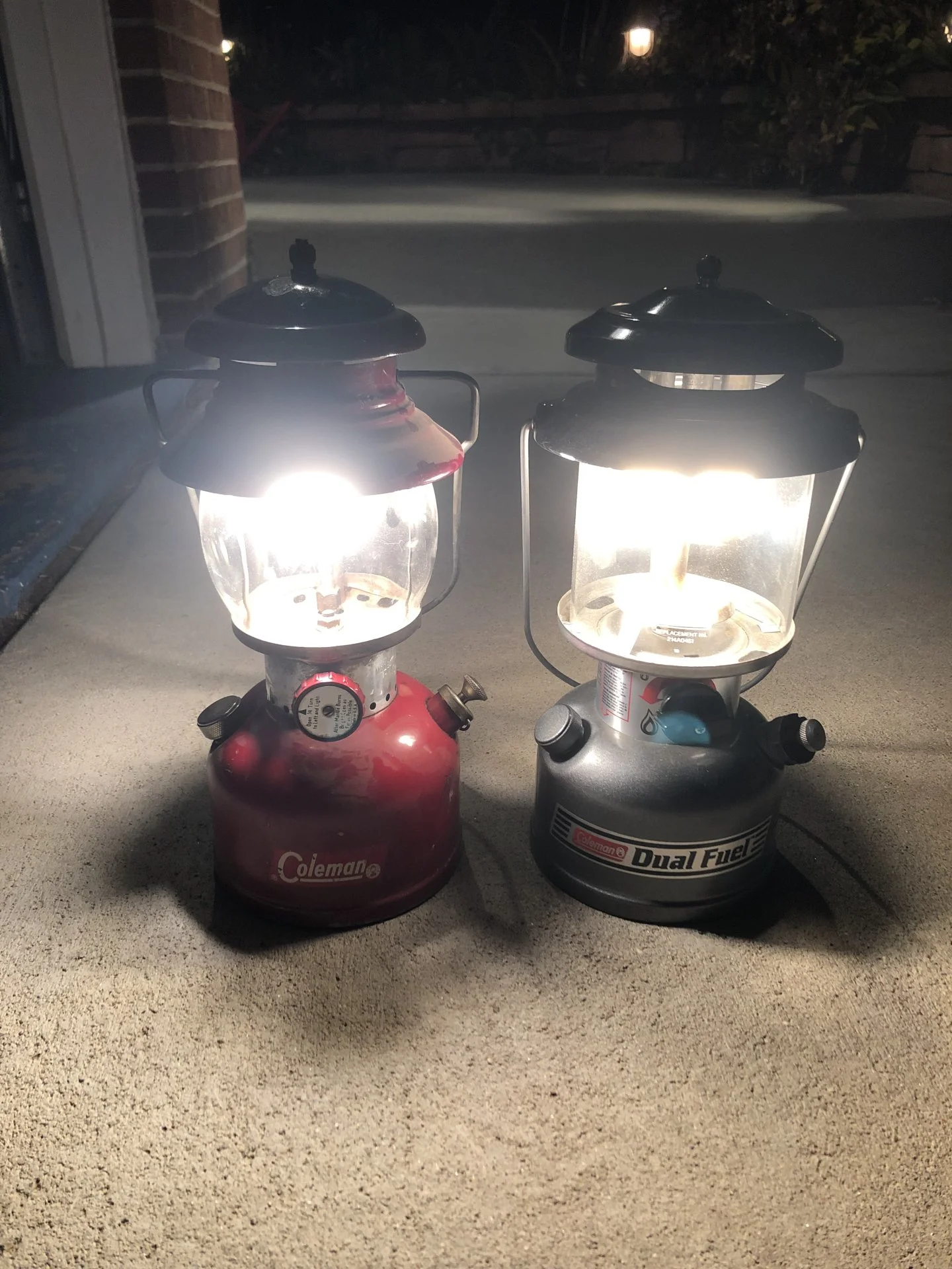

When it’s dark outside it’s time to fire up the lanterns…

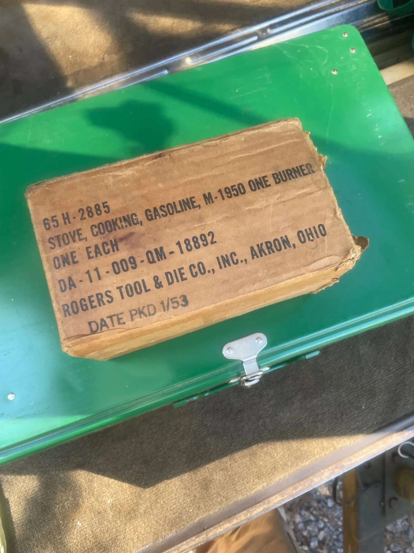

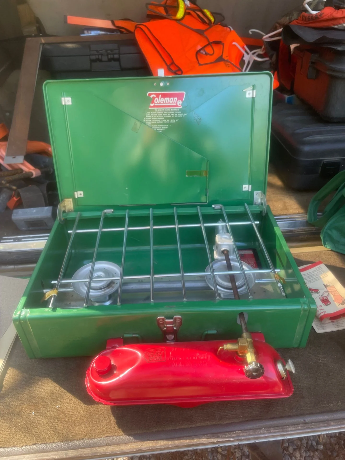

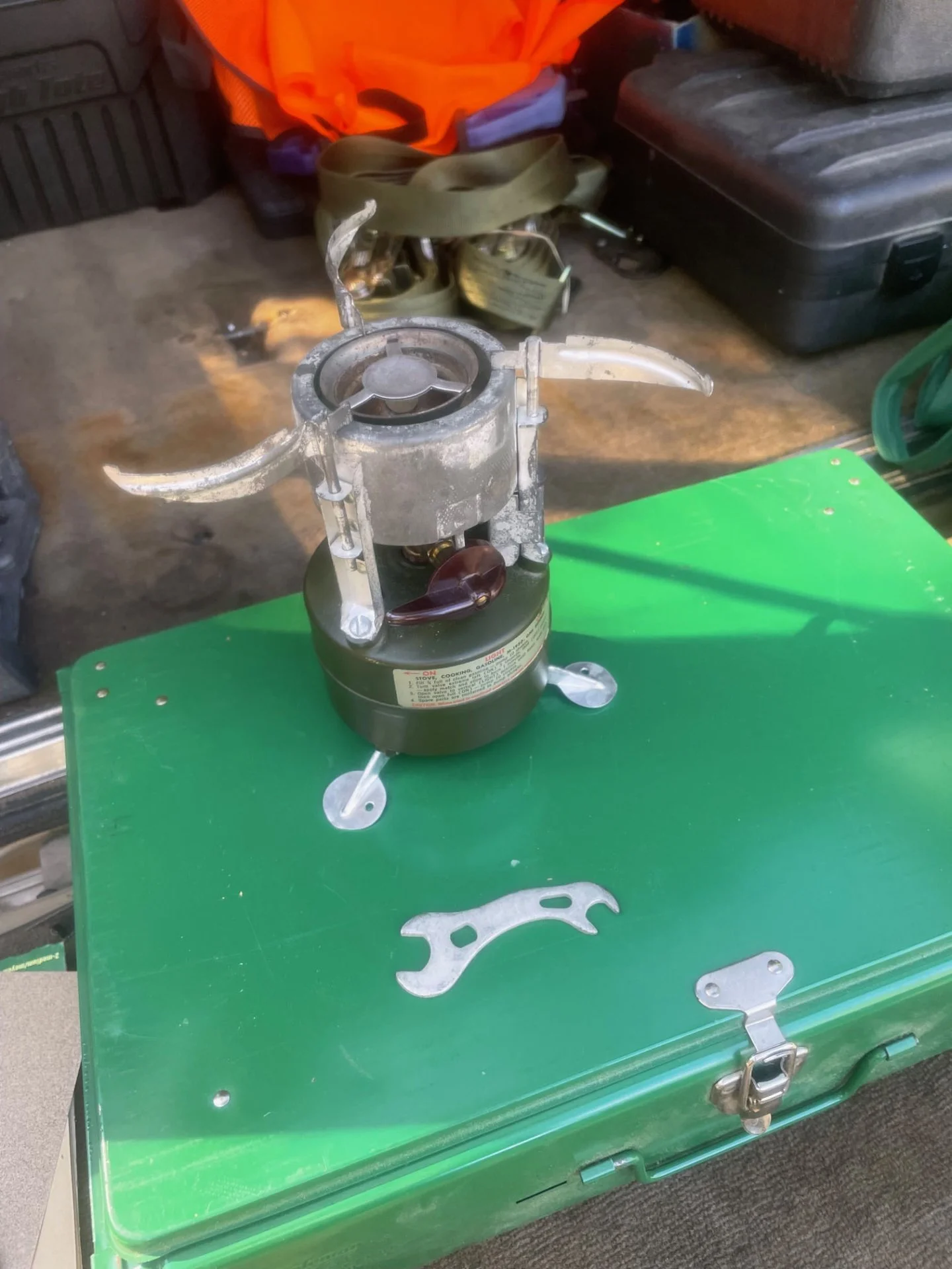

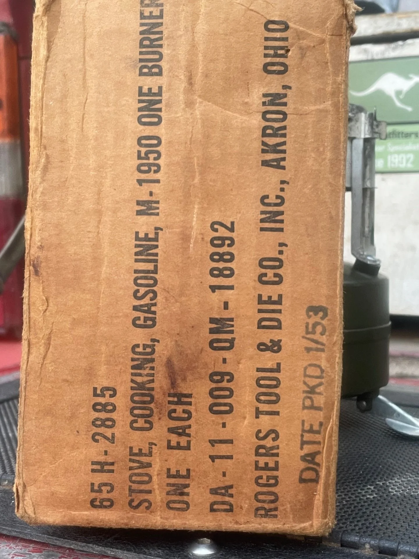

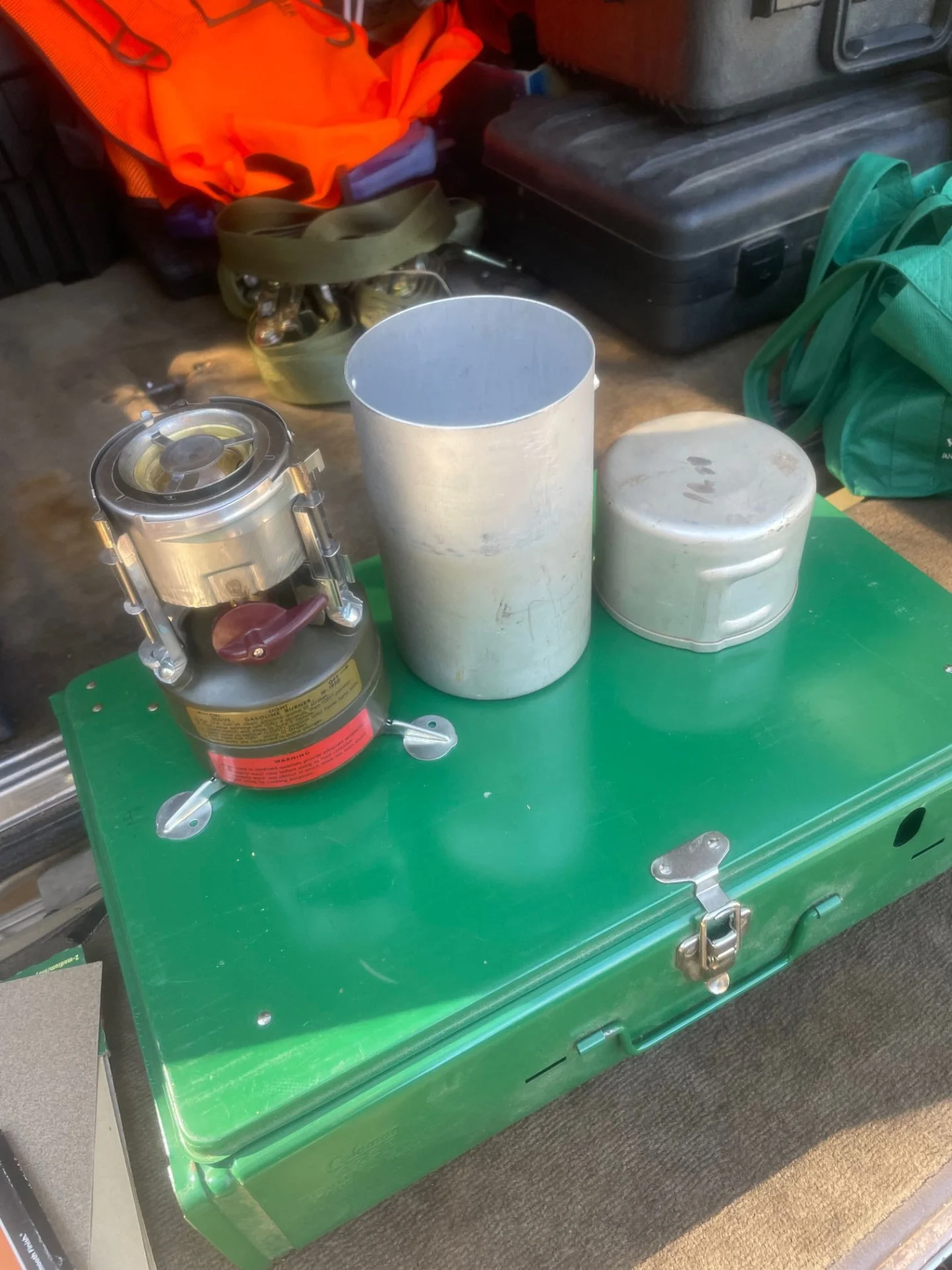

Stove score today with @cruiserinsanity. We picked up an unused Coleman 425 and two military surplus stoves. A 1966 labelled Coleman and unused, and a 1952 labelled Rogers but identical in appearance to the Coleman. The Rogers came with the box and the Coleman with aluminum housing that could serve for heating food and drink.

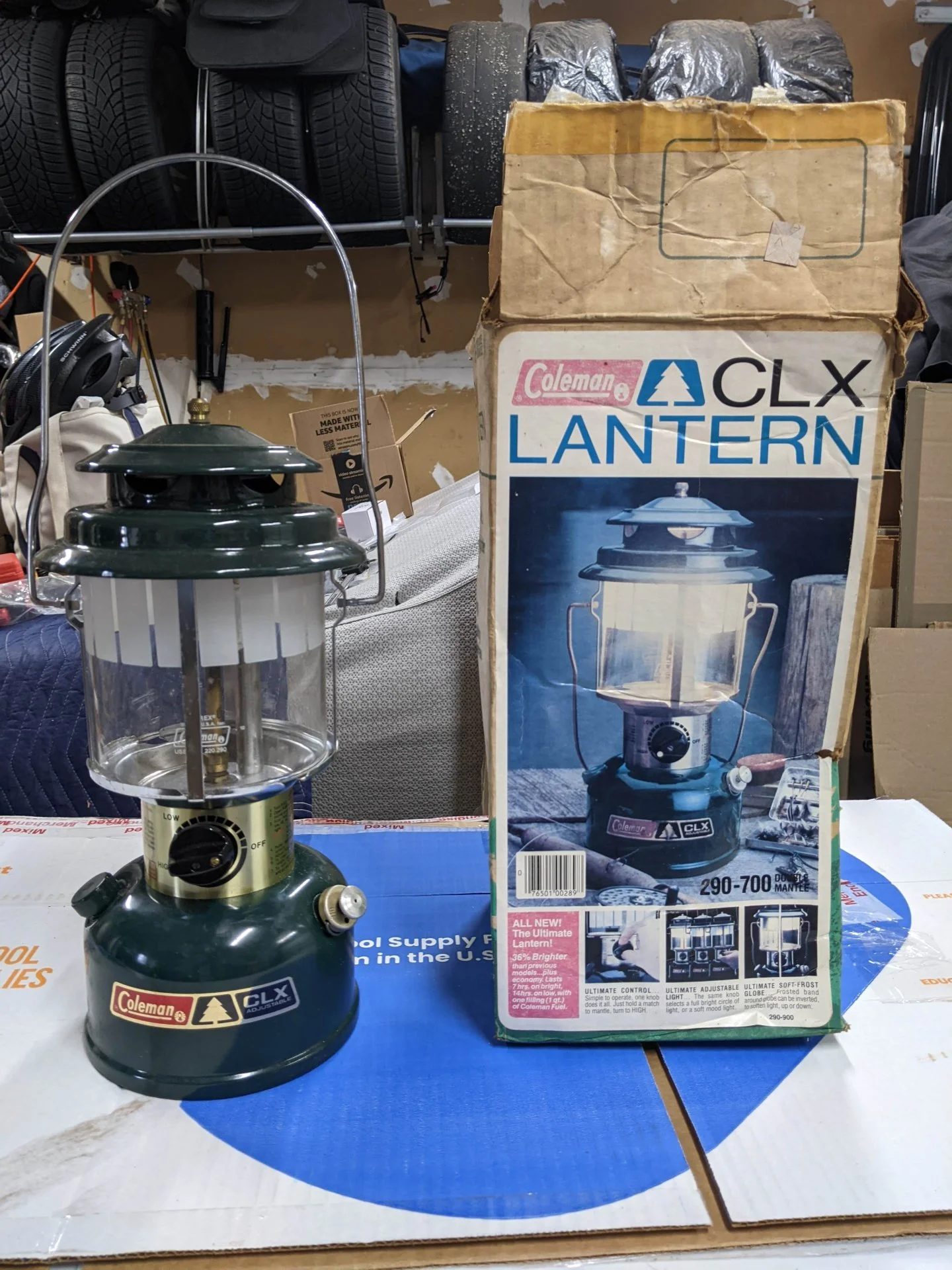

290-700 CLX lantern dated 1984
-a quick test did fire it up, with a bit of "pulsing" maybe. the mantles each have a hole in them. i turned it off. glass rattles but no obvious way to stop that.
-pulled the pump. the pump cup appears to be rubber/plastic vs leather? cap does have an oil hole. probably didn't need to but put some 3-1 oil on it and re-installed. pumping it up, it fails the check valve test i saw on oldtowncoleman. and the cap needs to be tightened down quite a bit to seal.
-i'm thinking i need new mantles, fuel cap, and check valve. maybe a generator, "while i'm in there"?
-i don't have a plastic case, just the cardboard box. ebay for a case or something else?

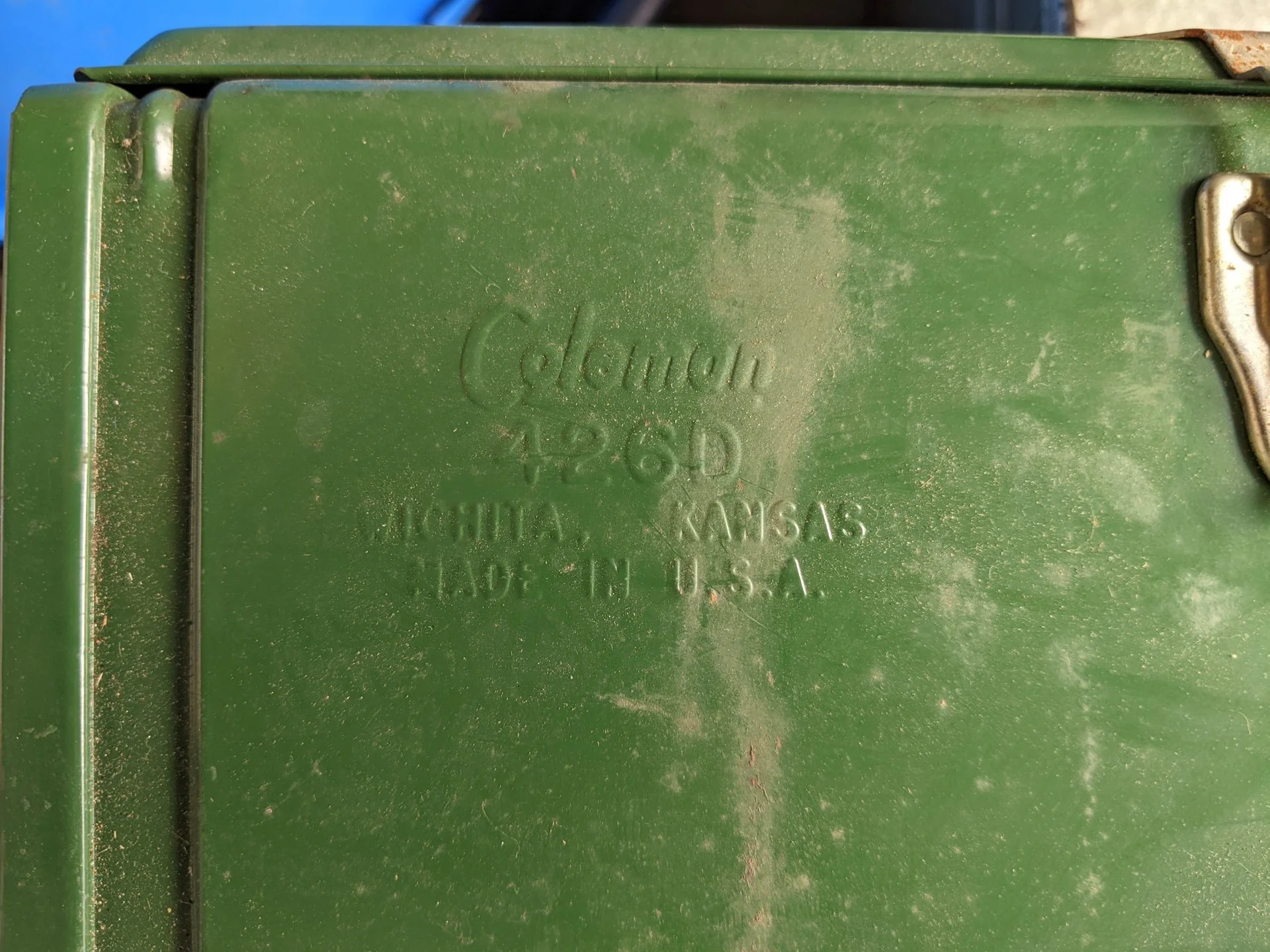

426D stove dated 1978
-a quick test fire got all 3 burners going. middle one is more orange/sooty than the left or right.
-this pump cup appears to be leather. also put some 3-1 oil on it. this one also fails the check valve test, but not as bad as the lantern
-i'm thinking it needs a new fuel cap and check valve. also a generator while i'm in there? can i clean the generator vs replace?

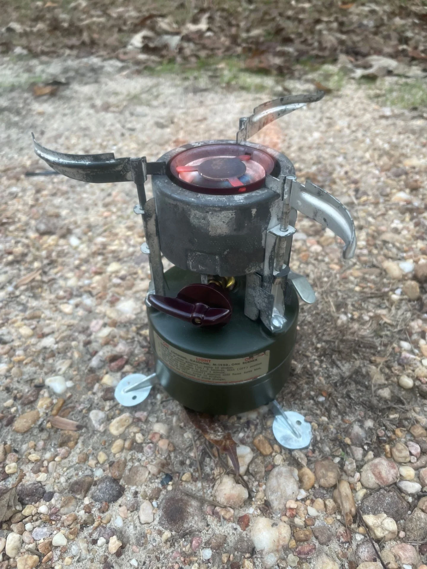

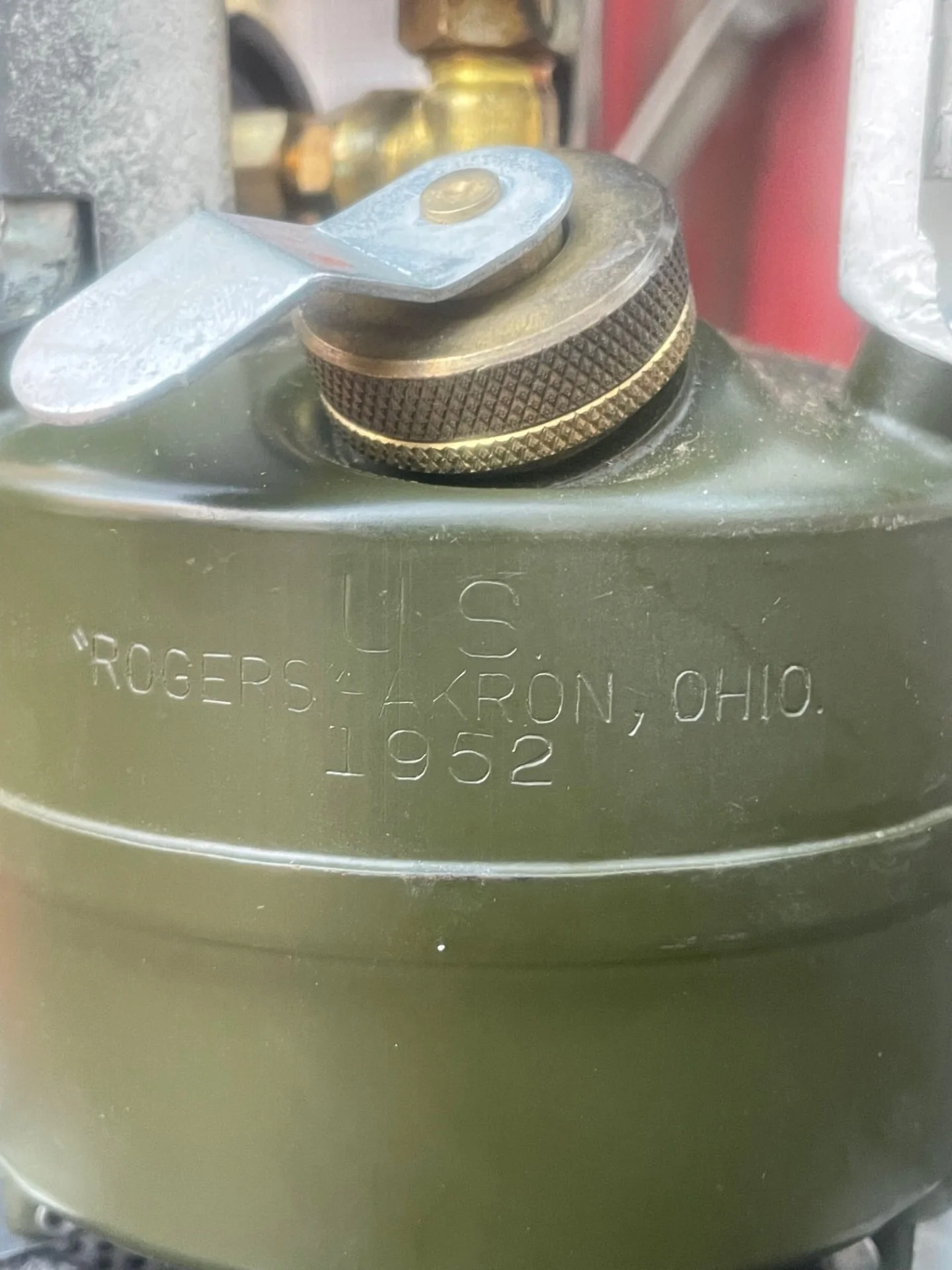

I had to give the 1952 M-1950 stove a trial run. Added fresh white gas, followed the simple lighting instructions and the stove fired up and cranked out a good flame. I think this one will live in the back of the FJ60 to take on water boiling duties for coffee.
This one is stamped "Rogers" and the box is labelled "Rogers" while the identical 1966 M-1950 is stamped "Coleman."

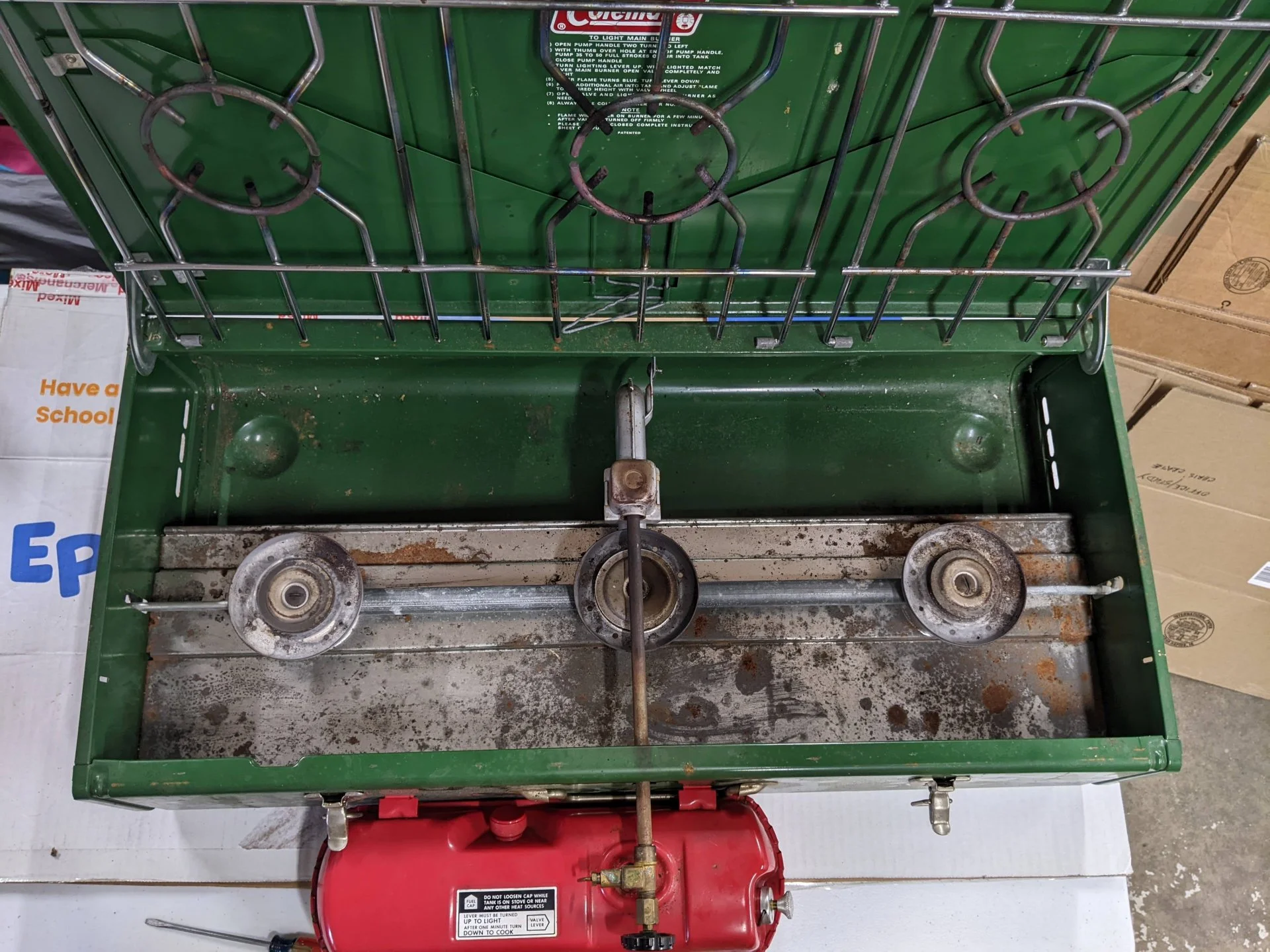

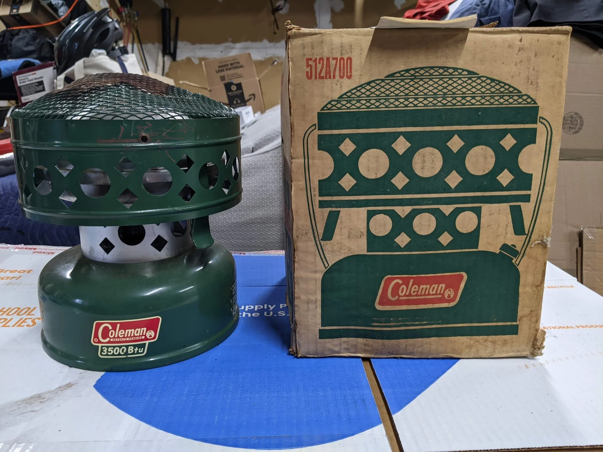

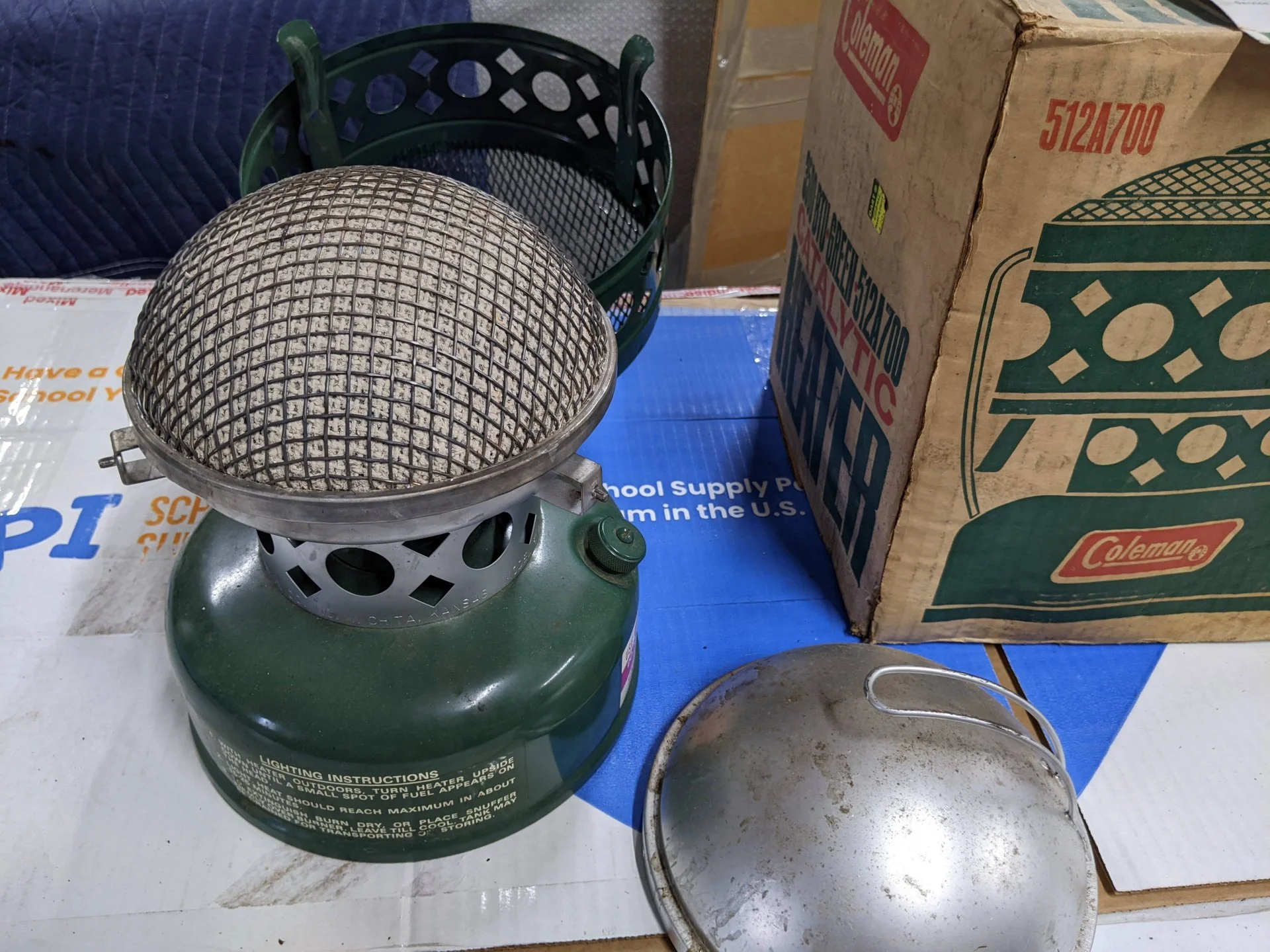

512A heater dated 1970
-no clue about this thing. do these even work well? didn't test it at all. seems you have to pour fuel on the top, then light it?
-no moving parts or obvious way to take it apart. fuel cap has a screw in it, so not a one-piece design like the newer stove and lantern. clearly missing the handle as well.
-thinking it needs a new cap
View attachment 3166955View attachment 3166958
I picked up one of these heaters awhile back for the fun of it. I showed its light up in post #2887-2888. They’re kinda cool, I like the Coleman novelty of it.
Fire it up and check it out.
gotta gets some fresh white gas. then i'll try it out!
