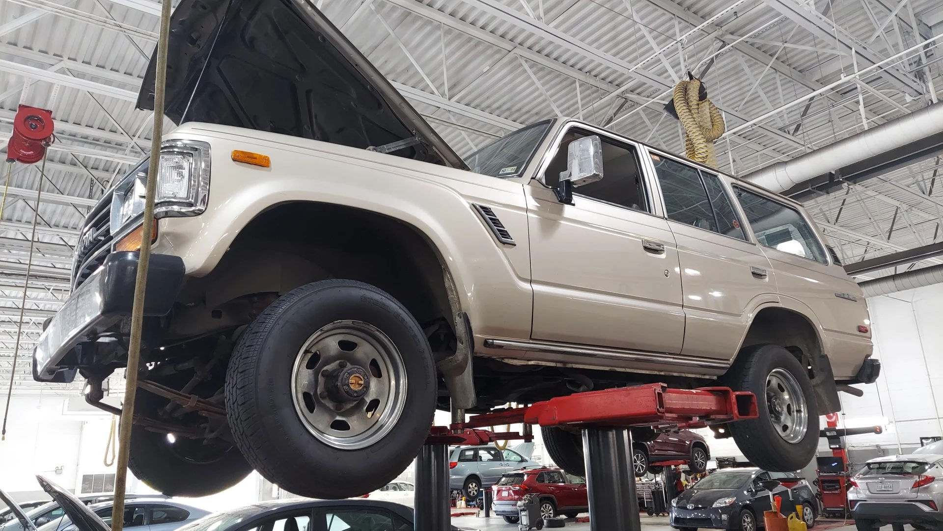

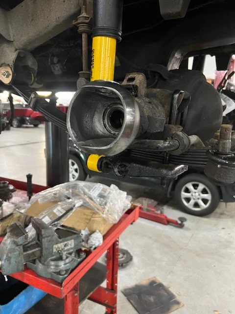

Work is finally getting underway!
OME suspension (2") lift, trans pan, and rear main seal to start!

- Done 6/22 - Change ALL fluids and flush where that applies (radiator, trans, etc.)
- Done 6/22 - Replace both front axle seals and repack bearings
- Done 6/22 - Replace oil pan (dent causing leak at seal) and gasket
- Done 6/22 - Trans pan gasket
- Done 6/22 - Rear main seal (seeping)
- Done 7/22 - Rear pinion seal (seeping)

- Done 6/22 - New shocks, springs, bushings, shackles (all being taken care of by an ARB OME suspension kit)
Mods I plan on adding - minimal drilling to preserve stock build (thanks to Bull Run Overland in Manassas, VA for great consulting and pricing better than online)
- Done 6/22 - ARB OME Suspension (2" lift) - springs, shocks, and shackles.

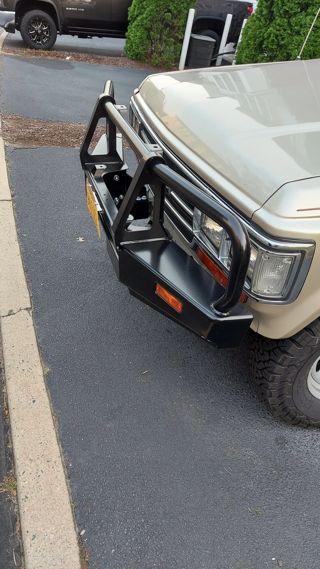

- Done 7/22 - ARB Front bumper (winch ready)
- still trying to find the right US made winch)

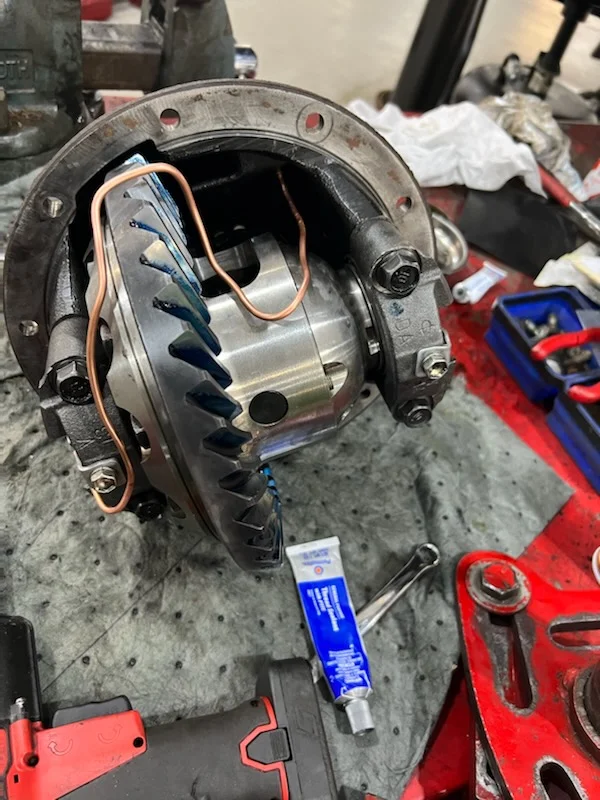

- Done 7/22 - ARB Rear locker

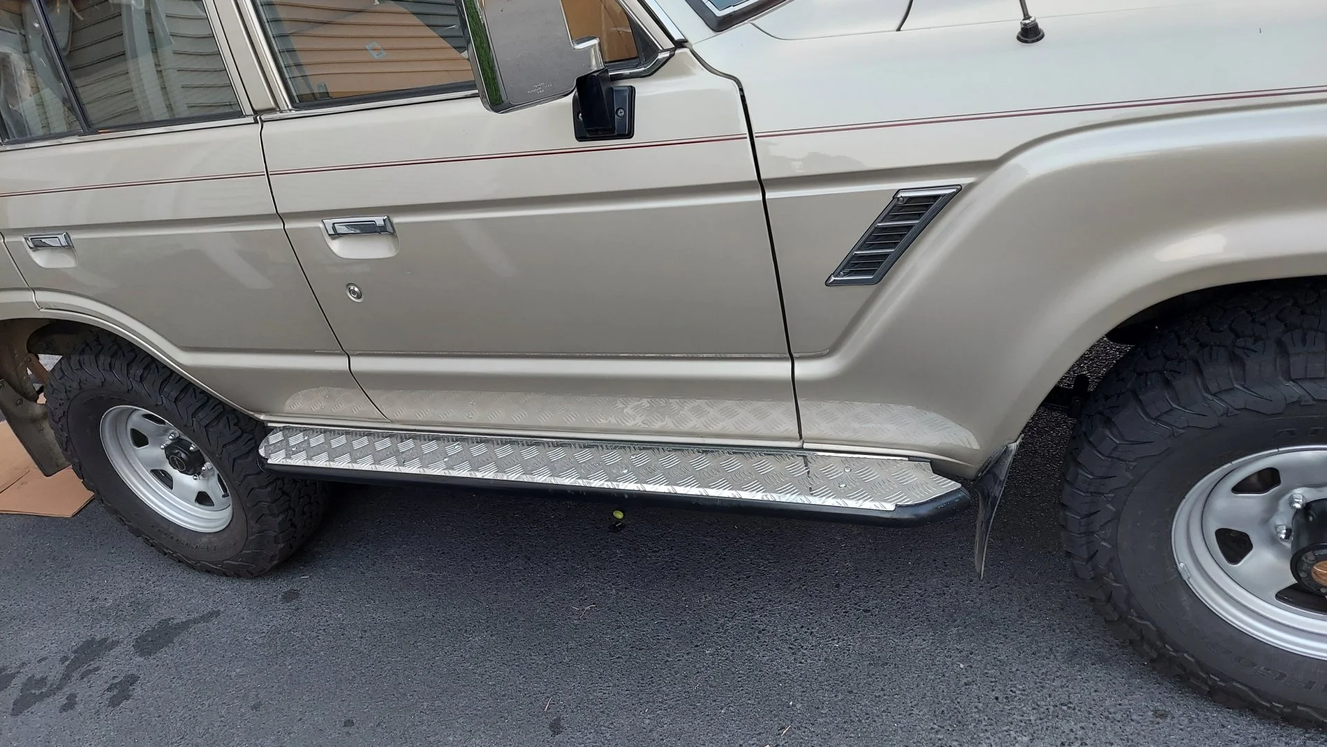

- Done 9/22 - ARB protection steps (at least I did these)

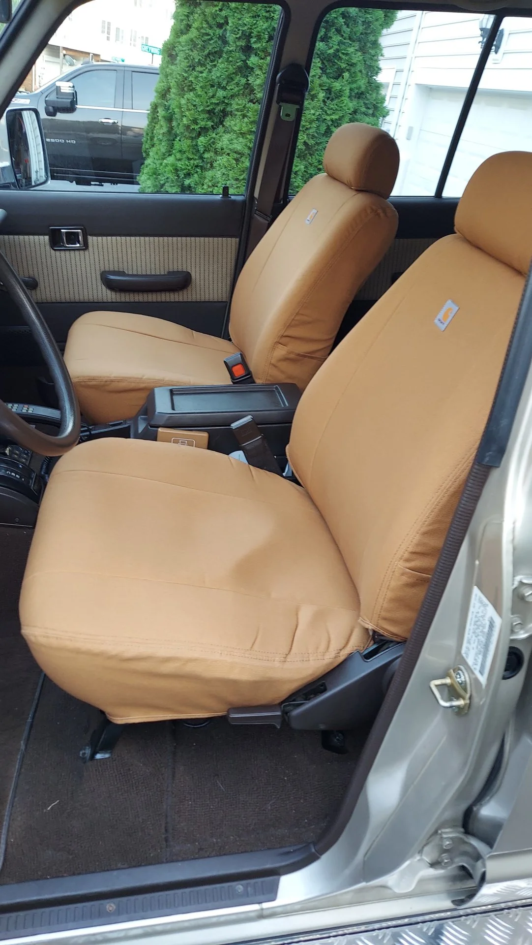

- Done 9/22 - (went with Carhartt PrecisionFit Seat Covers from Car Cover World - best price including new user discount) - Seat covers (still figuring out which ones but going with US made and water resistant/waterproof) - They were easy to put on.

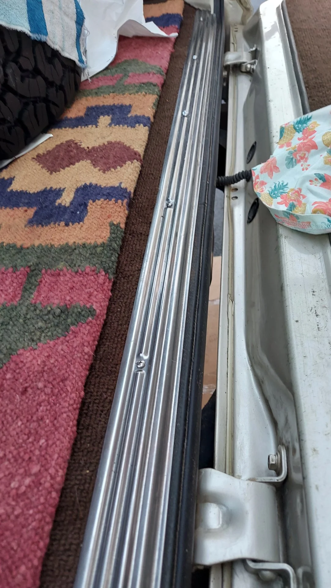

- Done 09/22 - replaced rear metal tailgate sill with one from a donor vehicle.

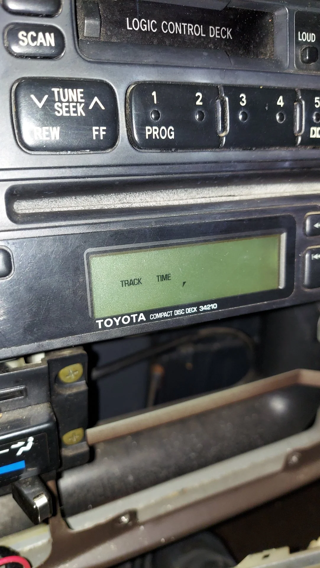

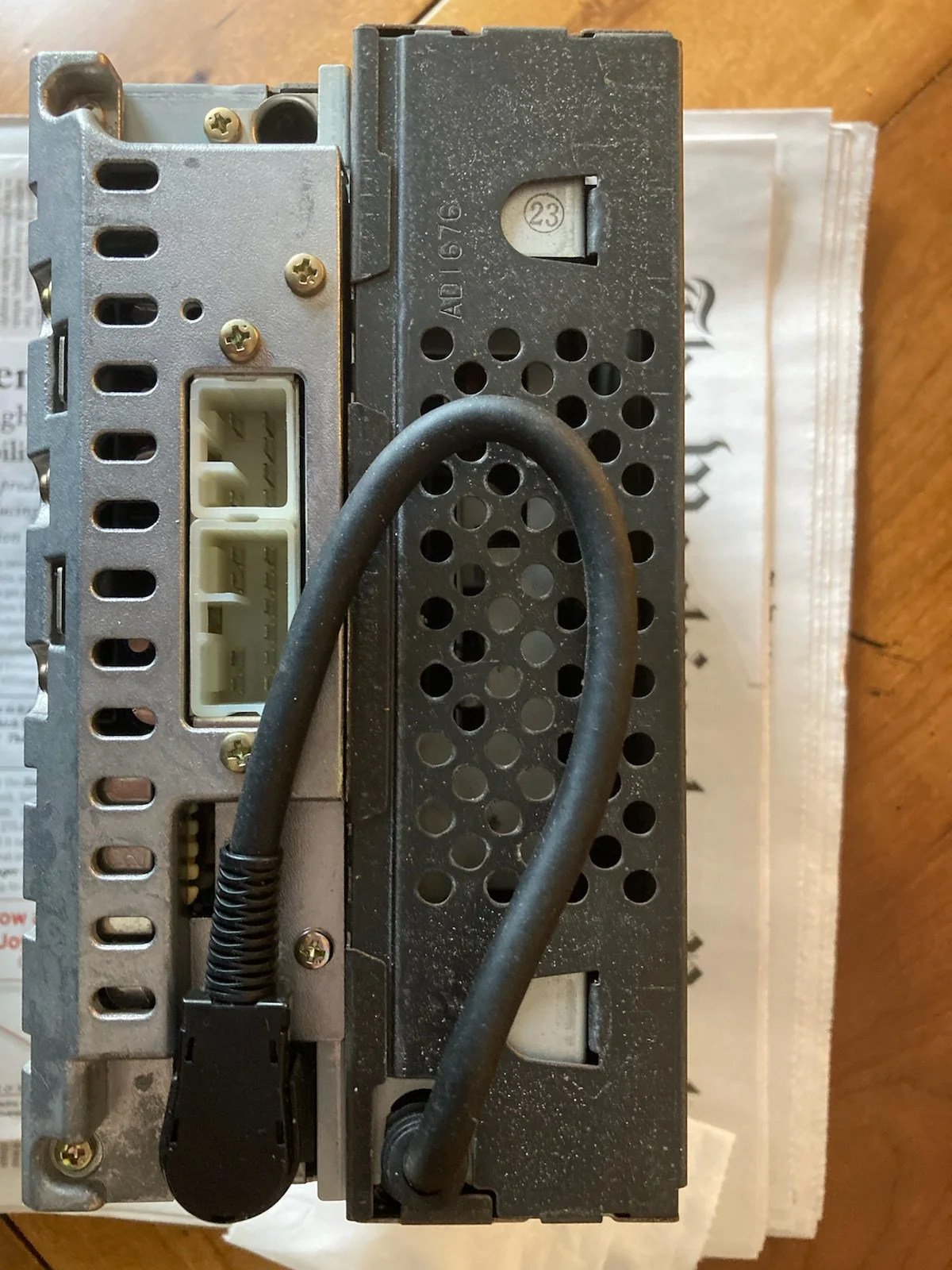

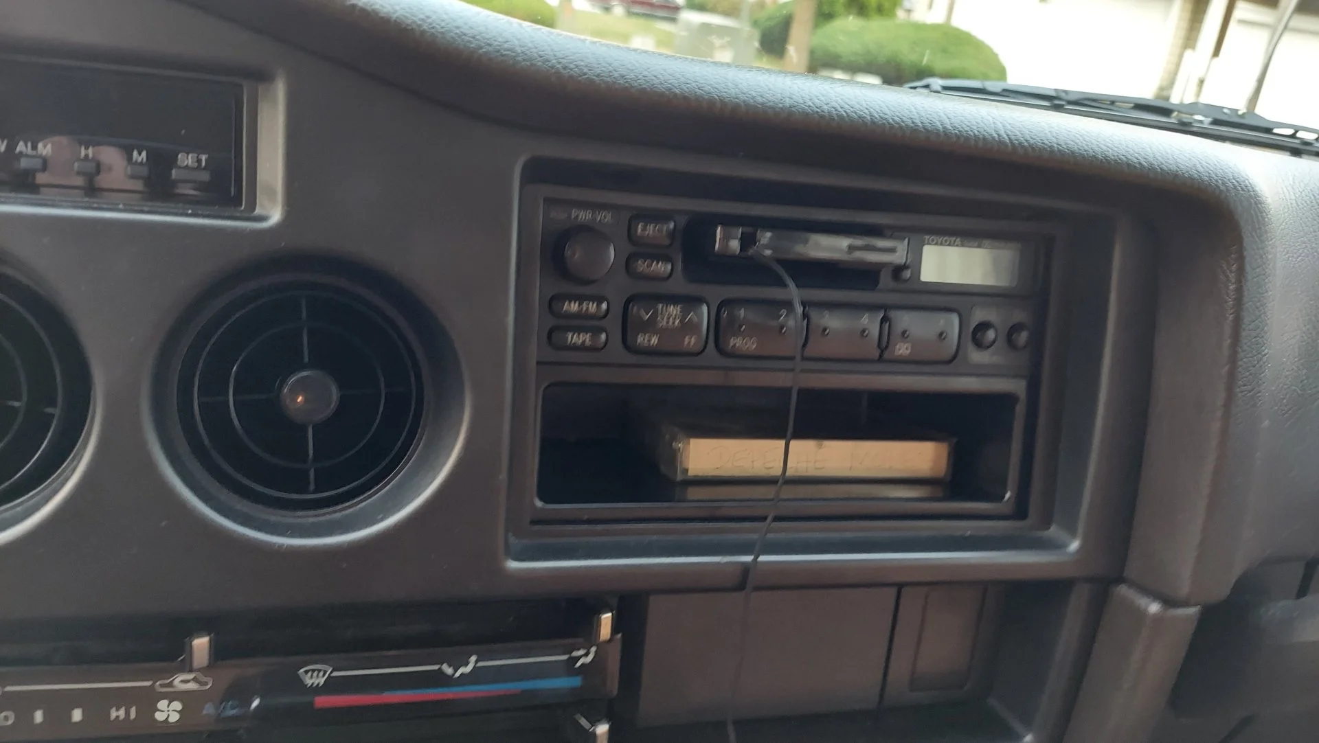

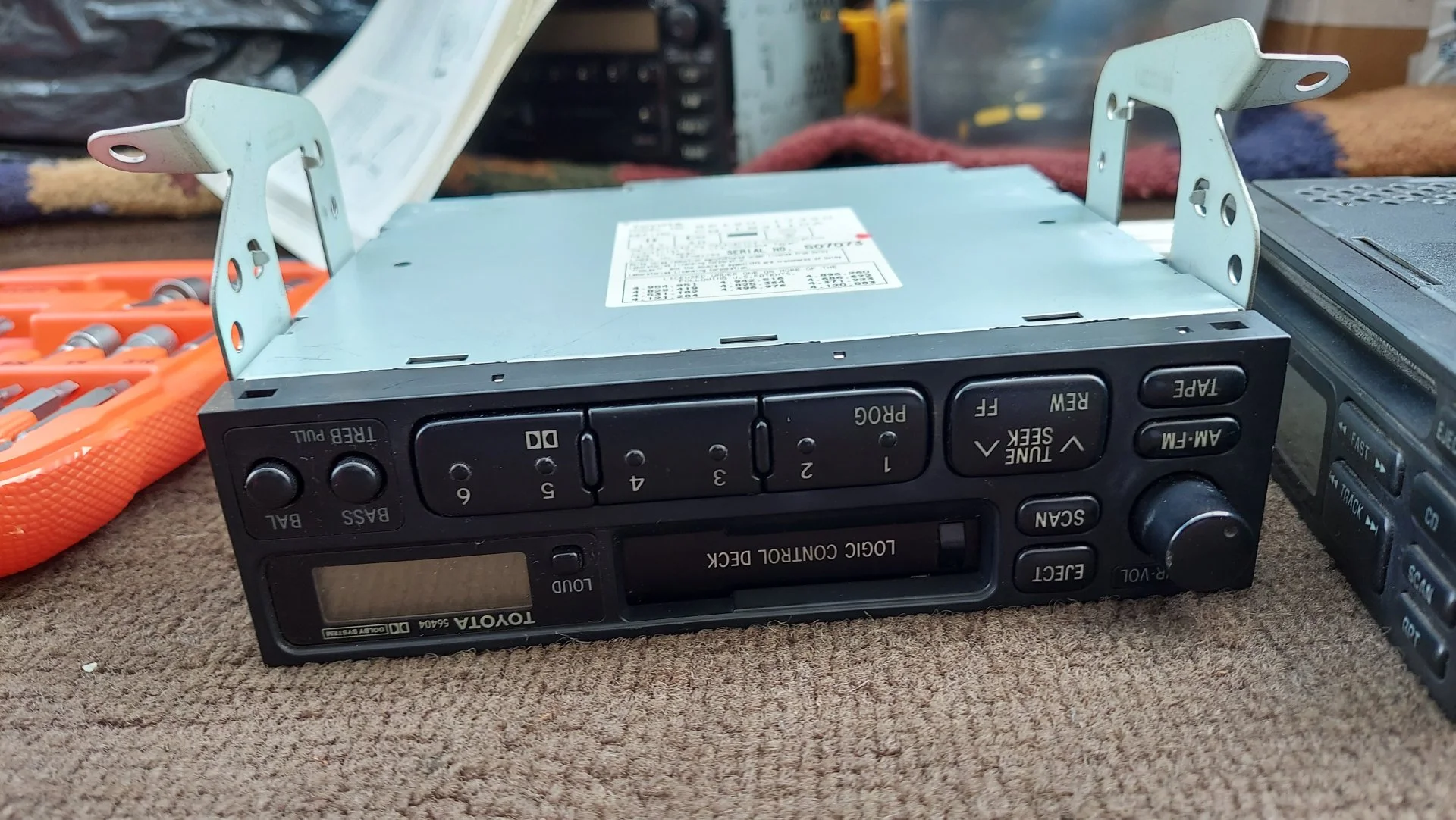

- Done 9/22 - Swapped out the stock AM/FM only radio for one with a cassette player a friend had for an MR2 and it plugged right in. I even found a bunch of old cassettes and a cassette adapter with an AUX cord to connect my phone. CD player add-on coming next which will remove my 1 DIN box for cassette covers. 🤔 - early 90s issues.
On the head unit - in my '97 3rd Gen T4R, I'm running a single DIN head unit out of a contemporary Camry (junkyard) along with a Crux Bluetooth adapter, which plugs into the back of the HU and acts like an external CD changer. This is the third late '90s Toyota I've done this with and it works great.
I don't think Toyota started adding the external CD control to the factory head units until about 96 or so, but this company looks promising, ymmv.
Rig looks great, lots of good work done up above!
I actually had a CD player with the cassette player I put in that was mated with it but it doesn't play CDs (bad lens I think) but this is the unit that plugs right into the back of the cassette unit. The CD player was made in Nov 1992 part # 08601-00812 and they a pretty easy to come by on ebay and not very expensive. Cheaper than what I can get a new LED for the internals on the one I have. I'll have to look into the Crux BT adapter. I did see some cassette adapters with BT that you just slide the BT cassette into the player.

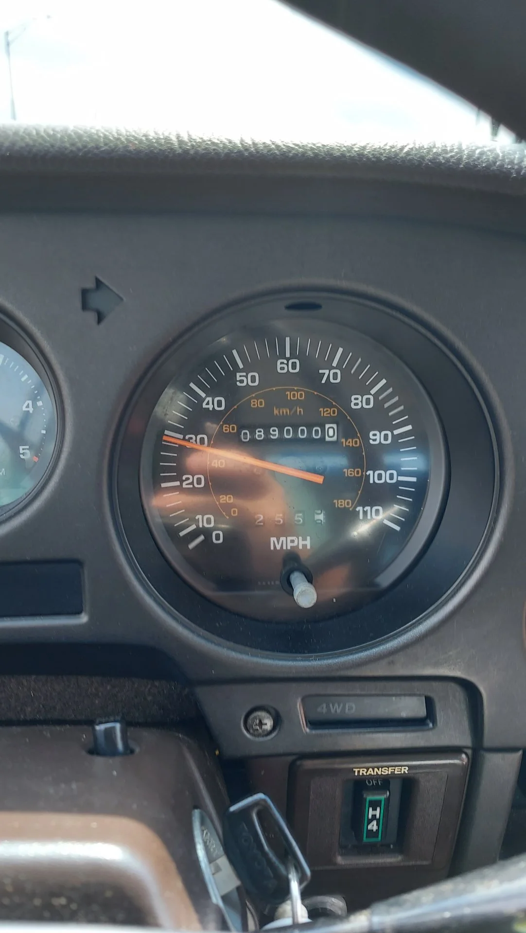

Nice,Valves done?
Had everything tuned and valves adjusted and timing set. Valves were in great shape since she's only just turned over to 89K about 3 weeks ago.
