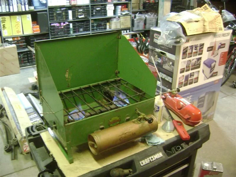

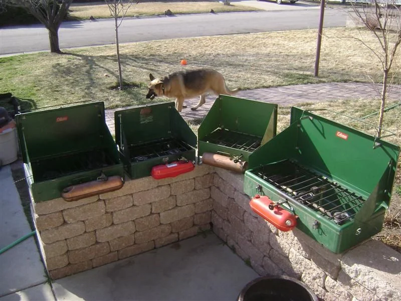

A few of my old Colemans :D
There was one like the last picture in the pile they had at Twin City. It was pretty rough but I like the fold down legs. I might go back and pick it up.

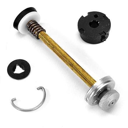

Yup. First thing that fails us usually the leather cup on the pump. Sometimes it's just dried out and you can "save" it with some oil. I found new cups local but I'm sure they're easy to buy online. The other critical seal is the cap. Simple o-ring I think? Don't have one in front of me.

If you oil up the leather cup and still don't feel the tank start to pressurize try cleaning and oiling the tank fill cap seal.
