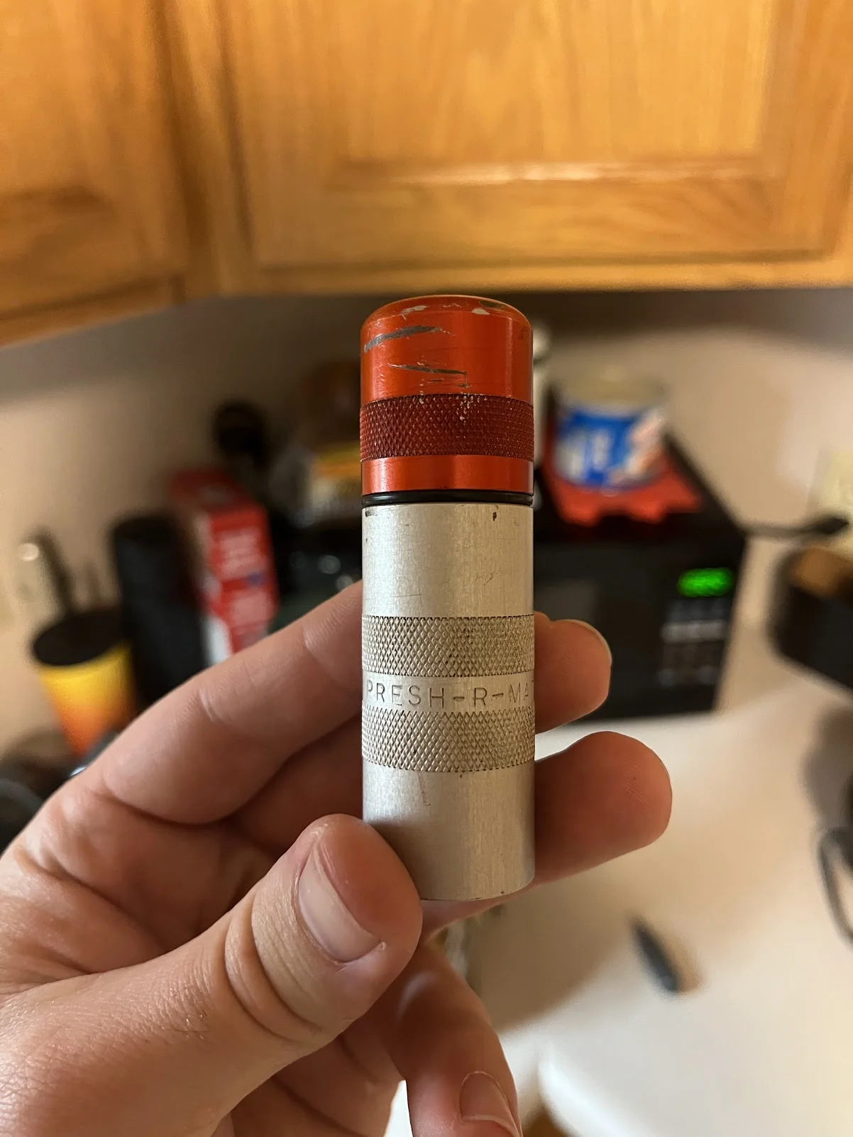

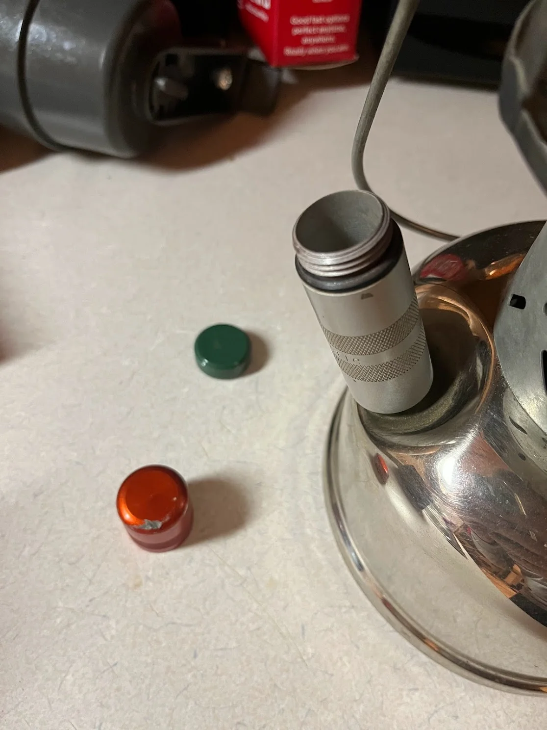

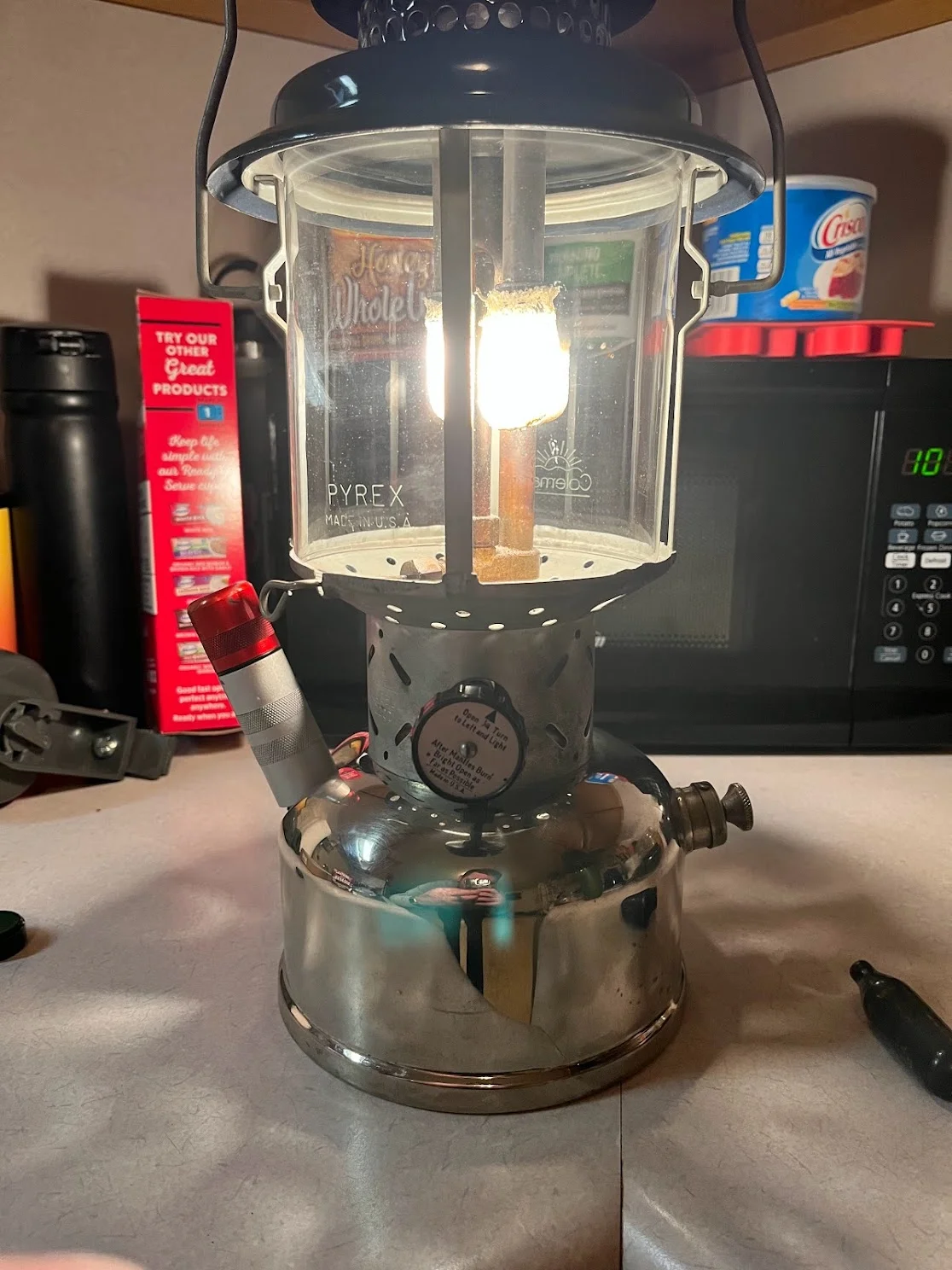

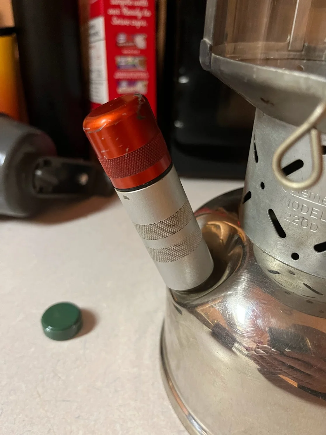

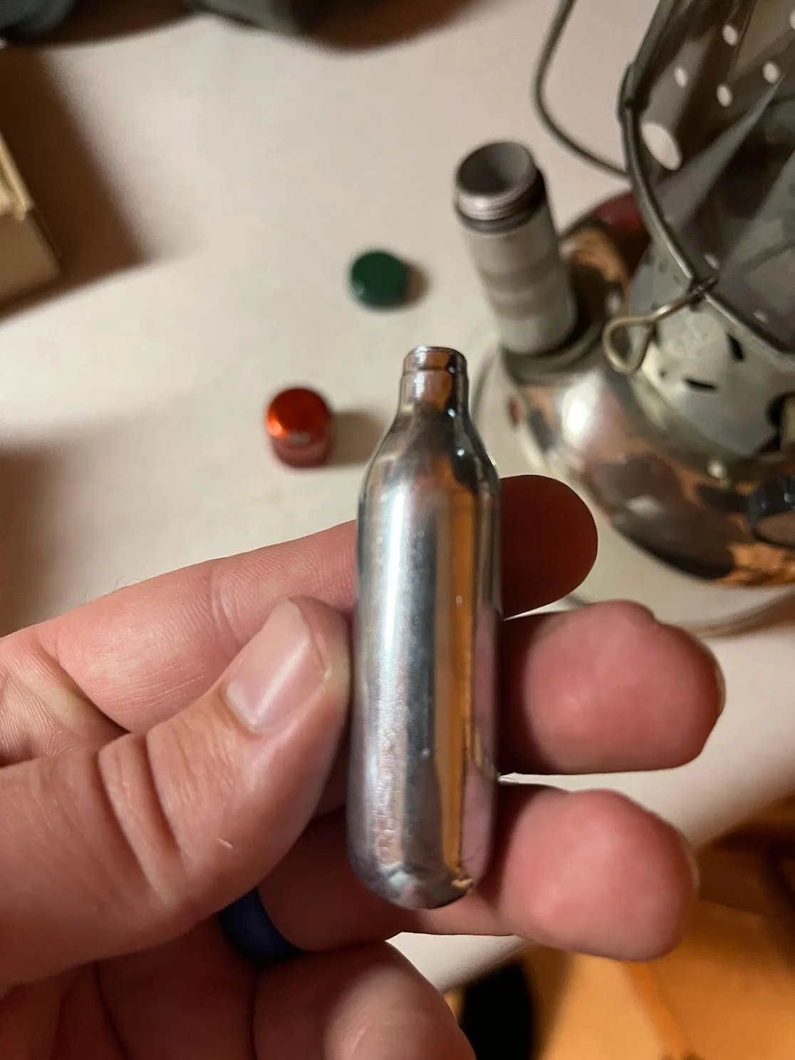

You guys ever come across a Presh-R-Matic before? My mom bought a Sears lantern with one, and didn't know what it did so she just gave it to me.
It's pretty slick! You thread it on to the tank where the cap would go:
Pop in an 8 gram C02 cartridge:
Install the red cap:
Tighten the cap, which then punctures the cartridge and fills the tank with compressed air.
I imagine that when it's time to refuel you lose whatever's left in the cartridge?

Continued on my lantern. Got the check valve unstuck. Combination of soaking in carb cleaner and compressed air (~10psi) did the trick. The lantern does "surge" a bit when running; meaning the light level changes between ~80% and 100%. Is that normal? Or should I dig deeper and replace the generator?

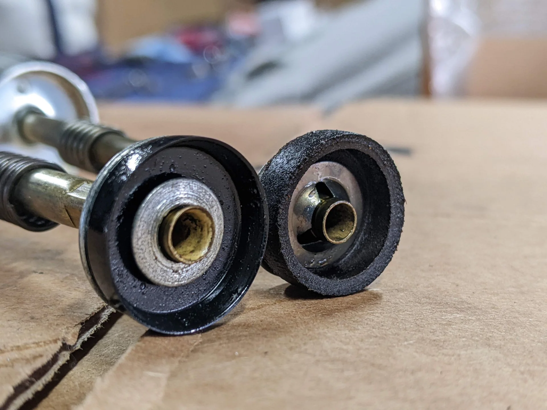

Is there a way to replace the plastic cup on the left? The retaining washer seems to be on there for good, and is unlike the retaining washer on the leather cup on the right (from my 426D). Its as if the washer was slid on the shaft, then the tip expanded as a retention method. The plastic cup is working fine but the leather cup seems smoother.
Pulsing like that can be insufficinet fuel in the font, insufficient pressure in the font, or a dirty generator. Fill it up till it leaks out its hole, pump it up until your thumb's too weak, and then if it still pulses replace the generator.
Is the shaft on the left pump stem threaded on the outside for that washer to unscrew?
I pumped this thing up till i thought it would explode. it wasn't a full fuel load though, not even close...maybe less than 1/4 tank. my hunch is a generator but i'll try again with a full tank of fresh fuel. this lantern has probably been sitting for 30 or more years.
And nope, no threads to unscrew the keeper. this is a '84 lantern so i'm thinking coleman removed the serviceability from this era pump.
I just looked back and saw you're working with one of the modern lanterns with the plastic fuel-air tube. They will not burn stable without a COMPLETELY full tank on lightup. I fought this myself until I realized that all the older (pre-CL/Adjustable era) lanterns with the metal fuel-air assembly and Instant Light circuit will light on any amount of fuel but all my modern ones with the plastic tube will only burn stable if you light them on a **COMPLETELY** full tank.
You just need to fill the tank up all the way before you try any more troubleshooting.
