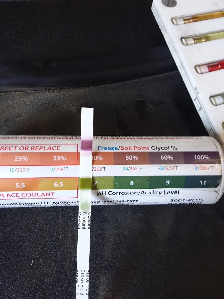

I have a 2016 LX570 and had the coolant changed at 100k. PH test was showing coolant getting too acidic. My driving is mostly city. Living in Utah it's both hot and cold. I haven't had any leaks or issues (knock on wood) the vehicle had a perfect service record going in every 5k miles and all services done.
To be clear this picture was from your 100k mile coolant before being changed?
Sorry, yes this was prior to the coolant change.
No worries, that's really good data, and frankly backs up what the guy is saying about 100k coolant change interval.

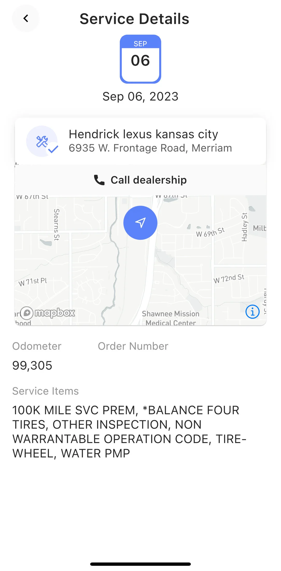

I have a 2017 with 112k miles. Car was dealer maintained with oil changes every 5k miles as shown on the Lexus app. If the 100k service was performed, I'm assuming they coolant was flushed per the schedule.
I’d verify with the dealer exactly what was done. It’s not unheard of to have dealers skip things and/or do extra cost things not needed.
