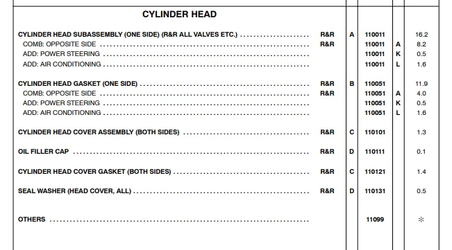

For anybody thinking about preemptively R&R'ing their head gaskets, it books out to just over 16 hrs of labor for both sides.
Edit: correct time w/o touching the valves
For anybody thinking about preemptively R&R'ing their head gaskets, it books out to just over 22 hrs of labor for both sides.
I've changed out head gaskets before, though never on this motor. I'm trying to figure out why it takes that long. Seems crazy to me. I hope to never find out.
Looks like it's 16 hours for the head gaskets. If you R&R the valves it's 24 hours by the FSM. Other stuff like valve cover gaskets should be part of the 16 hours as those have to come off anyway.
I'm not surprised in the amount of labor though. Just doing the timing chain cover (gasket) is 6.6 hours by the book, and I think the valley plate was also like 10 hours by the book.
