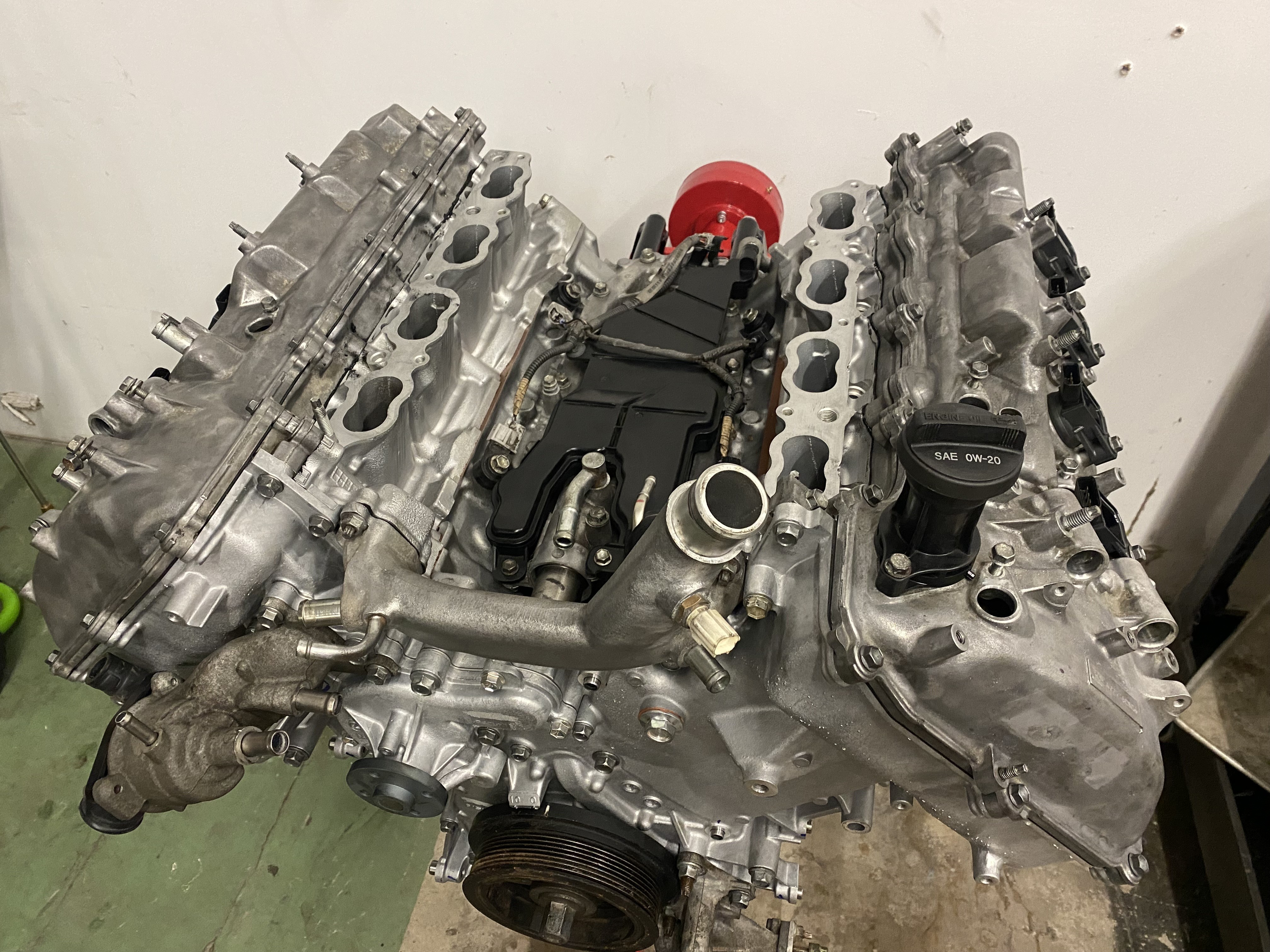

Based on the video, does this pricing not seem all that bad, and not near as risky as buying a junkyard engine?
The moral of the story: All 3UR-FE engines are garbage. If your cam tower isn't leaking, your valley plate is, and you probably will just drop a valve or blow a head gasket.
Disregard the many examples still running with 500,000+ miles.
Just drive them all to my place, drop the keys in the mailbox and be thankful that I'm willing to relieve you of the burden without so much as charging you a dollar.
An excuse to upgrade to an XAT 5.7?
You're about $30k into an 800+hp XAT when it's all built...maybe more. I can track down 5.7 l in my area, with similar mileage to mine, for about $3-4k...
But $11k for a XAT basic build seems reasonable.
I've often thought it would be fun to buy and build a second 3urfe for the Lexus...for the time being, regular maintenance will have to suffice.
