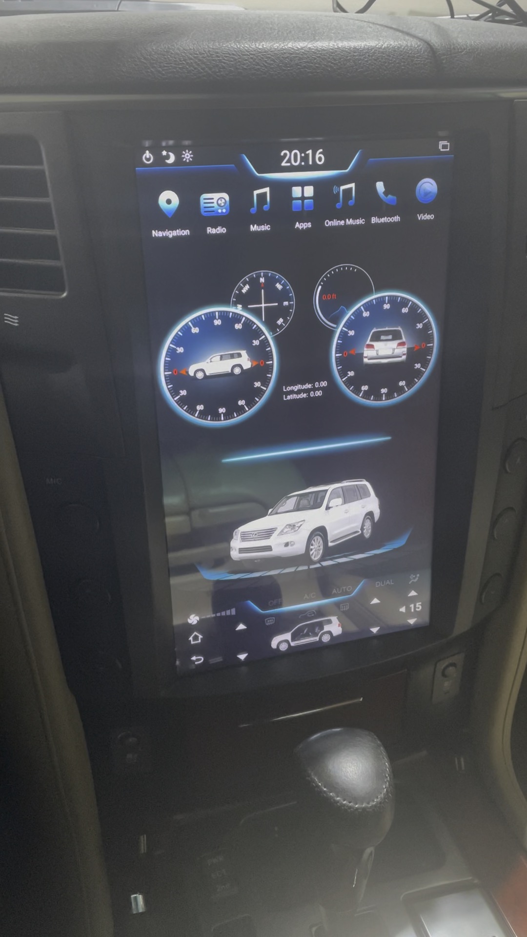

I haven’t seen much info about the LX so I thought I would add my experience. I installed one in my 09 LX. I have no rear entertainment but it likely wouldn’t work off other peoples feedback.
Cameras(Front, left, rear) don’t work but I don’t even see a hookup for the connectors. I bought the 360 camera kit to try that out. My existing camera quality wasn’t great anyway and I hope these will be better.
I mainly want to use wireless car play and it seems to work. I did have to up the cur volume because it was “soft” at max but that fixed it.
Stock video app did not work, I’m going to set up an email for the LX and make a Google play account to try VLC.
Anyone know how to change the vehicle in the inclinometers?

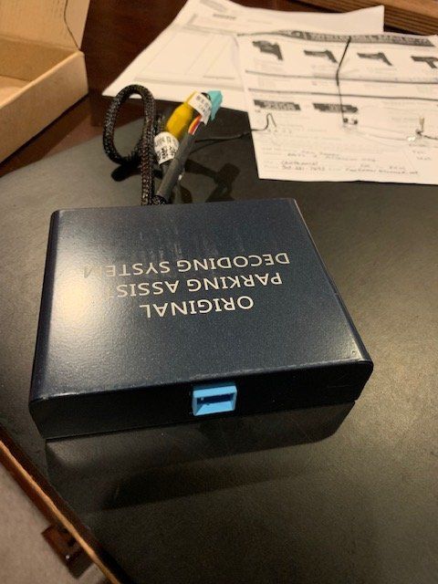

I received the adapter box for the 4 cameras I have
The existing setup has two connectors that are the same, one blue and one white. You would think the Blue one is the correct one, but it is the white one
Now all 4 cameras work. The rear camera comes on automatically in reverse

Hi, did you receive any documentation with the camera adapter box? I have the same and connected the white plug and the system doesn't trigger when backing up and no camera at all on the screen. Maybe I'm missing something in the harness or received a bad box? I have a 2013, no 360view.
Where does it specify the year model?
[Edit]
Many thanks, I found the Console->Settings and changed vehicle type... All worked fine.
I didn't receive any documentation. Sounds like you fixed your problem, correct?

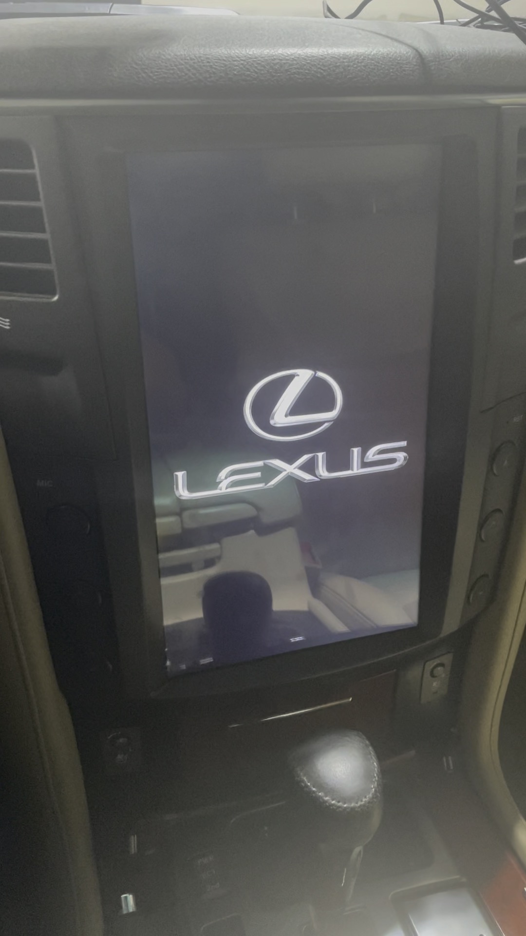

I worked a bit on updating the firmware on my PX6 unit. I worked with a gentleman who seems to be a very valuable resource making custom updates for the android head units.
Here is a link to his page(I’m getting absolutely nothing out of this, other than passing along info)
In addition to getting some additional features his custom firmware allows you to get a much more OEM look to the boot up and home screens.
Pre-Boot Image(I’ll likely change this one out to my truck on top of Red Cone or something memorable)
Boot animation(comes in fairly slick)

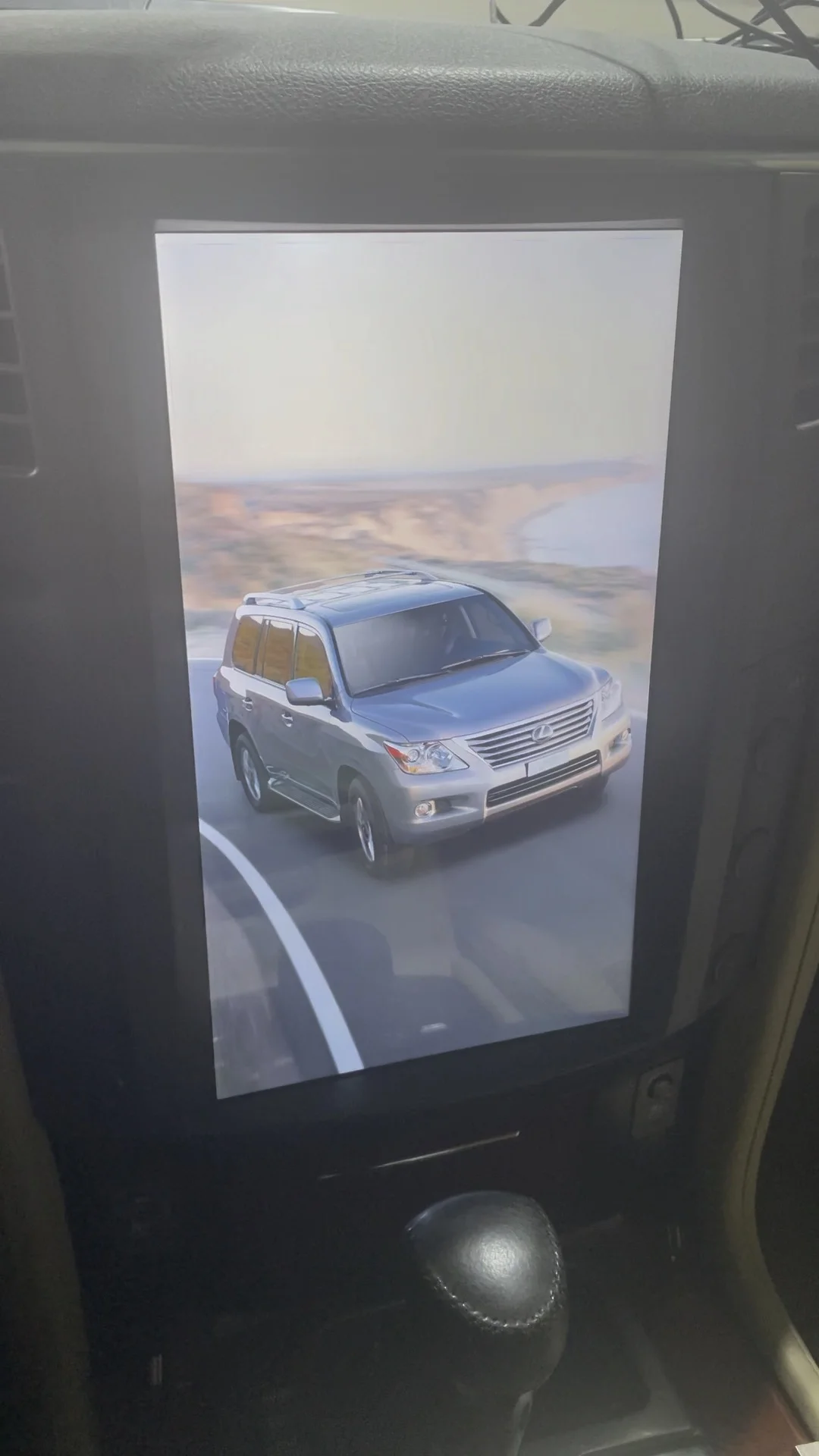

Home Screen with new theme(notice the LX in the gauges and main screen along with HVAC controls)
This is absolutely killer. Has he maintained all the functionality in the updates? I noted some people losing the rear screen, nose/mirror cameras, etc.
He simply supplies some updated/tweaked firmware it does not change anything to do with the physical install which I believe is the limitation for rear screen and cameras. I don't have a rear screen and I know for a fact the factory cameras don't work and are not plugged into anything after install of the hardware.
