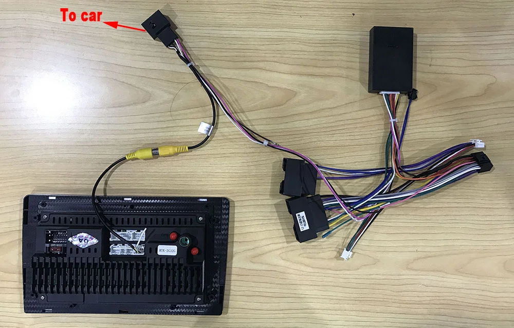

Just checked guide, there is a pic showing how to hookup this unit with the vehicles original rear camera. I wouldn't be surprised if some vehicles don't cooperate, but again, if it worked with the PX6 units, I don't see why it wouldn't work with these newer units: 999.0US $ |EKIY T7 Multimedia User Guide in listing description details.| | - AliExpress - https://www.aliexpress.com/item/1005001939536181.html?spm=a2g0s.imconversation.0.0.4d573e5fbuTZXM
Lc camera output to original Hu is digital not analog. This looks like it won't work.
Lc camera output is digital. You need a digital to analog converter if your camera input is Rca like the picture above. Otherwise you will need to tap into the parking ECU and pickup the analog signal coming in from the camera and send a signal from the reverse to excite he camera. But then you won't have the parking assist guidelines which are overlaid by the ECU.

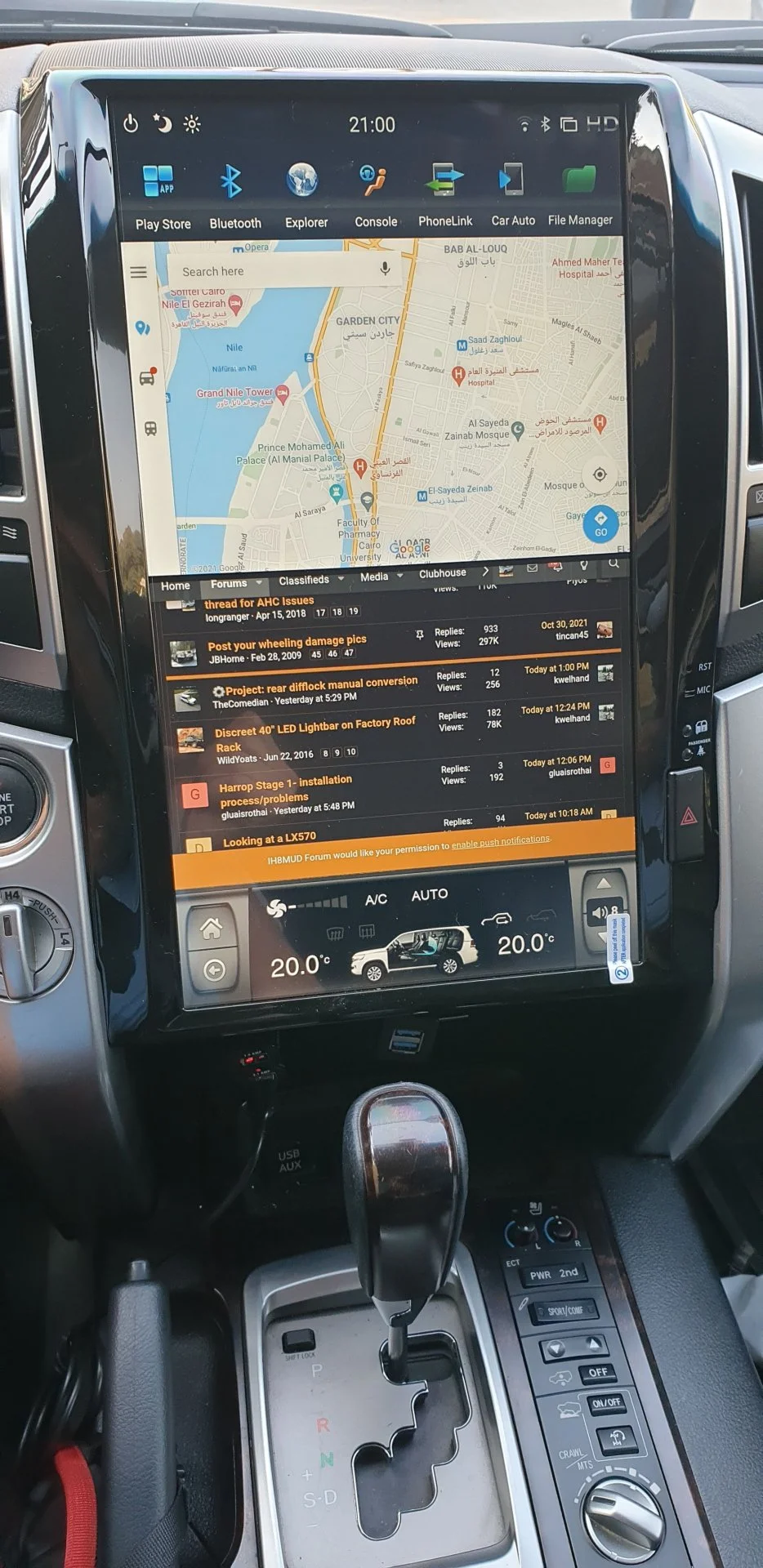

I’m less interested in the giant Tesla screens than just having a modern OEM (maybe OEM+) sized screen with better picture quality and touchscreen. I’ve mostly shied away since it seems most currently available systems run on Android 8 or 9. Seems crazy to buy something with an OS that is already years old when you hope to keep whatever you install for multiple years.
Form factor wise, this is the one I like. Replaces the stock buttons with stockish control panel. But is clearly a PX6 model, and quite expensive for a 5 yr old tablet. Anyone happen to know if anyone sells this unit with the new SoC?

Can’t you just have an android app installed to control the brightness based on sunrise/sundown?
Well, typically the night mode inverts colors as well. I suspect an app can do an inversion as well, but I don’t know if night mode is a simple inversion or something fancier than that.
Edit: A quick google shows that Android 10 has a native dark mode. That might be enough. I shouldn’t have implied that I needed it to function off the photo sensor. I just remember when I bought my LX and had the interior dimmer set to max, which caused the main screen to not flip into night mode. I really didn’t like driving it like that.
