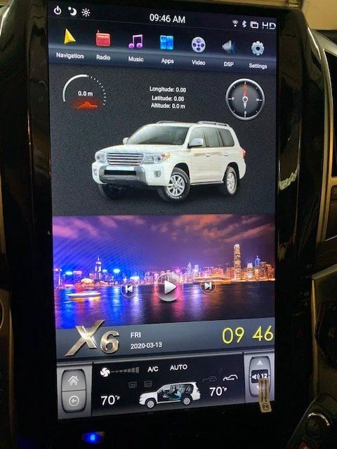

Cool 16" screen. the vertical screen that Tesla introduced is great because it breaks the screen up into quadrants of information or applications. on this one you have a header section - select options hard coded in the software (however it is android so open platform for you to mess with if you know what you are doing) and it has a footer section, this is for your back and home button and also have the information and launching of climate controls. The middle is broken up into 2 equal areas for apps so you can have radio on one and something on the other one, nave so far takes both sections (I am sure I can adjust it, just have not played with it enough) the climate and door alerts are pop ups over whatever else you have in the sections. There are other launch skins and apps you can load Phoenix has a drop box with a bunch of tools and other apps you can get, and also this is android so you can load some of your favorite apps if you like (and the work on that version and build)
This is Android 7.1 btw
you get google maps. Now google works best when it has internet connectivity (get into that later in this post) but you also can download maps and use it in offline mode and early test show it does work but not as good. However finding places and getting routed to them works just fine in offline mode once you have downloaded the maps.
There are also a few other nav map options, I have not played with them yet.
you get a radio app that work just as your regular AM/FM radio does, it has presets and can scan and tune and does support RDL. It does not have XM radio or HD radio
you get a "music" app that will play music from a usb stick or other method of media, that works pretty good.
you get a blue tooth app that is used for your phone connectivity for getting and making calls as well as BT streaming music from your phone. This all works pretty well, head unit has its own mic built in and using the vehicle speakers for the sound of course. people I have called say it works and sound great (of course not quite as good as my telsa) but as good as land cruiser factory BT phone stuff. Has phone book and recent calls, however no voice dialing (yet) still working on the voice activited controls with another android app
It does not have Apple play or Android Auto, it does have a generic version of these but it really does not work as smooth or seamless as those apps work.
you get a few apps to play video, but I don't do much of that so I have not played with it yet. I can tell you that it does conform to the parking brake on to play video.

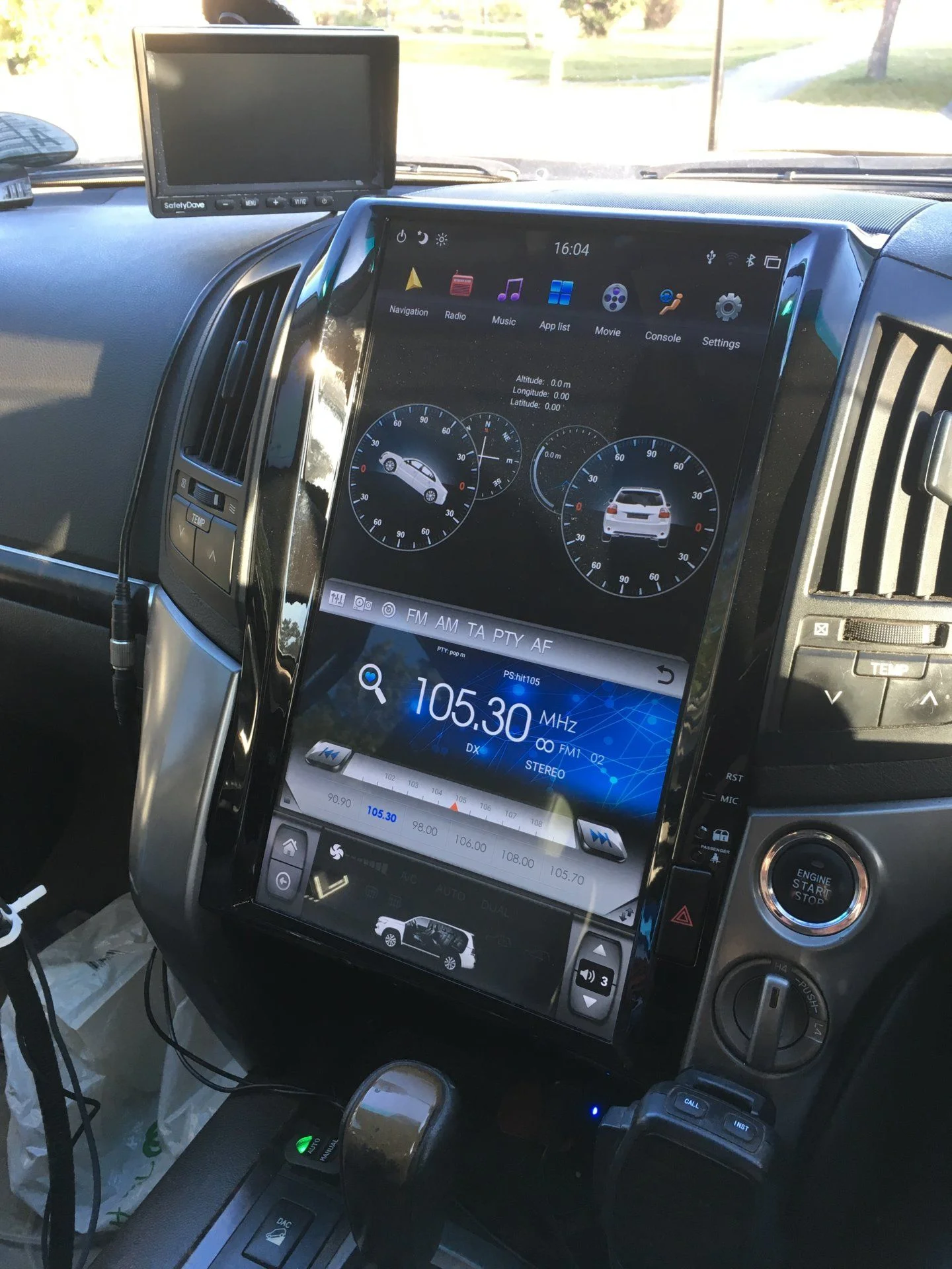

Just finished fitting this 16" Tesla style screen to my 2008 LC200 Sahara. I've put together a video on fitting the unit as they often don't come with install instructions. Very happy with outcome and happy that it integrates Air Con, Rev Cam and Sahara Amp. Bought from Smithnjones who were very helpful. Here is the install and review video https://www.youtube.com/watch?v=nfvtvfsULg8&t=91s

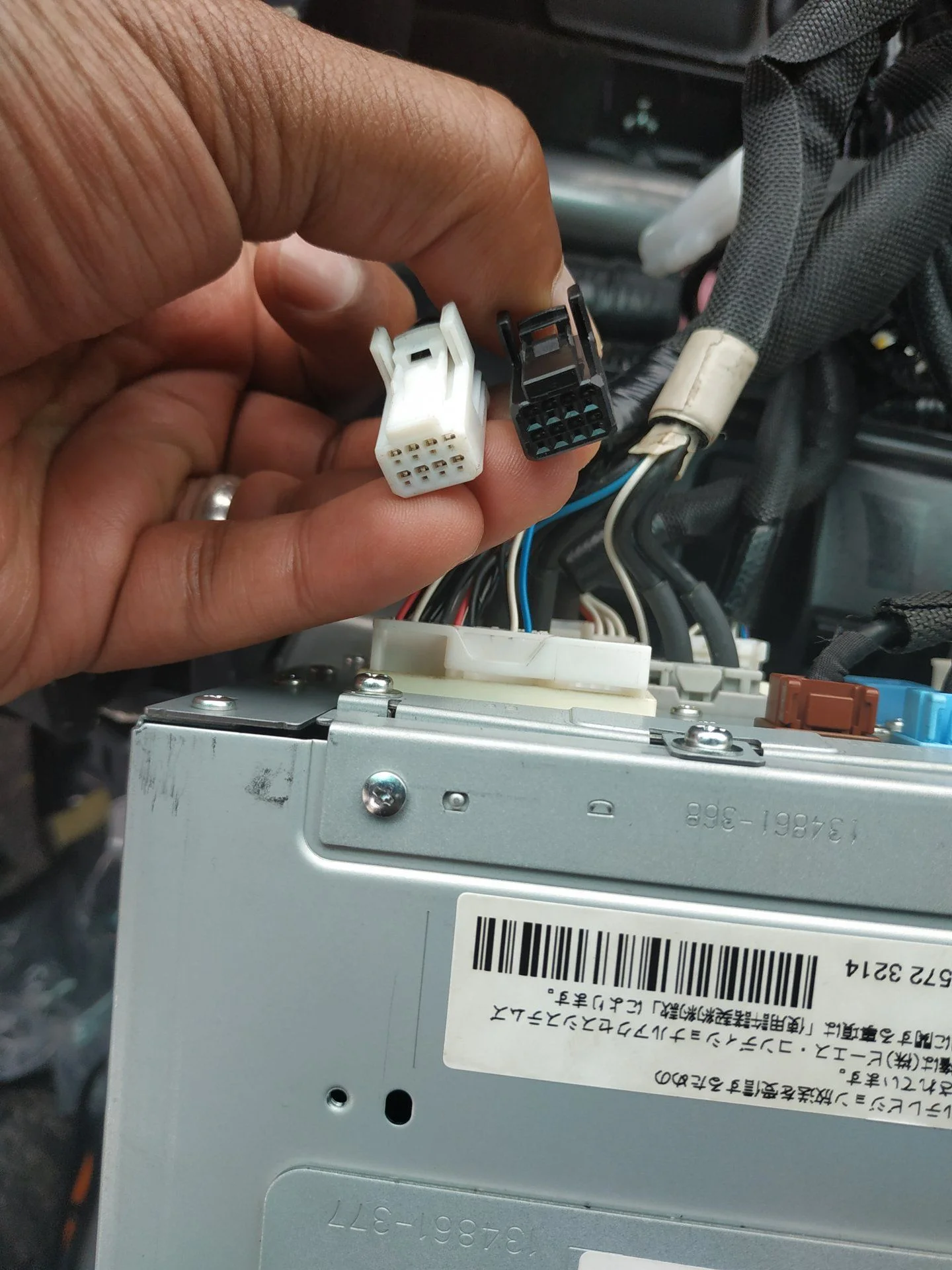

I couldnt figure out how to connect the cameras and ended up doing something stupid. Both video connectors looked like they would fit in an empty connector and when I did that the unit went dead
I put the stock unit back in and it was also dead. Thinking I fried something external to the unit and will have to wait until I get it back from Slee before I try again. Maybe they can figure out what I did or I likely will have to drop it off at another shop

As an update. There were not mating connectors for the video. I contacted the Australian company who didnt realize US spec cruisers all have 4 cameras. He said there is an adapter box which is on its way to me now. Ill put the unit in over the weekend and finish up later when I get the adapter box and post results

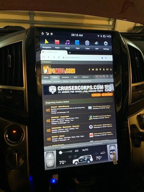

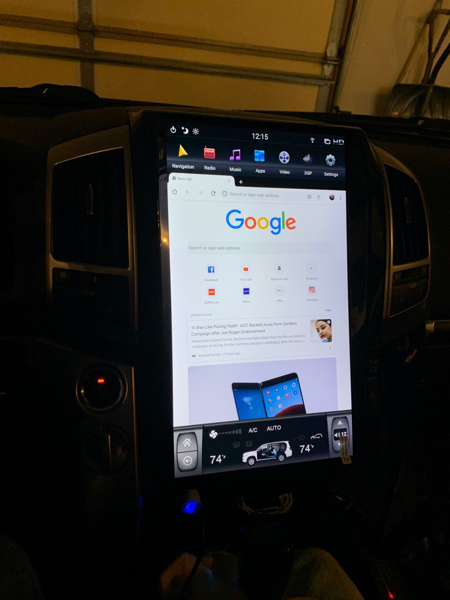

Is there a way to easily dim the screen? On my oem one if I turn off my headlights that screen lights up supper bright and it's not very intuitive to go through the various menu settings to dim the screen.
and can you add TOPO maps to the NAV or sat images?
Its an android tablet, running my topo maps is the main reason I got it so I wouldnt have to run my tablet
On brightness, not sure this is a factor for me. I will install short the cameras tomorrow and see how it goes
Here is a teaser. I ran out of steam and will finish tomorrow
There is an icon at the top of the screen to adjust brightness
Nice Ken! Can you change the Audi to a LC???? 😜
Patience my friend. Lots to do here in downloading apps and getting it all setup. No instruction manual makes it exciting :)
It does have an LC on the bottom showing how the HVAC is working

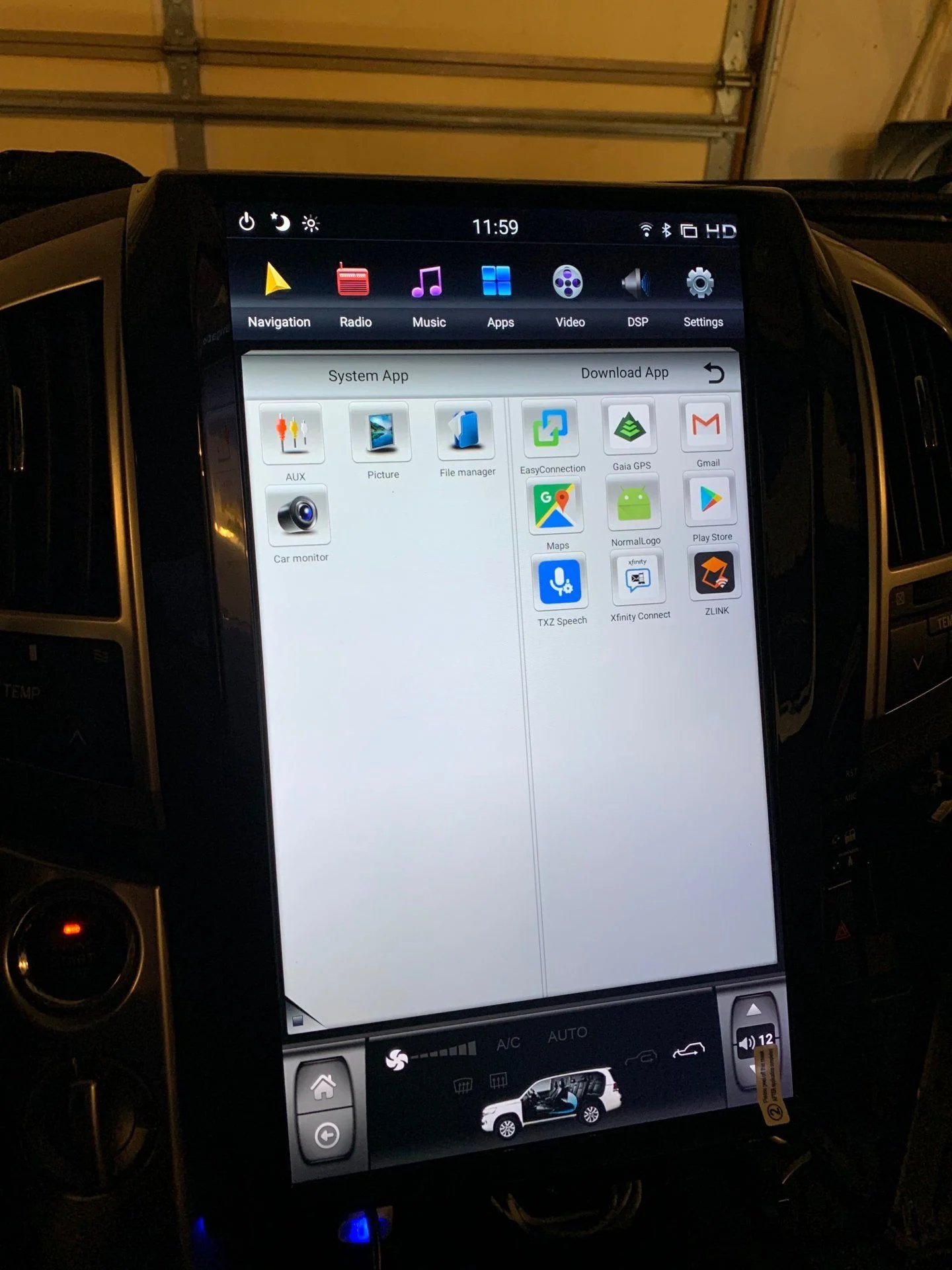

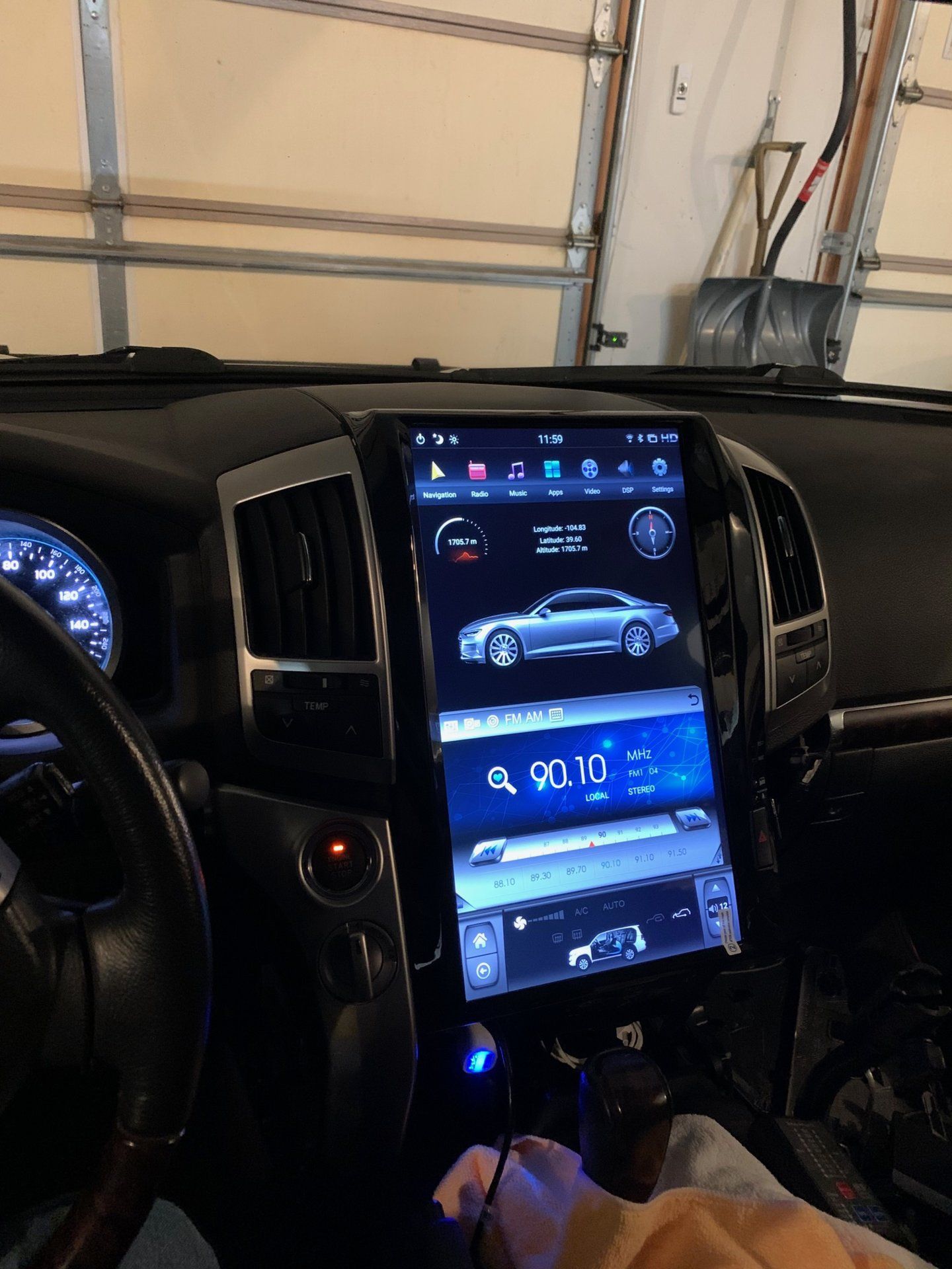

Still figuring things out. The easy connect app mirrors my iphone well so you can see what is on the screen. The Z-link app that came with it couldnt lock right. Anyone have a better recommendation for car play?
The steering controls work
Blue tooth works to my phone
Wifi works great. Likely will get a MIFI from Verizon to always have internet
Blue tooth works fine. Music will play fine from the phone
Havent received any calls, but validated I could call out
Cameras not setup yet, waiting for the adapter that is making its way across the planet :)
Rear DVD screen not hooked up, but I have never used it. Several RCA and video inputs on the back so likely with some customized wiring could get it to work or with a unit that would???? Thats a guess and dont know for sure

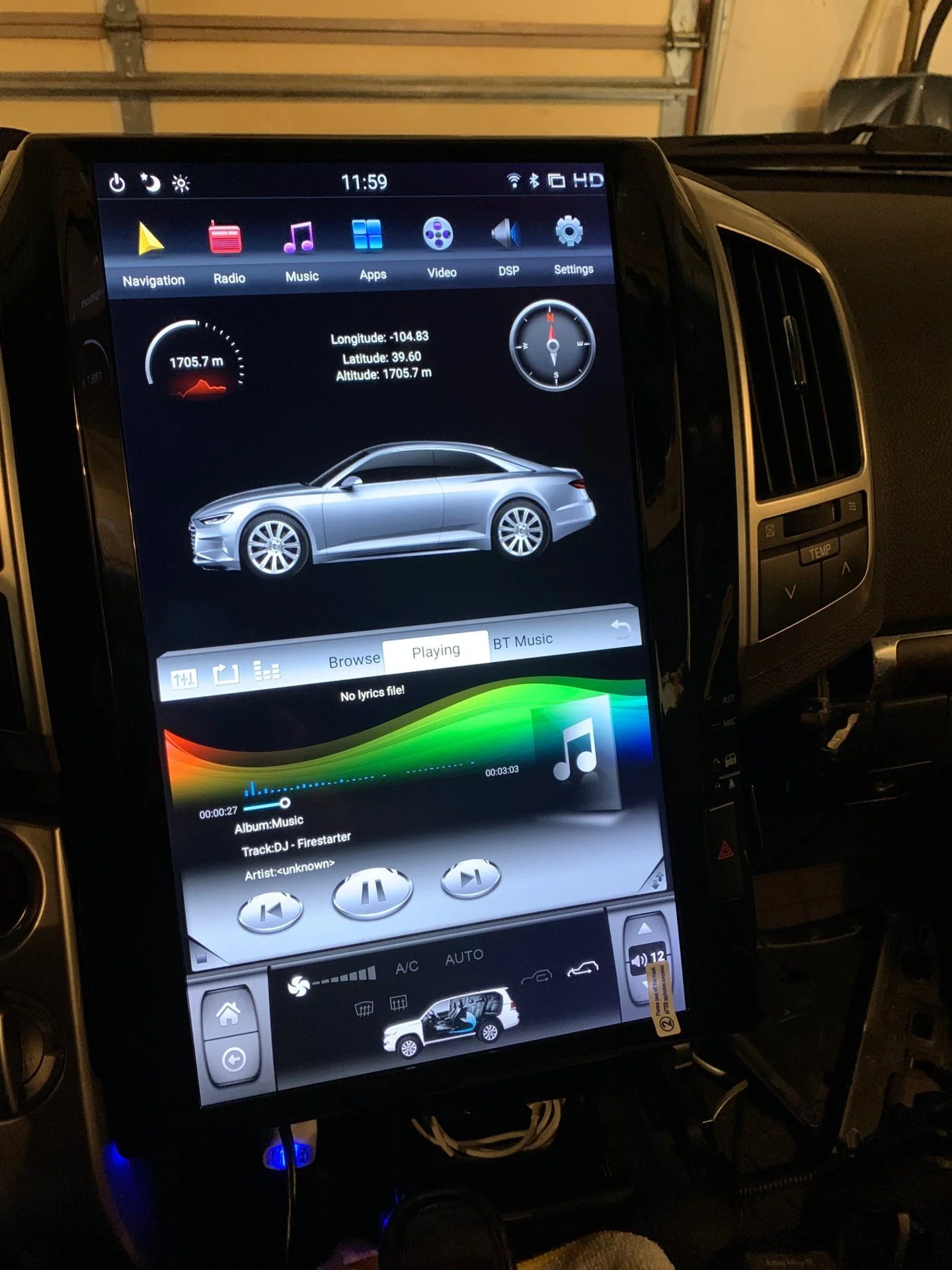

Havent figured out how to replace the Audi
AC controls all work including from the side temp up/dn buttons
Still working through setup options, but so far pretty happy with it
Looks like how to change the Audi. I will tackle this later. Have some other projects to address

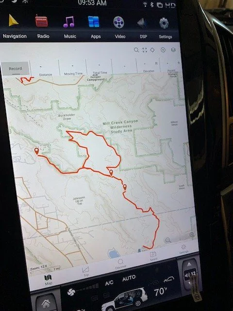

Ok, I couldnt help myself
second one is Gaia displaying one of my near Moab tracks
Noticed I have yesterdays date, will need to fix that
