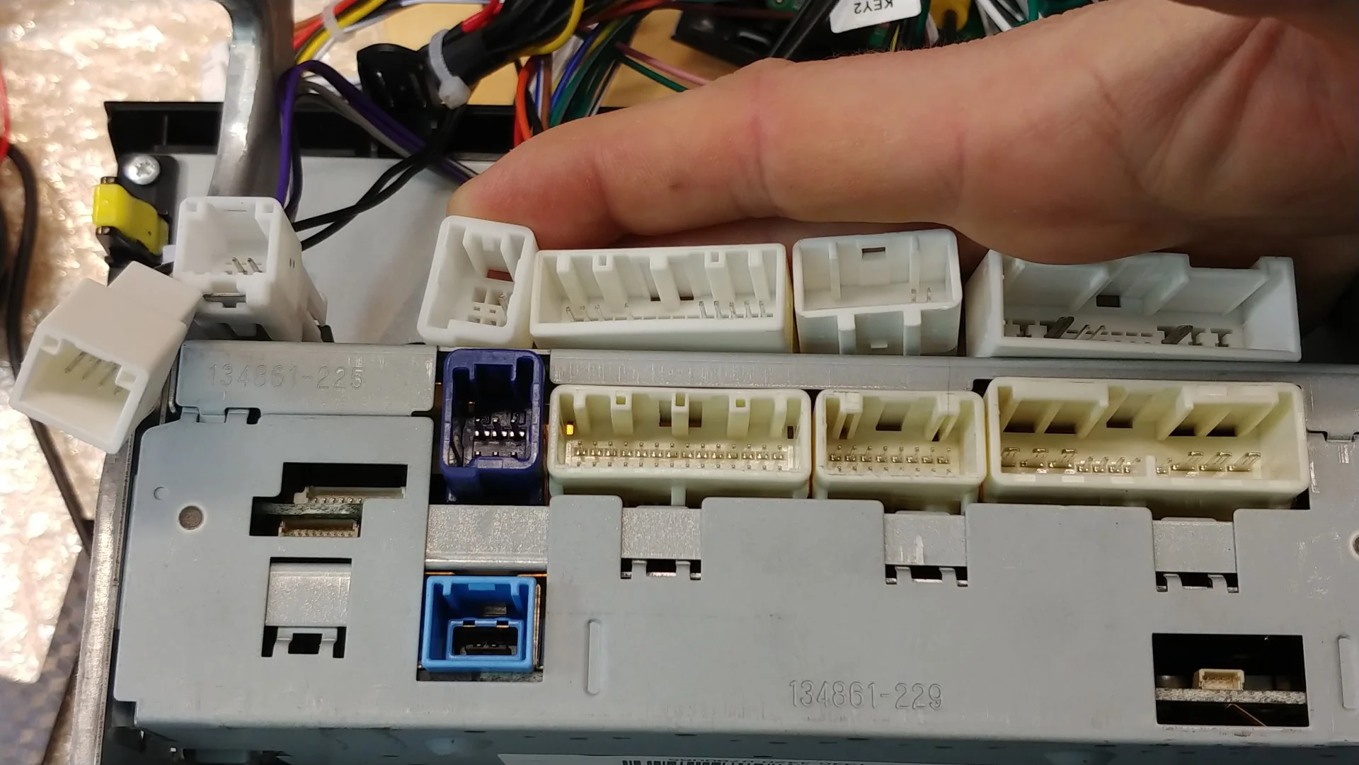

For your specific factory head unit (same as mine) this is a bit compicated, make sure you read this whole post. This was the exact same issue and very first question I had for them. They sent me this picture and told me to buy version C:
This is how the connectors on the EKIY match up to the harness on my 08 TLC (front panel looks identical to yours), same "upgraded" JBL Synthesis system:
You'll notice the only connector not present is the light blue one. I BELIEVE this is the stupid "MOST" digital audio protocol output to the factory amp (ie. how your factory amp receives audio out from the factory HU). This is effectively, for all intents and purposes a proprietary unusable (outside OEM) connection/protocol that almost nobody uses. They were on some BMW's and Volvo's and some other random crap....and Land Cruisers with JBL....go figure. I think some of the old PX6 units offered this connection as an option, but as far as I'm aware, the new 7862 HU's do not (check with suppliers to be sure).
So, given the JBL Synthesis crap, if you get the newer 7862 option, and IF it really is missing the MOST audio output connector (can anyone confirm this???), you either need to use the limited FR,FL,BR,BL,S outs on the 7862 HU to rig up all your speakers (lots of ways to do this, none are ideal), or man up, do it the right way, and get a DSP and/or amp with optical input and 8-12 channels of processed i/o + real amps. I recommend either Helix DSP Pro, Helix M12 or M8, or the one I went with (mainly because it has superior DIRAC and FIR nerdy stuff) the MiniDSP Harmony 8x12 (built in amp w/ 40wpc....you'll pull more like 70wpc out of low impedance factory speakers). The MiniDSP C-DSP 8x12 is a good option too. Basically exactly the same as the Harmony 8x12 but it's DSP only, no amp. You'll need external amps.
But if you go this route, and do it right, you'll get way higher DA sound quality, way better amplification even with cheapo amps, and can swap out the terrible "upgraded" JBL speakers for decent (or really good) speakers and tune them to sound much better. Running the JBL's by themselves they are absolutely horrible. They sound muffled to death. They're some of the worst drivers I've heard, and I've heard a lot. The terrible inherent SQ is compensated for with very heavy factory DSP EQ, which is far from ideal for a real high-end sound system.
Or you can stick with the PX6 based units, which again, I'm pretty sure offer MOST bus output, and they'll behave basically as a drop-in factory replacement. I was researching them before I decided to wait on a better alternative with coaxial or optical digital out to do it the "right way" according to me :)
You could get a PX6 unit with MOST outs to your factory HU and piggyback off the factory system for now, then upgrade to the "right way" (according to me) down the road by going digital out of your USB port via HEC into a DSP and then a "proper" (pinky finger in the air) stereo system. That might be the best of both worlds if you don't want to put the $ and effort into a full upgrade now, but you end up with an older, slower HU. Also, I'm not entirely convinced USB HEC out is all that reliable. Supposedly it works fine according to other folks, but I suspect it may be buggy or not work with all apps or system sounds...mostly just my own conjecture on that. That's a big topic for another time. Your call.
Or I could be wrong on all that and the unit as pictured actually does support MOST audio output...in which case, what the hell is that light blue connector that's missing then? Can anyone chime in on this?

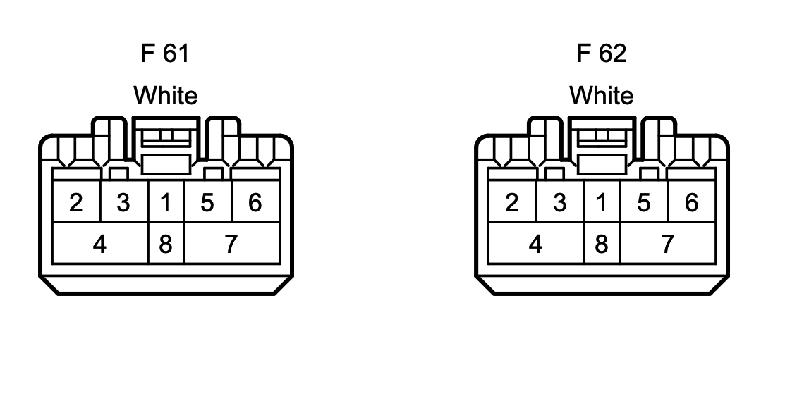

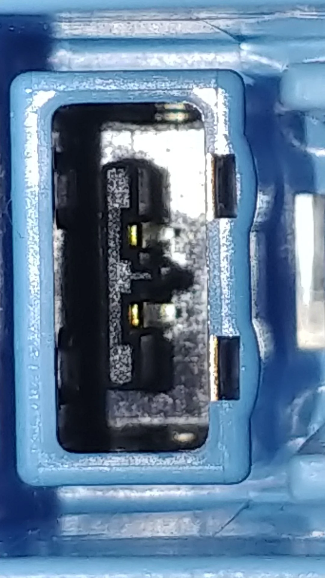

I think that blue connector is a antenna or digital out? How many pins are on it?

EXTREME CLOSEUP!!!
Just 2 pins? Again, not sure on this. It's also worth noting that many of the other connectors are missing pins, likely because the I/O is on other parts of the wiring harness (ie. video output, aux in, HVAC controls, etc.) or not used at all (connections for DVD player, stuff handled via CAN bus?). I'll double check this with EKIY after they answer a current Q I have into them re trigger wires for 360 cam.
Let’s see. F61, the head unit side of f62 has 8 pins. It seems unlikely it’s this two pin. There would be 6 empty slots. F61 probably the connector 2nd right if picture with 8 pin on Hu and 2 pin on harness. So they have declined Most as expected, and the two shield grounds

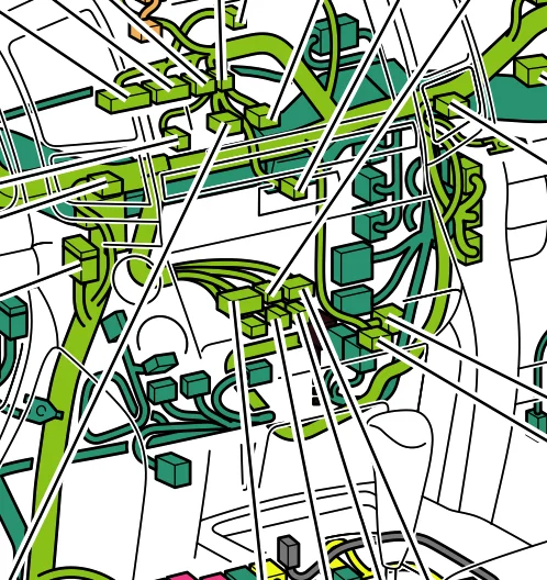

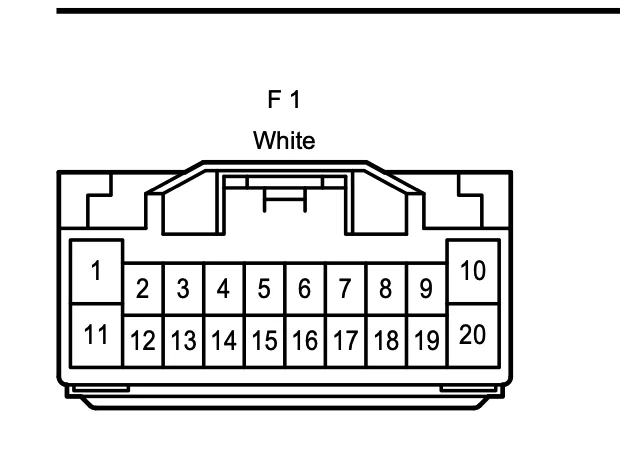

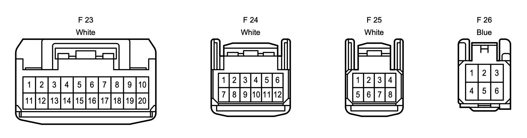

Here are the labeled items (five). Note that there are six plugs here. That sixth one never gets labeled. Frustrating! This is 2008 TLC US Model (I think).
Looks pretty different from the above pic. Maybe it's the base model.

F61 and F62. Good news, these are not part of the 08 TLC.
What are these connectors for? Are you thinking they're the MOST bus? I don't see any that look like this on my HU, but I think the JBL Synthesis HU was the only one with MOST, maybe you're looking at the FSM for the standard audio system? Didn't that use analog to the amp?

Man I can't make heads or tails of that....doesn't even look like my factory system. Maybe it's a different version (again, without the JBL system?) There are definitely 5 connectors on my deck portion, as you can see in the pics above. The two pleasing blue connectors and the 3 whites. The only 8-pin connector is the lone white one above the "deck" that goes to the facade stuff, HVAC, passenger seat light, emergency flashers, and two ground wires. 6 pins are present on both the factory system and the new Android HU, so no difference there. When I go to install this thing, I'll see if I can get it to work with the factory amp fed by MOST. I highly doubt it, but I know it could be helpful to others. Speaking of which....
