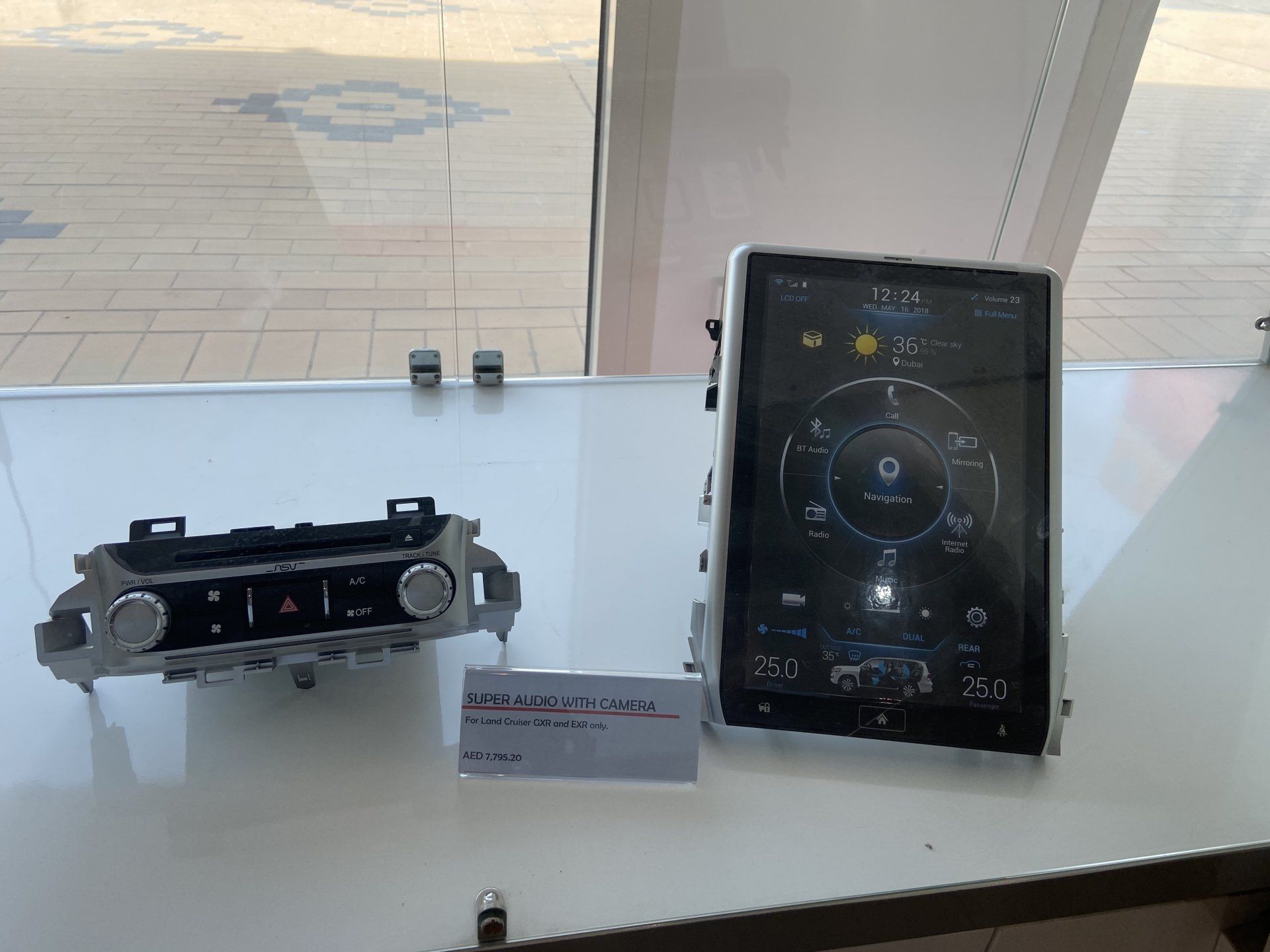

This unit is sold at the dealer in UAE. This pic is from September 2020. Price works out to about $1900 US. I can buy this and send to anyone if they'd like. My only beef is that I don't believe it works with Apple carplay, however, it does do screen mirroring.
What years will this work in?
