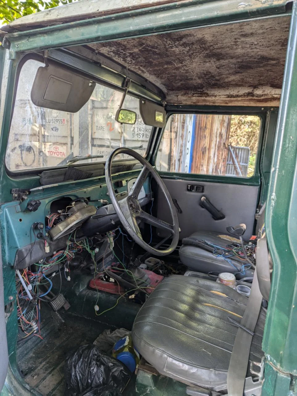

I have an opportunity to get a rust free, not running 1976 FJ40 for seemingly very good price. Photos I have are of a complete rat's nest of cables in the engine bay and inside the cabin, the dashboard hanging on wires, tons of cables hanging above the pedals. I had no idea there could be that many cables in a 40 series!

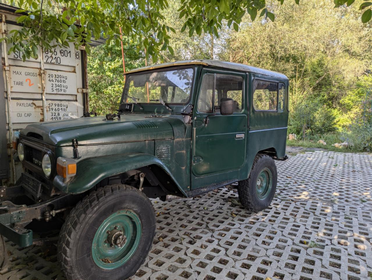

That's had what looks like a significant amount of body work. Looks like its a 79-84 year. Those are the most rust prone years. Its very likely its hiding a lot of rust.

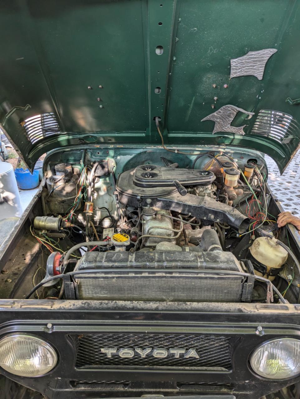

I went to see it. It has been a redneck project already. It's both bad and not too bad. No diamond plate though!
Body is not original, but a replacement. VIN is 256455, which I believe is something around 07.1977, but it has the tailgate, which appears to be earlier?
The front bumper is a MAN leaf spring lol and large part of the paint job was brushed on lol.
Roof is the worst part. The gutter is mostly gone. No cracks on the roof though, but some broken off pieces of the brim. It is not fixed to the body currently. All windows are ASAHI, which was a surprise.
Floor has been welded in, but the panel piece seems to be original. Solid metal inside & out, no rot. Similar on the passenger side. The wiring situation is bonkers. Guy self admittedly was good with engines and bad with electricity. Everything will have to go. Engine started on the spot. Considering the spiderwebs, it had not been started this year.

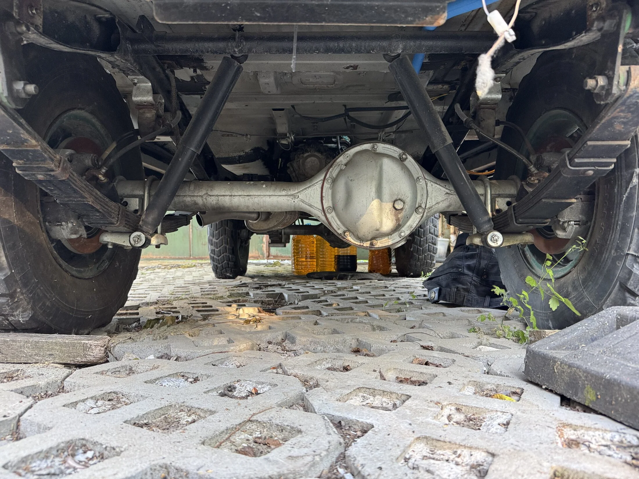

Somebody has converted it to rear disc brakes. Appears to be the original axle?

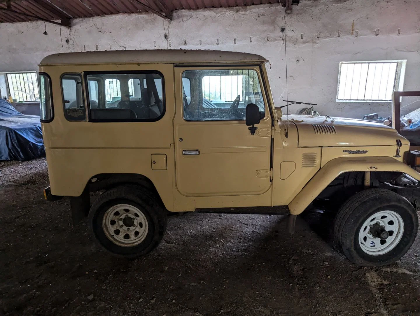

There was this BJ42 too, in much, much better shape, but for twice the price. Not considering that one. Lots of questionable things happening under parts of the paint and the floor mat.
