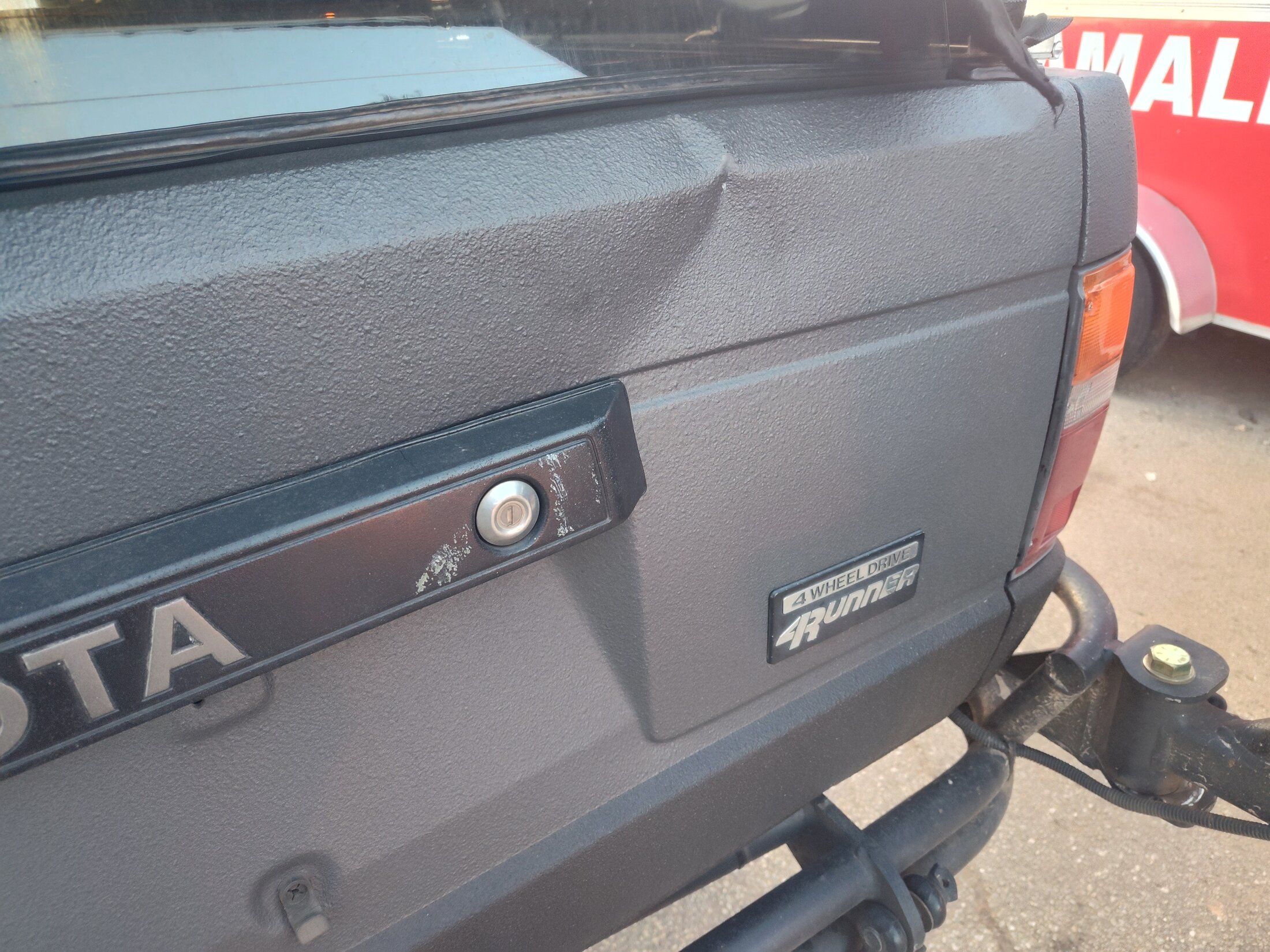

Tailgate bent in so far the window didn't function. I did bend I back out enough to roll down but she still binds a bit due to inner structure being equally pushed forward. Possibly salvageable but not without a good bit of finesse, trial and error.
The plastic bezel is cracked and a few mounting tabs broken. No longer mint. I'm sure it's unobtainable new.
The 4x4 innovations bumper was pushed into the lower portion of my tailgate as well as upper but immediately popped back out.

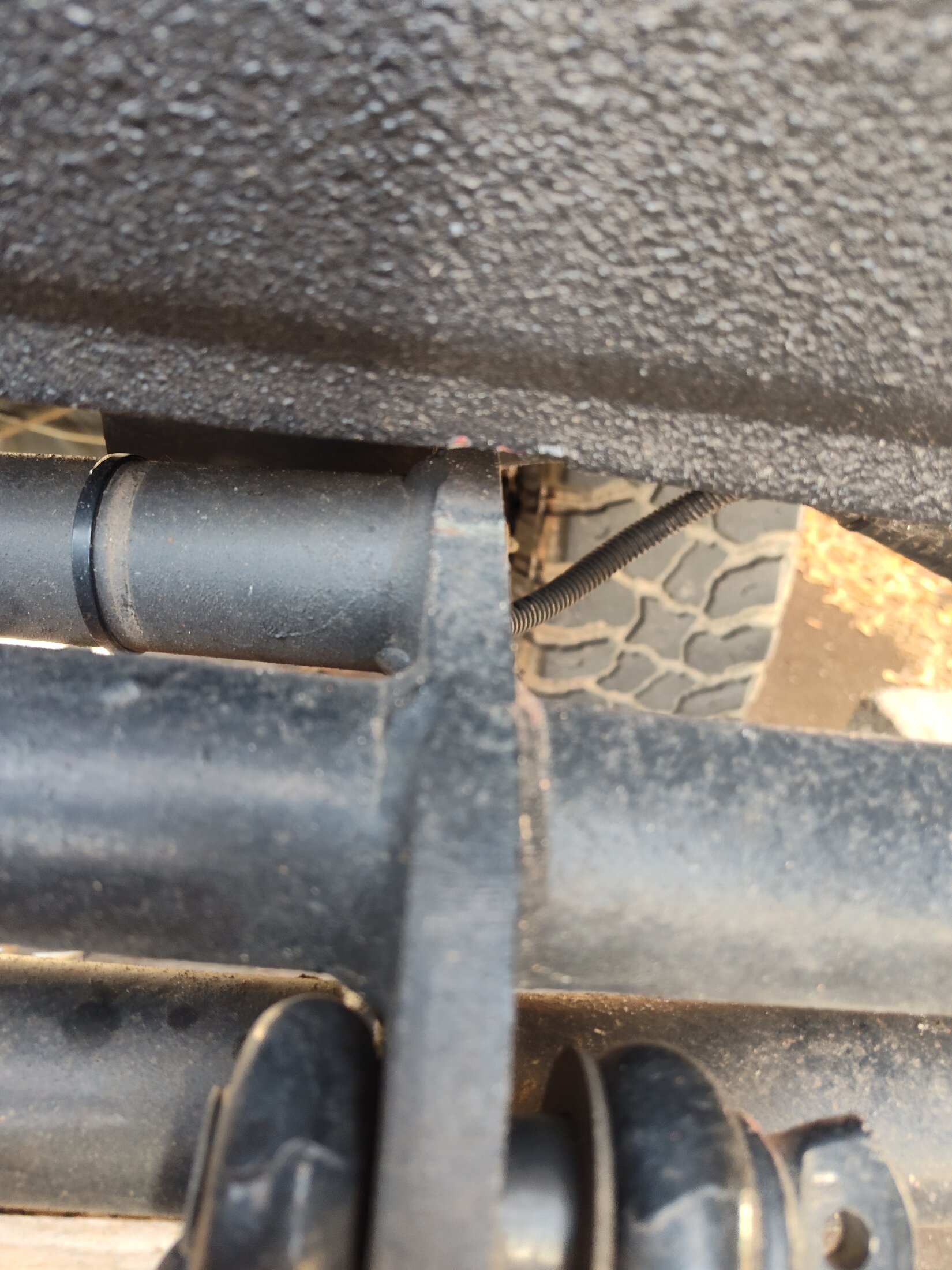

I've either got a bent tire carrier and or bend spare wheel as the tire is now making contact with one side of the tire mount support arms. The pivot mount for the swing out may be bent slightly upward. I'll need to park on level ground to verify. There's so much slightly jacked it's hard to be certain. This slides into the rear frame and bolts in so it's possible that could be tweaked slightly

I could live with the small amount of damage at the bottom of the tailgate
Other than putting this on a dual swing out set up, the tire mount has too much leverage when pushed upward/forward. I'm not sure I can make this much more protective without tying it into some sort of exocage. .which is likely needed with how bad drivers are getting these days.
a real body guy could probably save the gate.
bummer either way.
I hope her insurance feels the same way. The biggest issue is the inner sheet metal behind the bezel. It won't be easy to get in there to spot weld it back in place.
