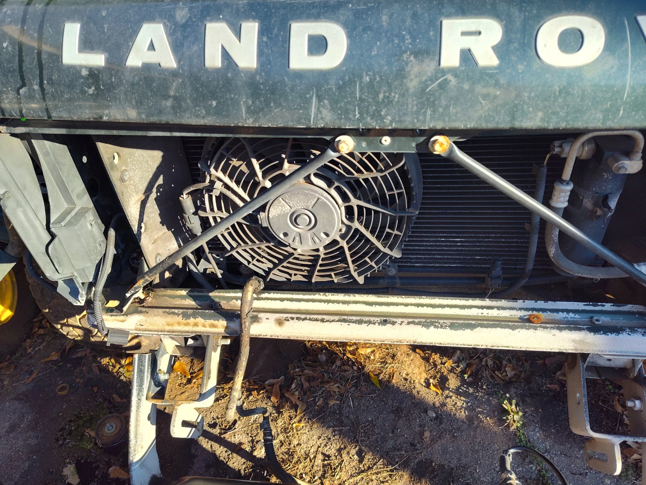

I have a pretty good assortment of aftermarket and OEM disco 2 cooling fans. These fans are much larger than the factory AC fan I had on my parts 2nd Gen 4 runner. Right now I only have a single 18 inch high flow electric fan. There's a large amount of space between the AC condenser and the fan mounted to my radiator.
Even if the AC only improves by 5 degrees it is a huge improvement.
I also need to look at my fan speed. I have no fan movement on the 1st setting. The rest of the speeds increase as you move up. I'm wondering if I don't have some CFM I'm losing out on.
I hope one day to pull up next to another first Gen and compair air flow. I don't want to rip apart the dash to find I'm missing setting one and not the highest setting.
