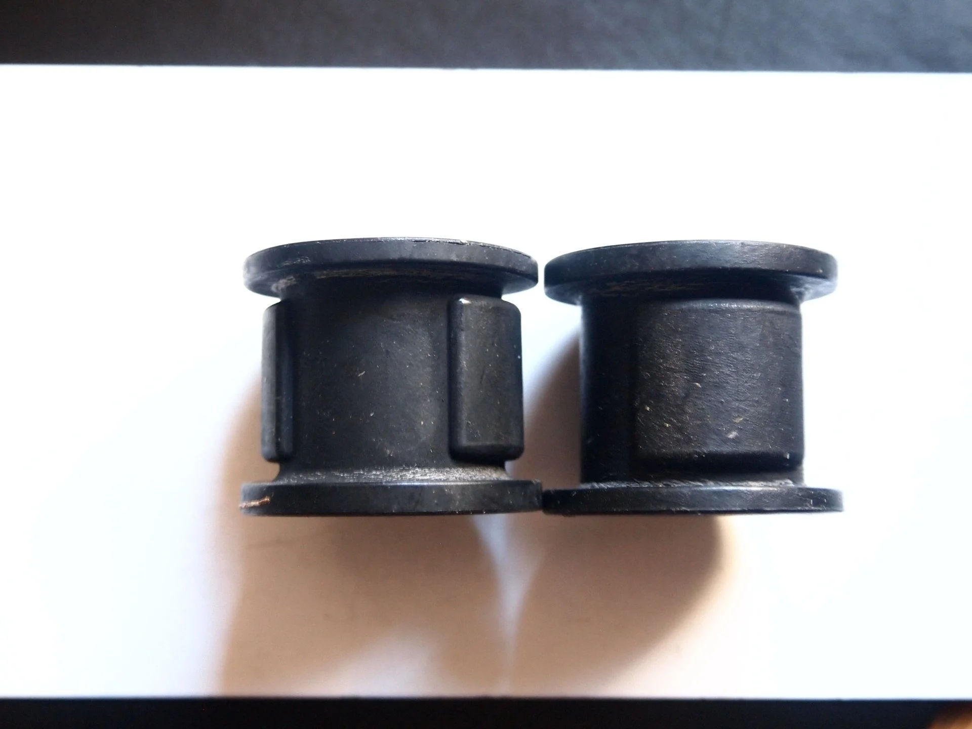

I just did a set in and 06 with rack in place. It is the first time I know of, that this was down without taking out the rack. They are a two part bushing, which isn't so tall to make difficult for the room available.
03-07 rubber OE.
The OE for 2001 is a one piece for front and rear on driver side, just like OEM. The PS is a horse shoe shape that OEM is sold by Toyota.
Most just use ploy bushing as seen in this thread. They are two part and can be installed without removing rack. The old of 98-02 racks are easy to remove and no air tool is needed. But I've not tried installing OE rubber with rack in the vehicle. I'm concerned they are too tall, but should be able to get into place and ready to pull or press in. Getting a washer and nut on that is used with the pulling bolt as tool, may be difficult. The second issue will be too get lip to pop through opposite side you pull or press from. But it is certainly worth a try, since so easy to pop out old. Just be ready to remove rack if to frustrating. If it comes to removing rack, Hit me up. I've some important tips that can save you $$.
98-02 rack OE (OEM style) One goes in rear and one in front rack mount on DS. Notice they are identical and both have one lip thin the other thicker lip.
Also notice the bump outs. On the 03-07 it very clear these go front to back. I assume but don't recall in the 98-02 is the same. So watch as you remove your old ones.
98-02 OE
