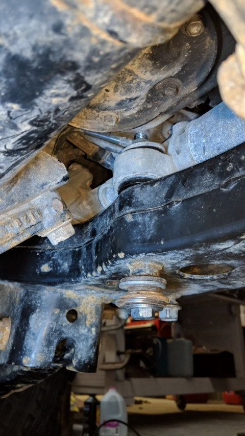

So i started hearing a faint click on the driver's side whenever i went over speed bumps on one side but not both, went to hih, heard some more clicking and since coming back it got worse, especially when bumping the drivers side with the wheel turned.
This past Friday i ended up doing the alternator brushes and while down there i saw what looked like rubber bits around the rack, basically the kind of mess an eraser makes when used. I also noticed the metal on the bushing was turned and not straight, which i recall seeing a post here about it being a telltale sign of worn bushings.
Yesterday, i had my dad turn the wheel while i looked under the truck and noticed right when you lock the wheel turning left and just as it makes the noise, the rack jerks to the side, I'll try to upload a video of it, and you can see a lot of movement in the rubber.
Now my research tells me Toyota, in their infinite wisdom, decided not to offer the bushings as a separate item.
Which brings me to my question, before i pull the trigger on a set of superpro poly bushings, is there a rubber alternative? Rack is dry, zero play, 175k on the truck.
Should i just pull the trigger? Not looking to replace the rack honestly.

Yes, I installed the bushings myself. The rear bushing below the oil pan is what will test your patience. You essentially need to put the lower 1/2 of the poly bushing in, start the sleeve, then start the upper 1/2 of the poly bushing on the sleeve then squeeze it all together.
This is how I managed to squeeze the bushing 1/2's together. A threaded rod would have been much easier, but a long bolt and a stack of washers works too.:rofl:

Very nicely accomplished! Thank you for the photo and the pointers!

so mine does move side to side when at full lock and tires on the ground, but what got my attention is that the passenger side washer wasn't straight and turned counter clockwise. so you're saying turned washer is something else?
