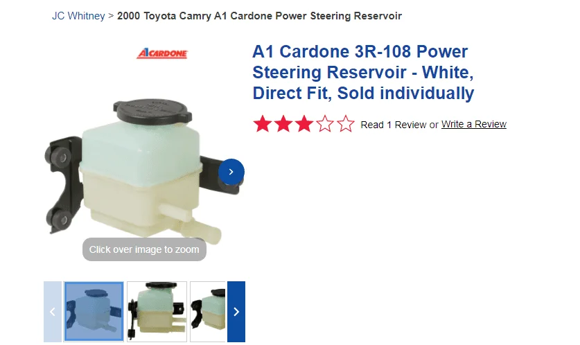

This looks something like it. It would be interesting to see if the mount at the back is in the same location as the one for 100s. It would be good if the tank could be purchased without the overhead of having to buy another bracket.
The price difference between this and the one for a 100 makes no sense. This is priced under $70.
Yeah I’ve looked at those Cardone too, seems like a good option for non-OEM item but OEM quality with a slightly lesser price. Double check the part numbers before purchasing though, the ones I found show 3R-113 to be the fit for our 100’s.
The Cardone 3R113 sells for close to $100. I might check with one of my local parts store buds about a 3R108 for a Camry to see if the tank is the same as the one for a 100. The idea is to reuse the existing 100 bracket with a new Camry tank to bring the price down in the $60 range.
