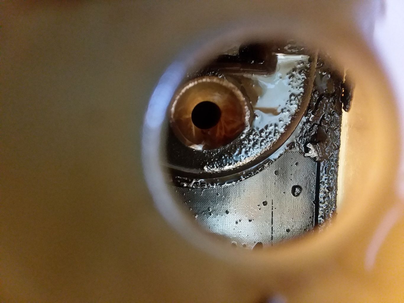

Do all years have a screen in the tank? My '00 LX has no evidence of one, though from pics here, I'm still not entirely certain where I'm looking for it. Is it horizontal across the bottom of the tank? Given that the car has had dealer PS flushes in the past, I'm wondering if they destroyed the screen somewhere along the way.
it runs horizontally. you can see it here
Oh yeah, that is totally gone in mine. Interesting. Pics are super helpful, thanks.

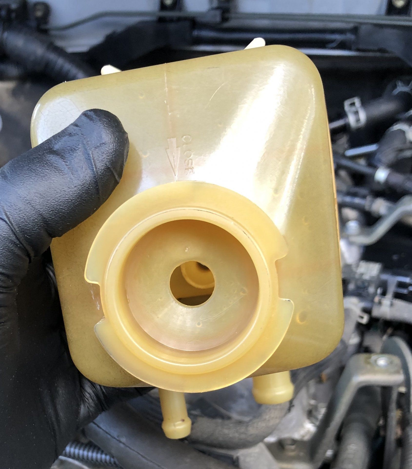

I've often wondered why the opening on the PS reservoir is so small. I have 2 or 3 other vehicles where the reservoir opening is the size of the inner diameter of the cap. Having a larger opening allows me to insert a clear flex tube into the reservoir and use a fluid extractor like MitiVac. It is also large enough to insert a 2nd tube for supplying fresh fluid. It takes some quick timing but I can fill and extract at approximately the same rate to do a quick flush from within the reservoir.

I haven't used it yet. I may take the old one and ream out the inside neck just to see how it looks. My other Toyota truck from the same period has a metal reservoir and a small filter in the bottom.
