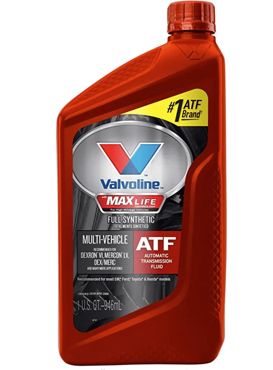

Hi, I just changed the two hoses and the reservoir of power steering one month ago, and I did a flush at the same time. After that, I put a little at-205 into the power steering reservoir. Then I believe I got a little whining noise consistently from the car start to shut down. I think maybe I got some air in the system even though I did the lock to lock bleeding process. That is the first time I did a power steering flush ever, may be I did a bad job, So do we think do flush again will help this issue? And will the AT-205 make the power steering stiff? (I strictly follow the introduction, just put a little bit about 12ml)
What fluid did you use? what year is your truck? AT-205 did not make mine whine or feel stiff. It did whine while I was bleeding air out though.
Thanks for the reply, I used Valvoline Max, my truck is 2004 LC100 Model. Should I switch back to OEM ATF? How you bleeding air out? the traditional lock to lock?
That's what I used on my 1999. To bleed air I went slowly lock to lock . I had the cap off but I don't think that should matter. It took probably 3 back and forth rotations

Same here, same fluid, same procedure. Luckily mine fired up and ran with no whining right away.

I went back and forth on fluid after changing out my hoses and reservoir yesterday. I’m trying this stuff.
Engine off for sure. Get three quarts.
