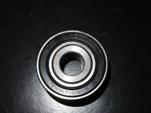

Hey guy's anyone found a good source for the bearing of the: drive belt Idler Pulley part # 16604-0F010.
The Bearing in it is a NSK BD20-15DUL:

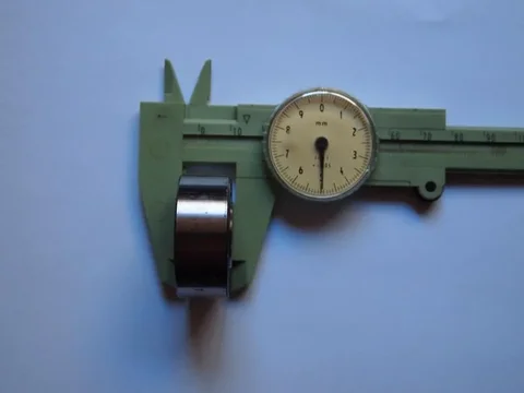

Not sure if that the one is same as I'm looking at for idler (not tensioner). I get width of 15mm (from front to back side of bearing).
Can you link me to the Club Lexus board page?
I pounded on the bearing to get out so not sure if recess on front and protrusion on rear is as new OEM would be. I actually measure 15.5mm width, with protrusion.

it's the first post. Poster notes same 12mm width for both the idler and the tensioner bearings.

6301 is a standard bearing used in thousands of applications. All the 'name' bearing companies make them, but the Japanese bearings are generally just as good [or better].
I contacted the place that makes the actual bearing a few months ago and found out it costs about $45 for the actual replacement. The bearing listed on the clublexus website is not the same as it is a single row of ball bearings and the stock one is two rows of ball bearings. There is actually a bushing in the center of the stock one you would have to press out and into the new one if you went with the actual replacement part.
The similarly sized single row bearing listed on the clublexus website is not as wide as the factory bearing.
Here's the double row I'm talking about. You can see where I broke out the plastic spacers on one side of the shielded ball bearings allows you to see the second row of ball bearings. Mine was screaming when I replaced the entire pulley with bearing included.
The bearing may be the same, but the high temp grease is what you want there. When it is an automotive application, it has high temp grease there by default. Generic bearing has a generic grease..
