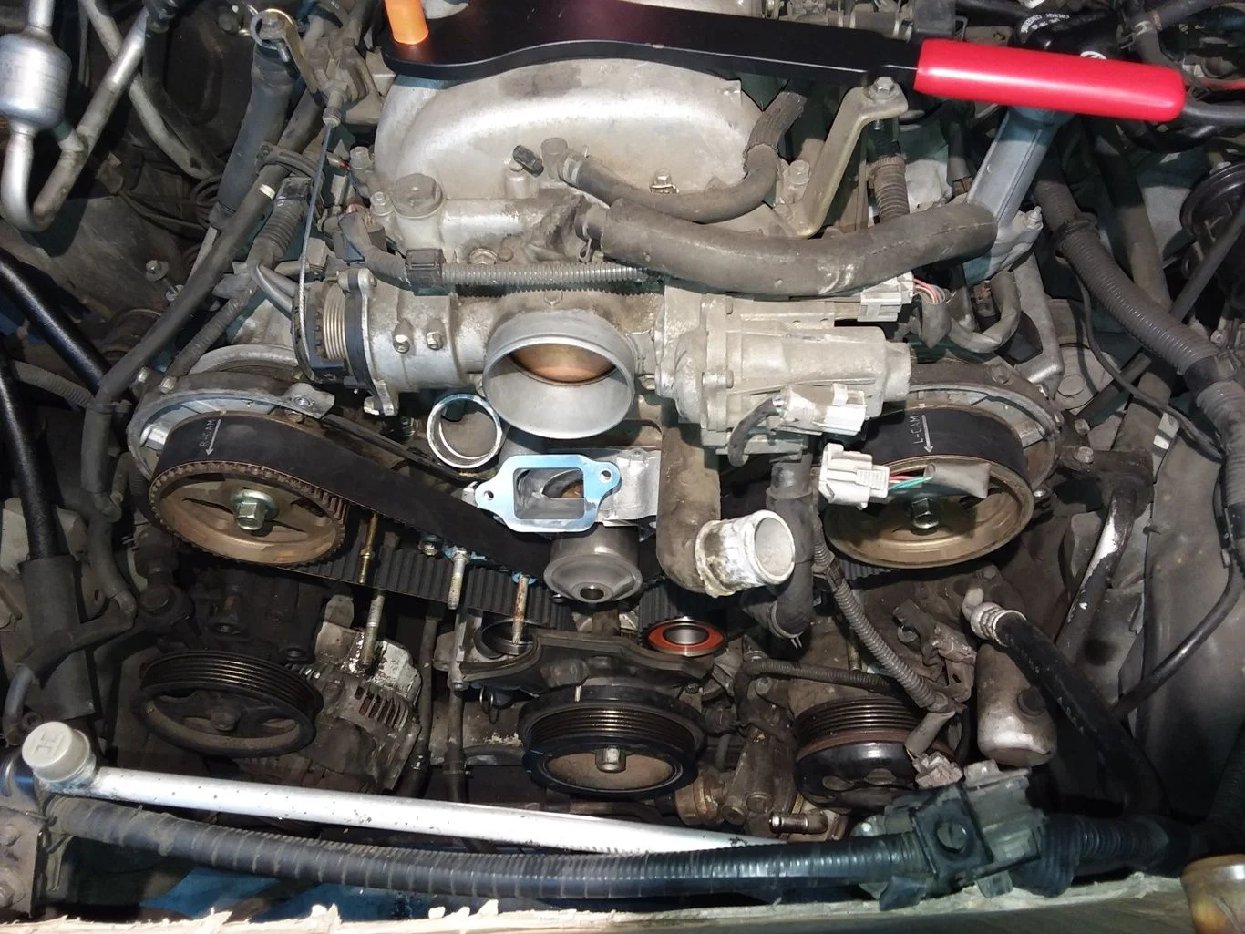

within a couple months of ownership the timing belt broke stranding my wife on the road. i unexpectedly had to do a timing belt swap. this thread documents that process including some great info from other mud members that helped immensely.
here's a random picture from that saga.
btw it's a great idea to replace your alternator brushes at the time of a timing belt swap. you're in there already and brushes are cheap, saving hours of labor to do it for its own sake. i show some of that in that thread.
i watched otramm's video on how to do the timing belt. and used his video on the 80 series alternator to do my brushes.

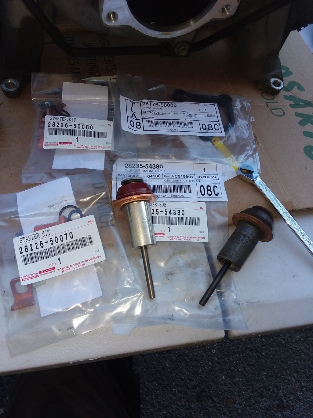

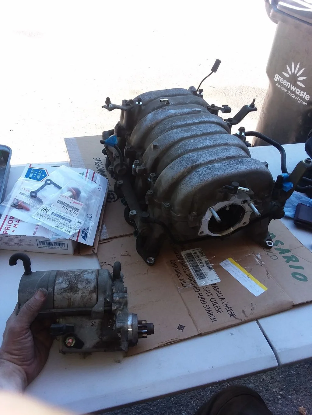

then it started exhibiting signs of a starter going bad. i read here on mud that it's probably just the starter contacts. i ordered a set of contacts and plunger to have on hand. the issue got more frequent until i had to leave work early one day to rescue the :princess: again when it wouldn't start with multiple attempts.
i decided to make that the weekend project. i tore into it, documenting all the disconnected hoses and belts with pictures, labeled tape and plastic baggies. got into the starter and even replaced the contacts but noticed before i put it back in that the bearing had grenaded. i toyed with replacing the bearing and even got it open to remove it but decided to just replace the whole starter with a denso from napa. i could get it the next day and it was only 200 or so. i kept the old one to rebuild. i found the bearing number and it's only another 20 bucks at most to fix but i have to order the bearing.
here's my thread on the starter. its got the bearing number in there. I'll post a picture of the contact part numbers and the special tool you need to take apart the starter which is mentioned in the other thread.

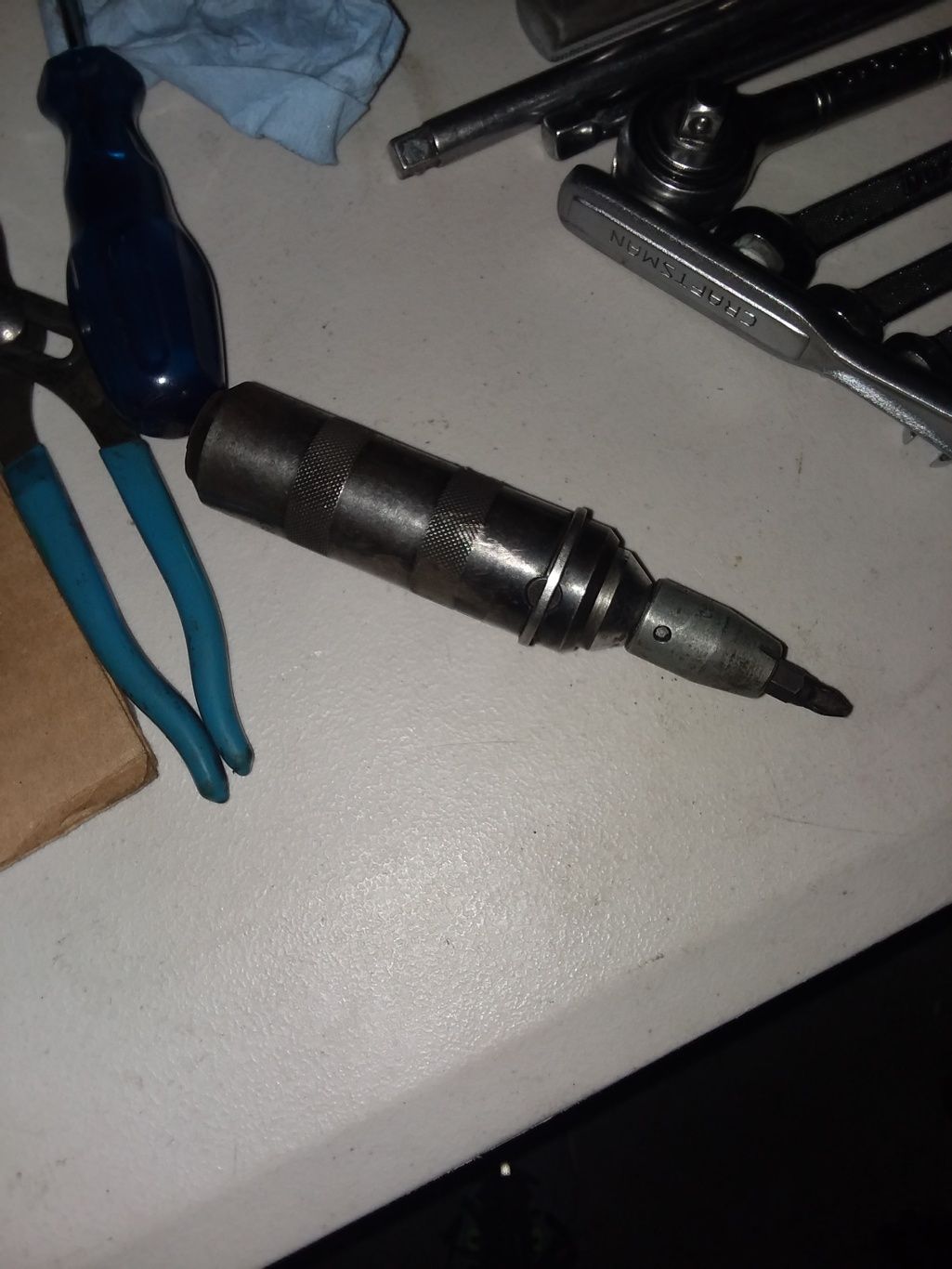

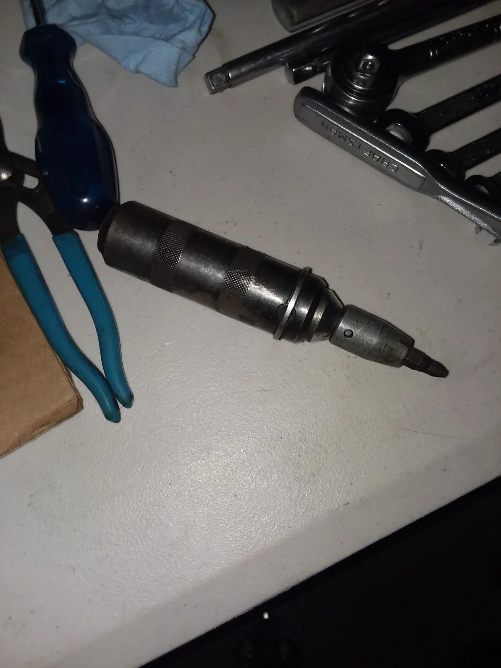

impact driver tool to take apart starter. only need if you are replacing bearings. basically you hit it with a hammer to turn the Phillips headed bolts without stripping them. i think they're used commonly on old Hondas for rotors.

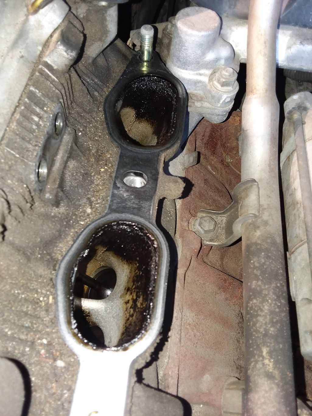

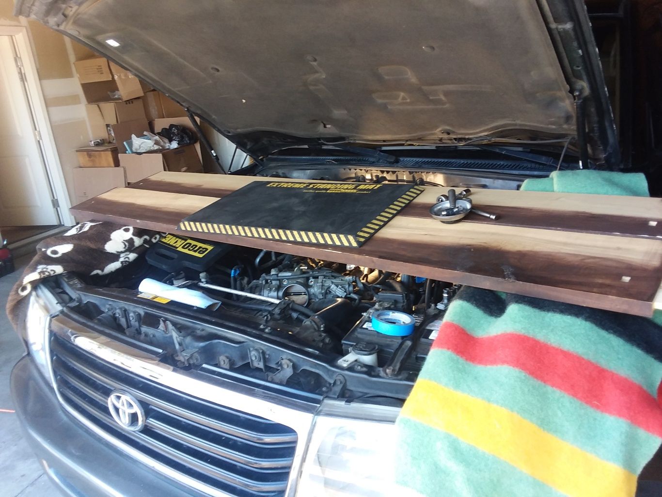

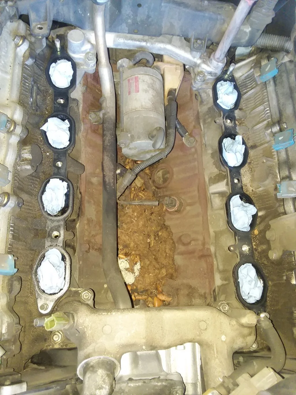

be sure to cover the intake holes in the heads to keep debris from falling in.
i tried to clean these as best i could. if anyone knows a great way to clean the intake, let me know.

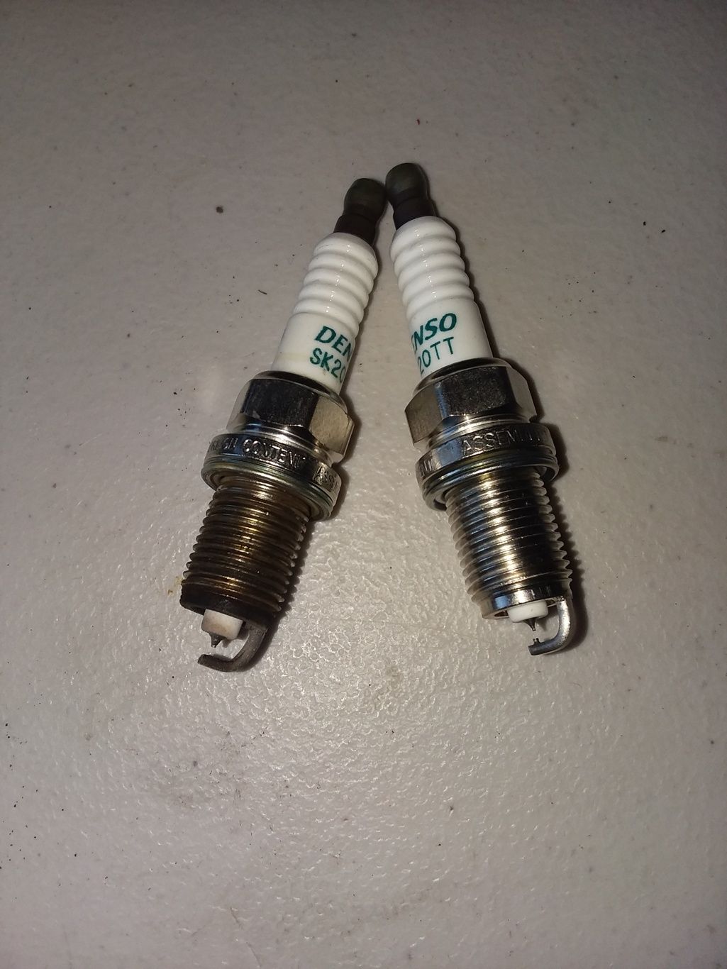

you may as well change spark plugs while they're easy to change. more baselining done! :bounce:

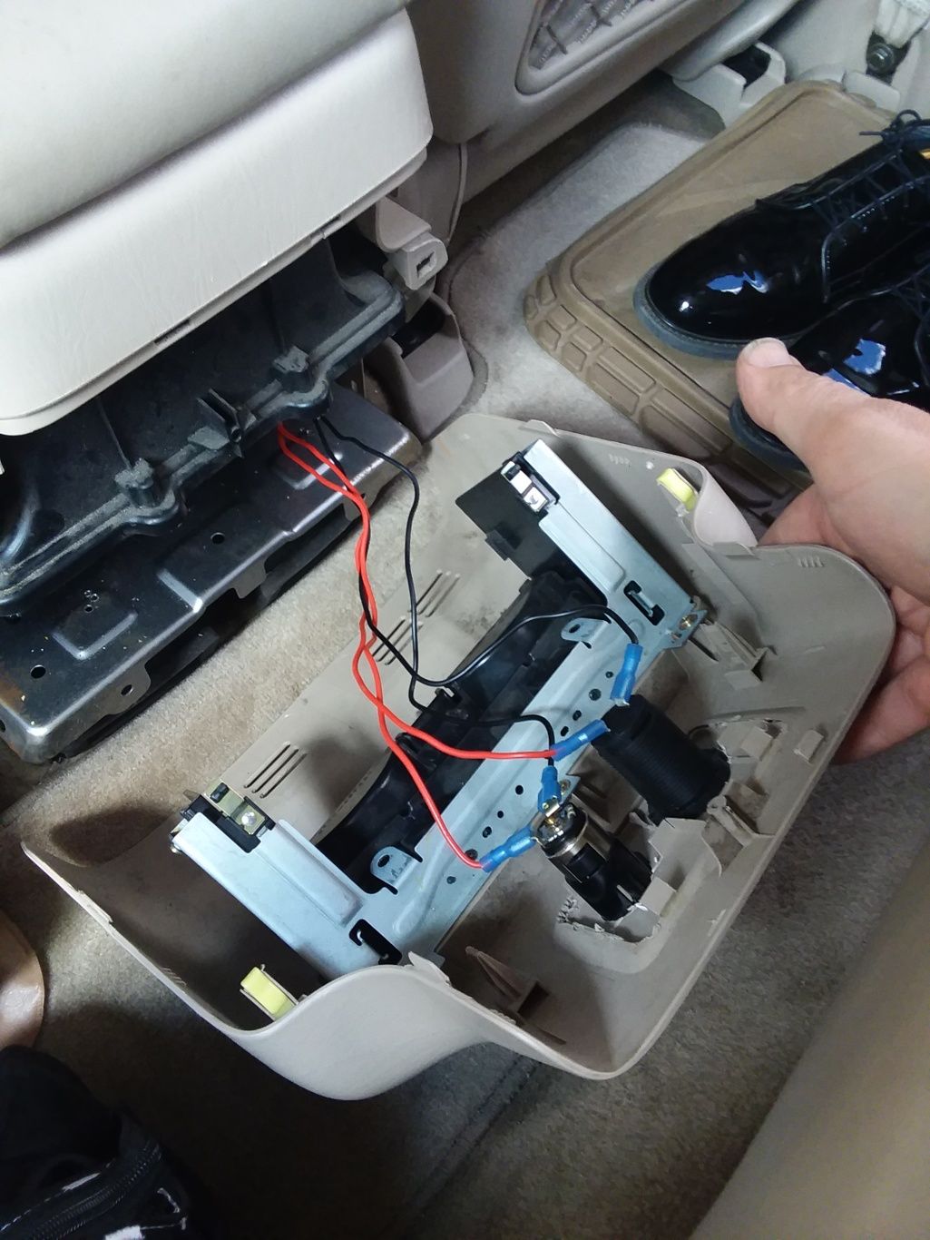

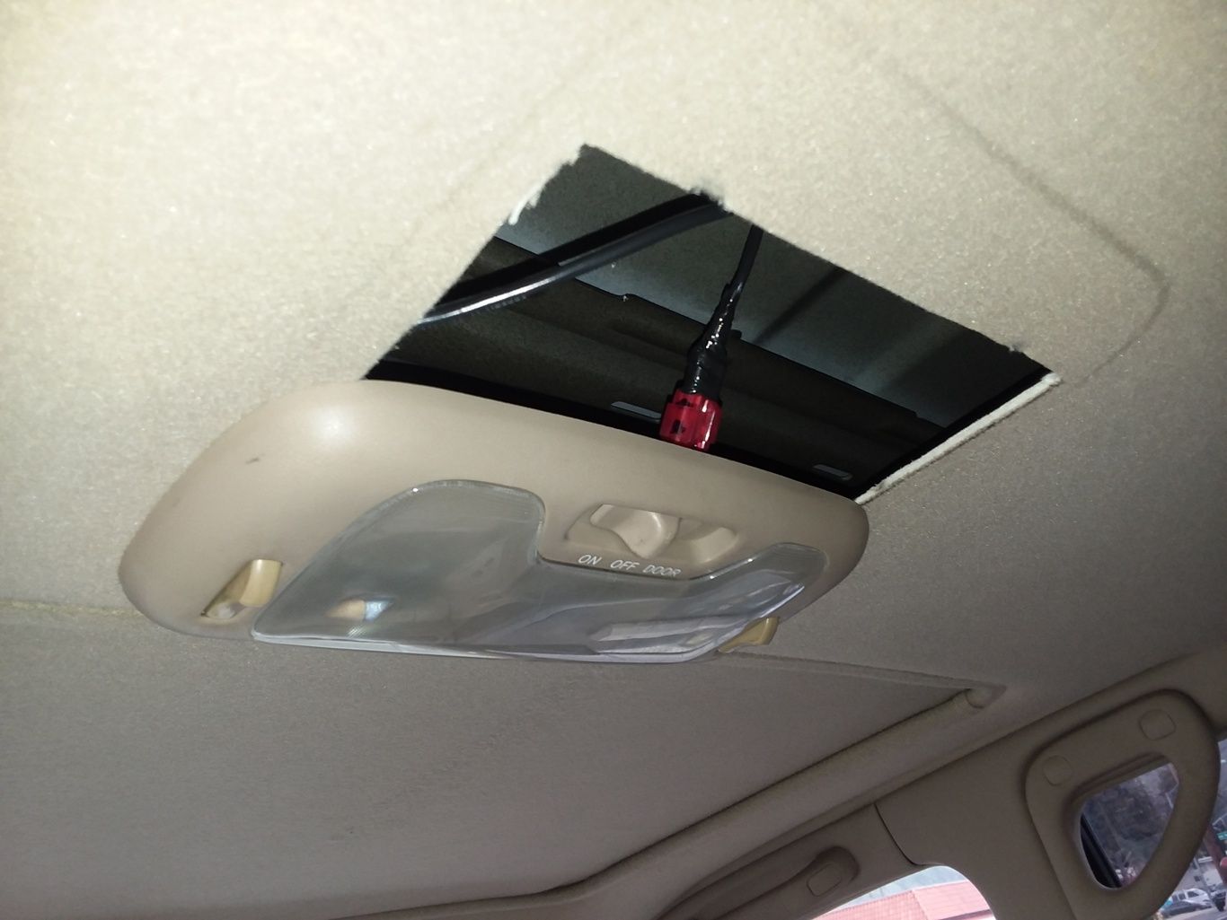

the second thread deals with the VCR dealer installed back in 2000. I restored the cup holders and dome light but am still seeking a solution on filing the gap created by the lcd screen that was installed.

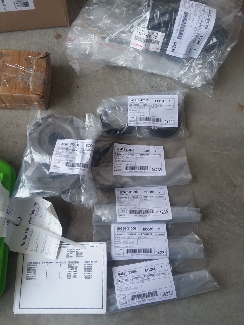

so thanks to the time off work i spent all day researching part numbers and tools i needed. between AutoZone for brake pads and rotors, rockauto for timken wheel bearings and seals and my local dealership for the snap rings and gaskets and other related parts, i ordered everything i needed to completely overhaul the hubs and CVs. i also bought a 55mm hub socket from napa though the hub nut is 54mm. it should work and some retailers even sell it as a 55/54mm.
here's the parts i ordered with part numbers

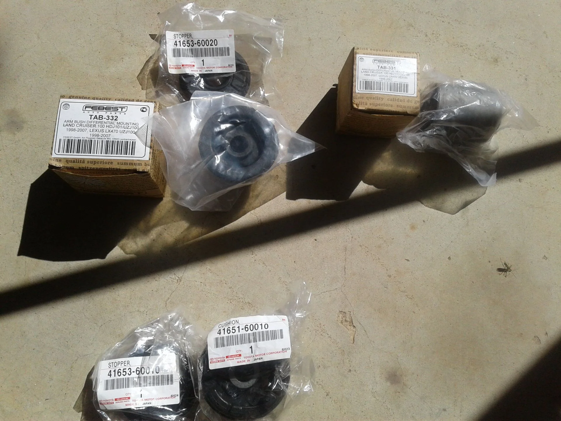

Began chasing down my driveline clunk. Dropped skids and took a video of the diff bushings.
Take a look. I know the bushing in the first shot is completely shot. The front bushing is the only thing limiting movement. The rear bushing is probably also shot but I forgot to check.
Checkout the axle movement. That's what concerns me. Not sure if it's diff backlash, the rotation of the diff due to bushings or play in the hub flange with splines. Or maybe all three?
Just change all three bushings. The first one shown can be pressed in to the old arm but that and the rear are easiest to just buy a new arm with bushing pressed in. The front most isn't too difficult, just make sure you put antiseize on the new metal sleeve and it gets pressed in straight. I rented a ball joint press from AutoZone that worked perfectly. Just follow this thread... 1 banana job. Basically eliminated my clunk along with greasing the drjveshafts. One last thing, Fly Navy!
