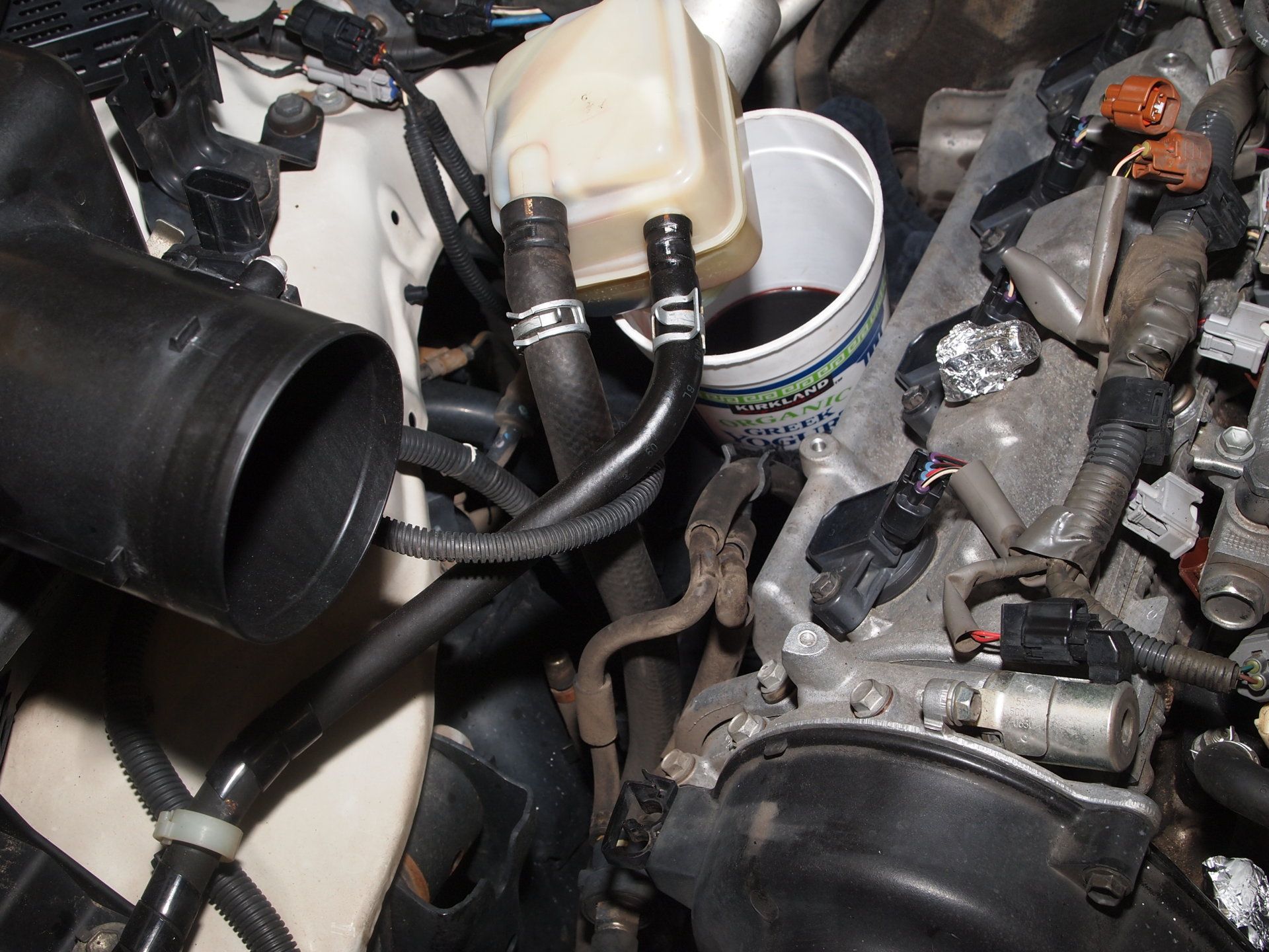

Go back to post #1 and review plus here's some additional notes:
  • I loosen the hoses by moving clamp(s) down the hoses out of the way.
  • I twist hose(s) with a pair of channel-locks to break loose from male nipples hoses are clamped on. Don't squeeze to hard.
  • Reservoir just lifts up once metal keep at back side of metal brackets is bend out a little.
  • I then dump out fluid into a catch can.
  • I carefully pull/twist and pry off hoses. Be careful don't not put excessive force on reservoir nipples or they will break off or you'll crack reservoir
  • Then clean reservoir with degreases and hot soapy water. Then dry completely before installing..
Once hoses loosened and reservoir freed up just pour out the fluid.

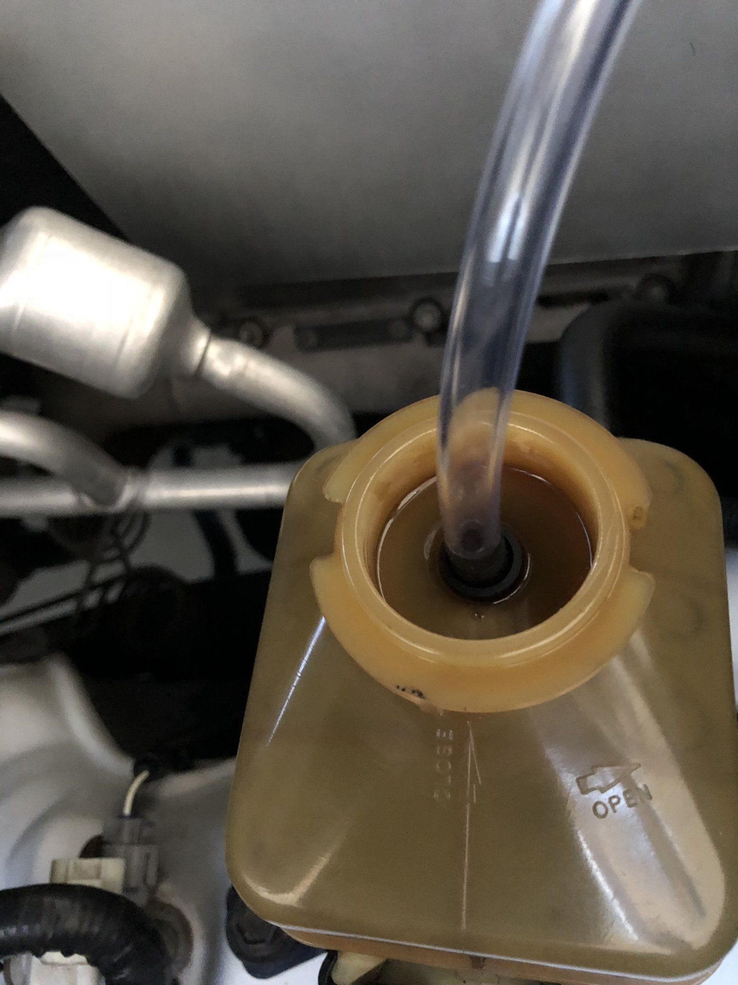

X2 to 2001LC. Got a new steering rack installed by an independent shop but then my reservoir/hose started to leak. I thought a simple new clamps would do the job but after taking out the fluid from reservoir, the inside screen had so much gunk, I ended up spending a good hour scraping, cleaning, flushing out the inside. I ended up using a simple vacuum tool to bleed my system. It was also nice to check if pressure was holding or if I still had a leak. Anyway, productive weekend, appreciate everyone's info on this post.
