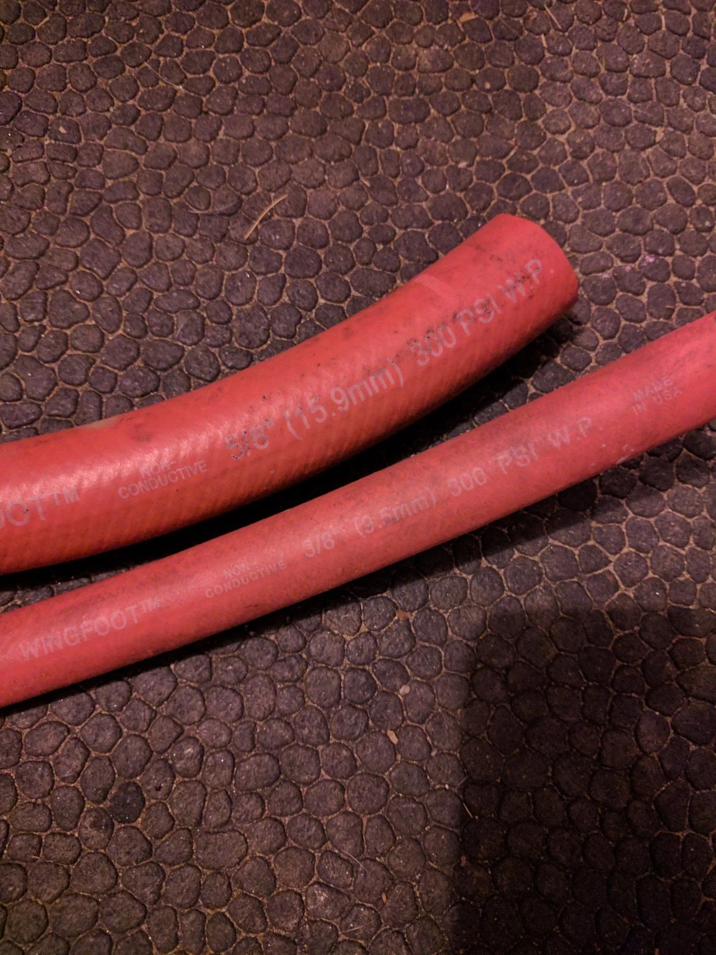

WOW, the OEM hoses were near 100 bucks? CRAZY!
