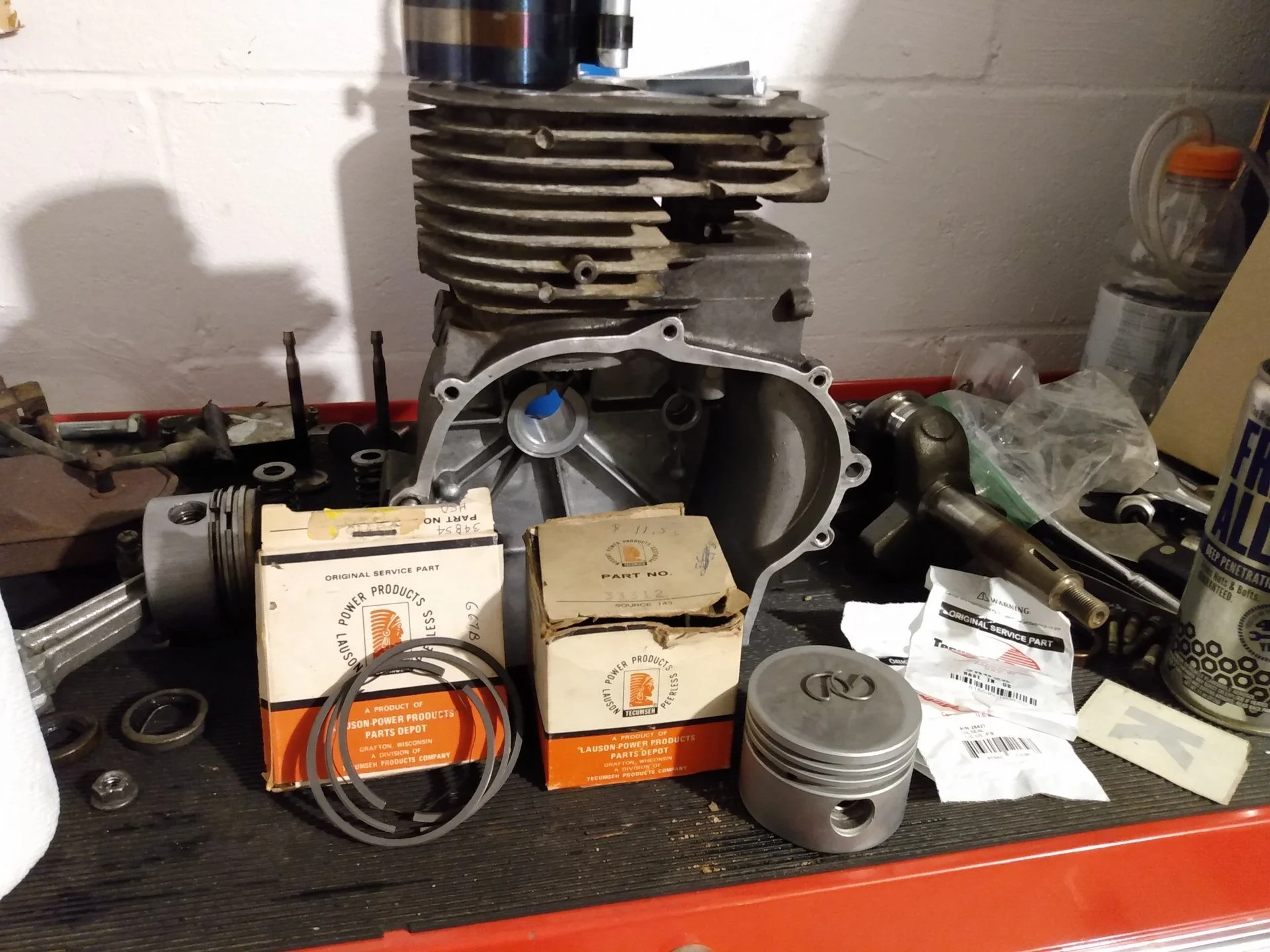

I got a broken head bolt on my Tecumseh H60 rebuild project. The 2 nut trick isn't working. The only 2 SAE 1/2 inch nuts I had are smooth and regardless of how tight I get them when I turn the bottom nut the top nut turns too. Was going to try some heat. I assume I heat the broken bolt but wouldn't that make it bigger? Or am I missing the point of heating the bolt?
Depends on how you heat. it I like to weld a nut onto the broken stud then use a wrench and it should come right out.
You are really just trying to break the bond that is holding the stud in.

IMHO, The heat expansion breaks the bond and after the bolt/stud cools and contracts it should come free with some old-fashioned persuasion and some Kroil.
I ended up welding a nut to it. First time using my new welder! :bounce:
