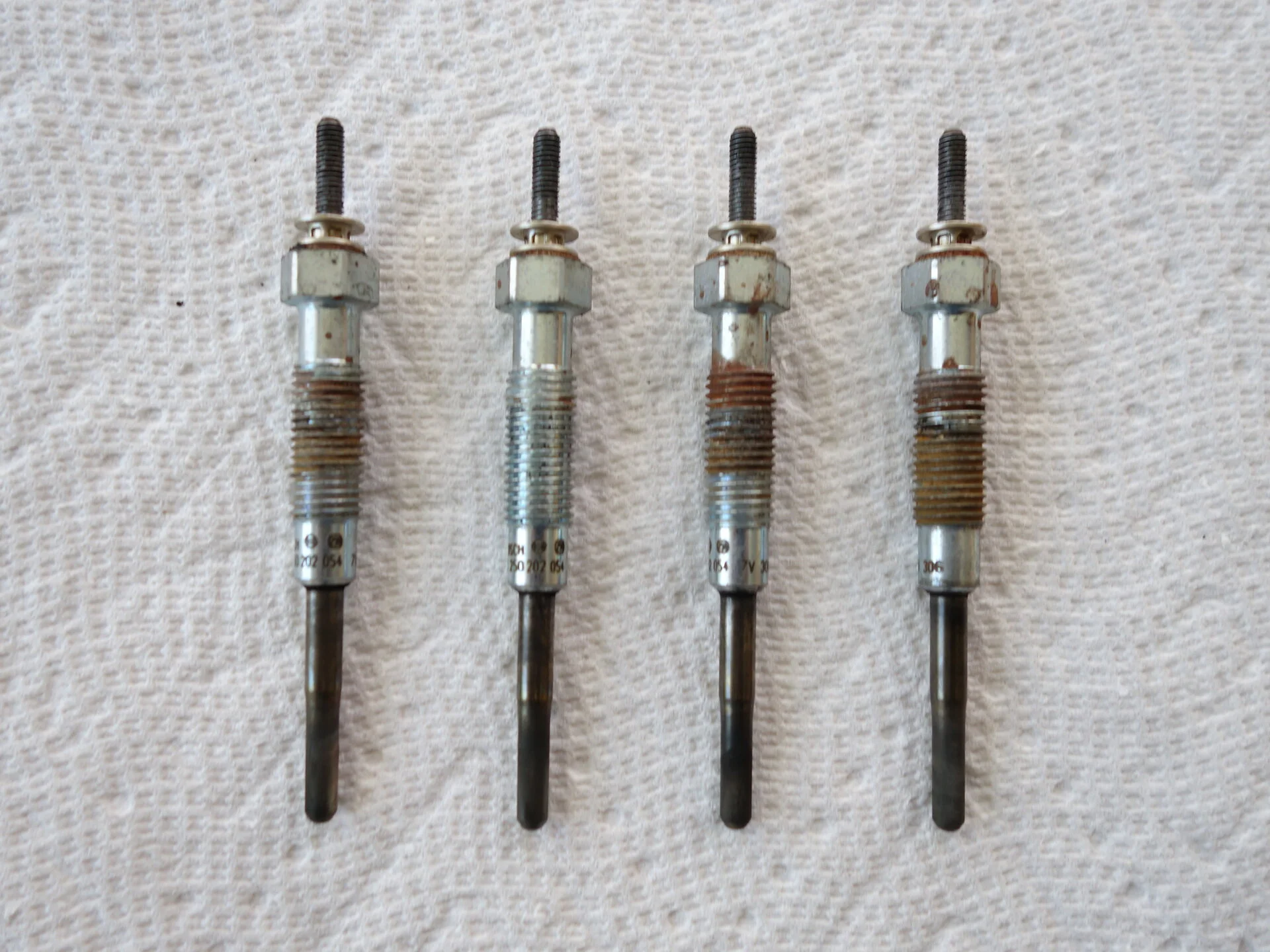

There's not really a set resistance to test. The service manual just says to test for continuity. I also hook up a booster pack to the plug and see if/how long it takes to get red hot.
Continuity is good on all 4. Main still kicks off after 1 sec and then 4.6v on the bus.
