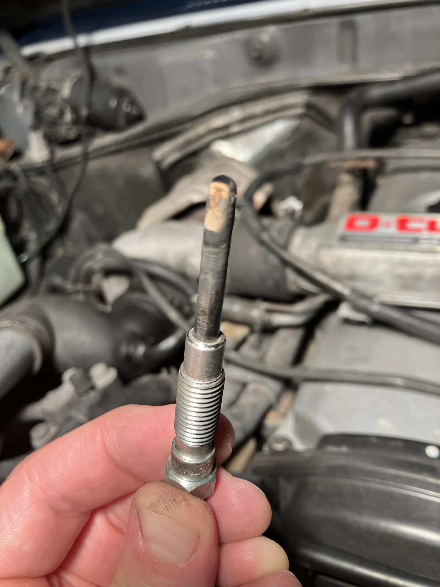

New Toyota plugs and surprisingly no real change with the cold weather start. It does fire quicker when in heated garage. Old plugs were pretty bad, one in particular.

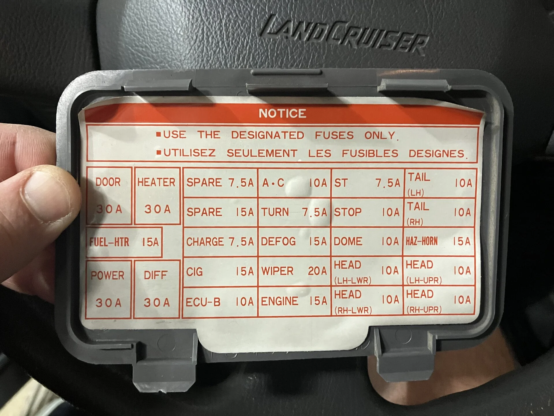

It referenced checking fuses and when I did I noticed a missing Ecu-b 10 amp fuse. Found a blown 10a fuse in the console. No clue if this is related. Will replace and see but chasing electronic bugs is beyond my skill set. Might be time to take to tech.
That glow plug looks absolutely fine.
